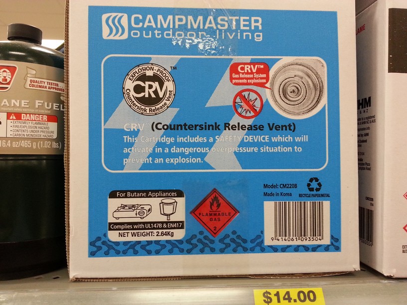

Was just in Big W and they had a big row of the 220gm gas canisters for the small cookers which are labelled as being safe to use with cookers etc and comply with the relevant regulations.
I wonder if this means we can come out of the shadows and start cooking with gas again?
I thought it was the cooker at fault and not the canisters.
The double cookers are ok and use the same canisters as the single.
I've still got mine, will use it when I need to but not in the van.
01:48 PM Apr 2, 2015
This looks like the box I bought from Big W last year, either 12 or 16 in the box. If so I already have them. A great buy.
hako said
02:34 PM Apr 2, 2015
Wasn't it the canisters that were exploding?.....going by the label these are safe to use. Monkey see, monkey do.
DeBe said
03:42 PM Apr 2, 2015
The main problem was people putting oversize pots etc on the stoves, & this over heated the gas canister. Or not putting the trivet up the right way when using. People not reading the instructions that come with the stove. So I gues its easier to just ban the sale of them.
03:47 PM Apr 2, 2015
They've only banned the single cooker. All canisters are still in the shops, I've just been for a walk around some.
The problem lies as others have said in not using the single cooker properly causing the canisters to explode.
The double cookers are ok as bigger allowing larger pan on without covering the canister area.

Main problem, as has been said, is too large a pot, forcing the flame/heat across to the canister which has been exploding.
Those canisters are only a glorified beer can under pressure, with no relief valve. So they explode when over heated.
Choice Online has an article on them also in this months news letter, based on NSW and SA banning them. choice.com.au March news letter.
Australia has safety standards for stuff like this, but too many company's are bringing in non compliant cheap imports from overseas, and of course we buy them because they are cheap, and even so they may be OK but pays to read the directions. If possible buy something that quotes Aust Standards on the stickers.
Our Gasmate is on the hit list too, so we are thinking we'll replace it with a compliant low pressure stove with a regulator that runs off a portable (Primus) gas cylinder.
Needs about a 2 metre hose so the gas bottle sits on the ground and the cooker on the table. (Outside only!)

According to the link below for ABC News item, the way I read this issue is that the cookers were banned from sale Australia wide early February ....... correct me if I am wrong. We still have our single and double cooker and will continue to use them with care. I wonder how long before those camping in van parks will see signs up "Lunchbox Cookers are not to be used in this facility"!

I thought it was the cooker at fault and not the canisters. The double cookers are ok and use the same canisters as the single. I've still got mine, will use it when I need to but not in the van.
the cooker is at fault as it can heat up the canister when not used correctly
those CRV canister's have vents in the top of the can which release the pressure from the canister, to prevent an explosion
the escaping gas will catch on fire , so you have a fire instead of an explosion
there are some double cookers on the list not to use

While some have been withdrawn from sale
This is the only one, As far asI am aware, that an official RECALL has been made
Sitro Group AustraliaTwin Portable Butane Cooker
PRA number: 2015/14630 Date published: 1st April 2015
Product information
Product description
Twin burner portable butane cooker
Identifying features
Gasmate PC2075, PC2080, BuyRight MPC2070 with a date of manufacture (DOM) 48/13. The product has been available for sale from the 1 April 2014 to 1 March 2015.
What are the defects?
The overpressure safety device may not shut off gas to the burner if the butane cartridge canister is overheated. In addition, the risk of overheating increases if the product is not used according the manufacturer's specifications.
What are the hazards?
If the defect occurs, there is risk of explosion and fire.

Consumers should stop using the product immediately. A replacement unit is currently being tested and finalised and will be ready in short order. Consumers can register to receive a replacement unit or they can contact Sitro Group Australia to discuss an alternative remedy. For further information, please call the Sitro Customer Service Line on 1300 174 876 or email: productsafety@sitro.com.au.

It indicates what the problem is & it is not the gas cannisters[it is the over pressure flame shut of valve not functioning as required

! The automatic over pressure gas shut of valve ,which should prevent the gas cylinders from overheating & exploding!

I visited a local BigW & picked up a box of these meaning to replace all the old ones.
Had just about finished replacing the cans in the cookers & the spares kept in their cases (I have 2x single & 1 x double burner cookers ), when I had a look at a couple of spare packages of 'old' cans. Guess what? All but 6 of my 'old' cans had the venting device fitted/built in.
So now I have lots of spares. Which is OK too. I'll wait to see if my Ubute attracts a recall notice. I can replace the others over time as conforming ones come on the market at the right price.
Yes I know all about the missing/defective device on the cooker & the (still) risk of fire even with these vented cans.
