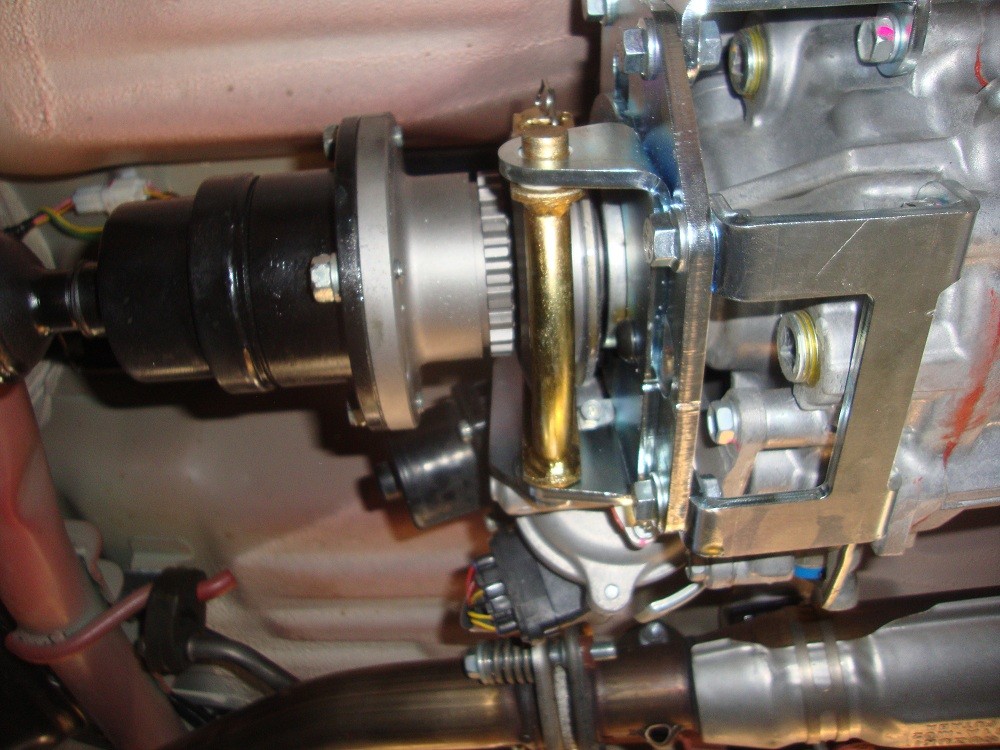

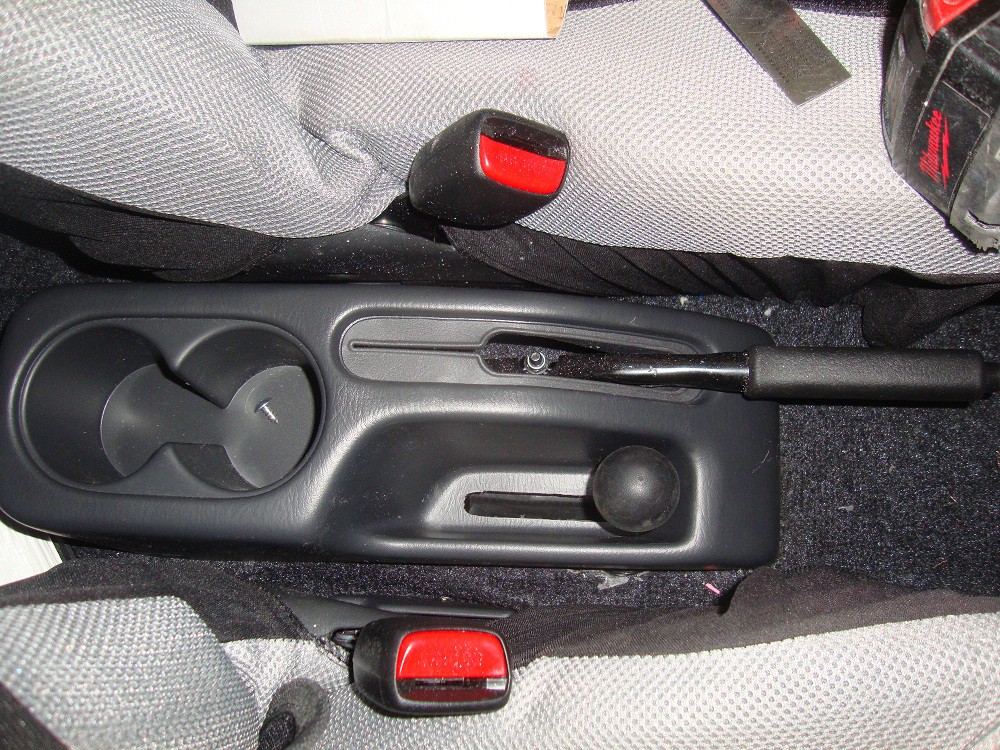

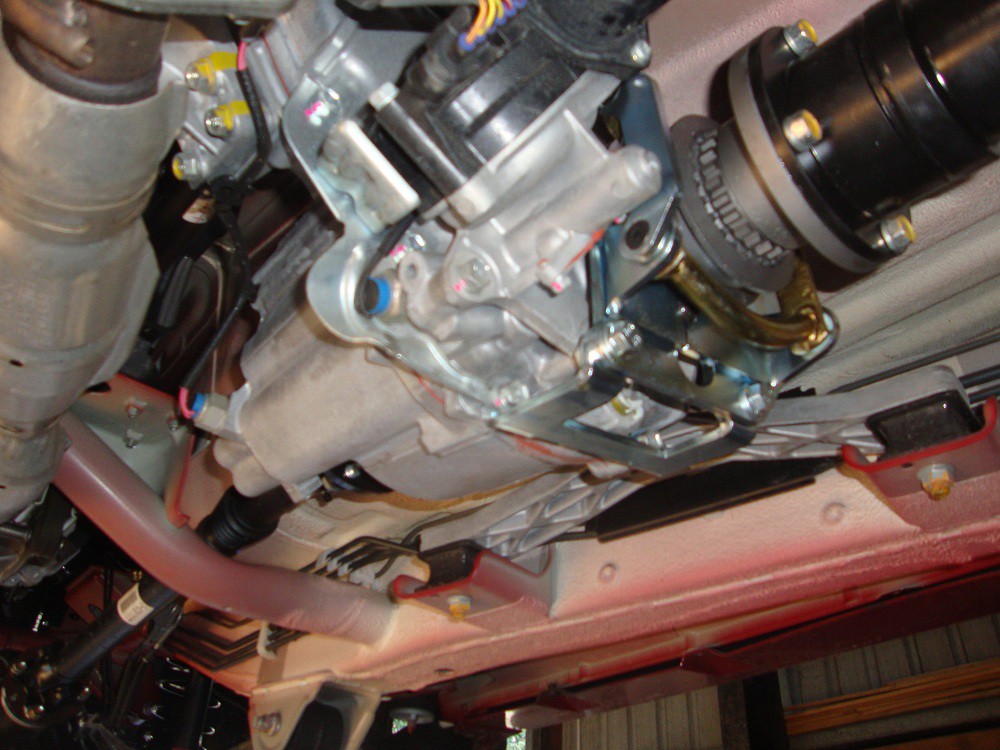

Hi Yes you do need to put a dog clutch in the rear tail shaft.It is called a "wizard" and can be fitted by most Suzuki mechanics. they shorten the tail shaft to fit this and the operating leaver comes up through the console behind the handbrake. As an alternative you can remove the rear tail shaft and drive on the front wheel drive until you need 4X4 but I have no formal qualification to tell you this is ok.
Cost was about $2500 in Brisbane 12 months ago from a company called "Suzisport"
I have no connection with this company
The pics show it all pretty well
"These photo's were sent to me when Suzisport were doing the job so they are technically the property of Suzisport. I do not claim they are my photo's" RE copywrite rules
