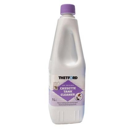

Phil C said
05:17 PM Mar 29, 2015
Thanks for the advise. Has anyone had experience with this stuff?
I don't see why it wouldn't work Phil, it's a Thetford toot so I would say a thetford product would have been tested nd found suitable for the seals etc.
I would go for that as a first preference.
I rince mine with fresh water every time I empty it so hope to get long life out of it.
