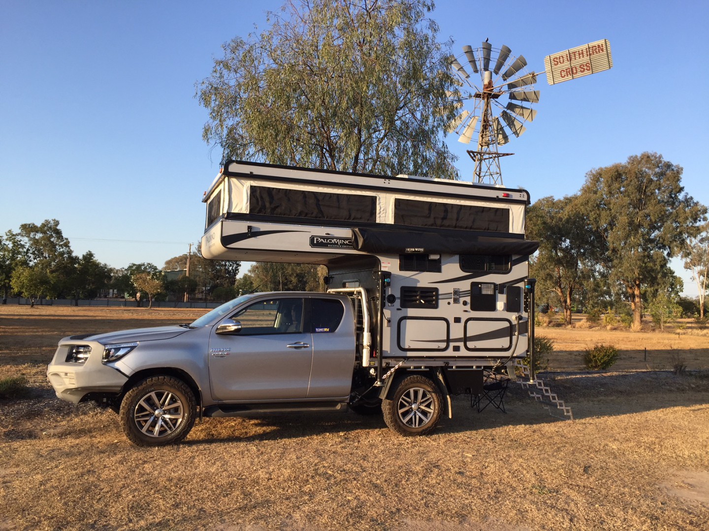

Hi, I had a Palomino ss550 on a 2017 extra cab with 2100 tray. The weight was huge at over 900 kgs loaded so with one in my Hilux with a total gvm of 3050 it weighed 3060! With a 400gvm upgrade from Pedders it gave me about 300 to spare with new gvm coming in at 3450!. Weights at up quick with palomino dry weight of 718 plus water, extra battery, solar, batwing awning ect plus gear it came to well over 950kgs!
