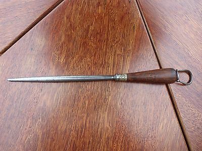

I know you can still get Carborundum ones on e-bay. Also, keep an eye out for a PIPE [brand name]Steel. Theyre scarce as Hens teeth though. I've been trying to find one of them for over 50 years. Haven't checked the net yet though. Must do that as soon as I post this.
Sheba said
11:49 PM Mar 27, 2015
Wow !!! Now I know why I've never been able to find a Pipe Steel. Just off the net. There's one on e-bay at the moment, and the bidding is, at the moment as below. Will post a Pic. of it below the following.
