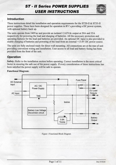

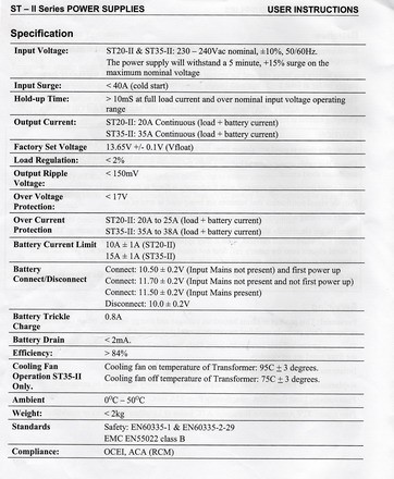

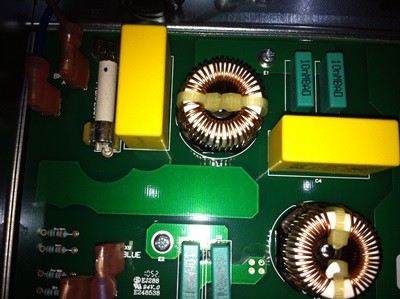

I wonder if the cut out voltage is adjustable? I could not find any variable resistors on the circuit board. I am a bit reluctant to get into the "guts" of the unit as I generally wreck more stuff than I fix!!!!

Thanks Ralph. Strange that the manufacturer would use a system (Setec with 10 volt shut off) that was not suited to the 100 ah AGM battery they installed!!! It appears the van industry is kinda "strange"!!!!
Should I try and find the variable resistor and up the voltage to??? or purchase a dedicated programmable shut off voltage device??

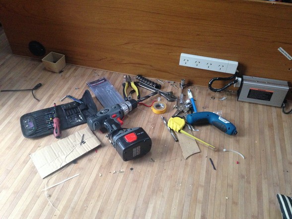

Update..The diesel heater draws up to 10 amps when firing up and about 1.8 when idling along keeping us warm.
The amps sure add up when you start measuring every device!!!
I will run a 6 B&S from the alternator output in parallel with the 8 B&S that goes to the fridge, only working when engine running. The 6 B&S can then go through a DC to DC charger at the house batteries. I should be able to run the 6 B&S beside and tie it to the 8 B&S already wired to the 12 pin plug. The 6 B&S will go through an Anderson plug. If I am not buggered by the time I do that I will use a second Anderson plug for the fridge.
After that a 200 watt solar panel. I think that I will use two solar regs for the two solar panels as I have both of those already, and the DC to DC charger from tug to house batteries.
That is the plan as I head for bed tonight!!!
-- Edited by aussie_paul on Tuesday 21st of July 2015 11:09:57 PM

Yes,That Setec does have a low voltage battery disconnect
But it is too low [10V] to protect any LA battery
This Setec unit is a primarily a regulated power supply and only a marginal battery charger. It puts out a fixed voltage of 13.65 volts as a power supply. You are probably not getting very much power back into the battery from this unit whilst running the gen set. I woud think most of your battery charge is coming from your solar panel.You may be better off with fitting a dedicated battery charger that will put much more back into the battery when running your generator. However check warning in the manual regarding max voltage of Aux input on the Setec and max voltage that can be applied across battery (14.8volts) whilst the Setec unit is present.

These are from the Setec manual.

Forgot, what is the recommended low voltage cut out setting for AGM batteries?

Setecs response..
From: Paul Bruty [mailto:paulbruty@gmail.com]
Sent: Thursday, 2 April 2015 5:42 PM
To: sales@setec.com.au
Subject:
Hi at Setec, we have a Jayco van with your ST35-II. Can the low voltage cut off point be raised, as the 10v setting will damage my agm batteries?
Regards, Paul.
Laura Lippert <laura.lippert@setec.com.au>
Hi Paul
The low voltage disconnect is not user settable.
I would recommend a battery monitor to allow you of your battery voltage though.
Laura Lippert

I reckon that the Setec could be user adjustable as the circuit shows a variable pot. Is it worth having a look inside it or should I just get one of the above items?

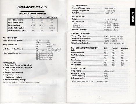

The 200 watt panel turned up today and I have drilled a hole and installed 8 B&S cable. I may need a hand from our sons once I get the mounting bits and pieces sorted.
Now, having 320 watts of solar means my 15 amp controller may not be big enough. I do have a 10 amp controller that I could run the 120 watt panel into, and use the 15 amp for the new 200 watt panel. Any thoughts please?
Tools stowed ready for tomorrow!!!!!
