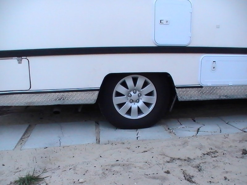

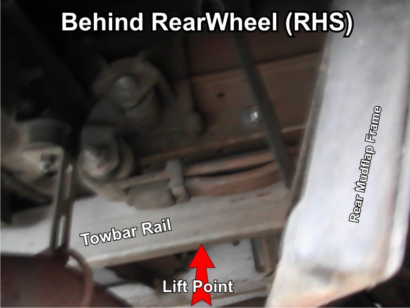

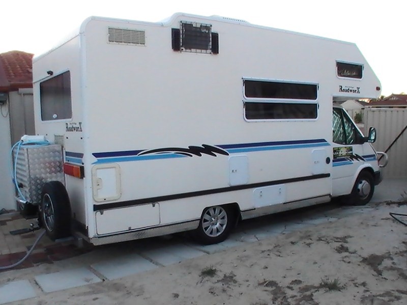

Hi Baz, thanks for the reply, the problem is safe access, my transit is very a low body to start with so getting to the rear axle without getting under the vehicle is the problem also when/if you're under there because if the low body theres no room to move. If I had 2 flats on the rear, then getting to the rear axel would be impossible. So at the moment under the towbar is the only real safe point accessible without being under it.
Here's a few pics that might explain the access problems better...., (see comments under each pic)
Above As you can see the Motorhome is quite low to the ground
The Wheel arch doesn't offer much access either
This last pic shows the Towbar Rail, there's a large 10mm thick plate (you can't see it) that's on the other side of the rail and that goes up on the inside of the Chassis. The plate uses the 2 bolts holding the spring hanger and a new bolt through the chassis in a reinforced hole. You can see this bolt its the newer shinny one. The lift point would be about middle of these bolts. The right side is the worst cause you also have to get around the exhaust pipe.

I think you will find that jacking on the towbar or the rear chassie will result in the body being lifted to a somewhat unstable height on that corner before the wheel comes off the ground. Very unbalanced stance. If you were not on a perfect site it would be dodgey IMHO. Trolley jacks do lift in an arc on a high lift too which cause instability.

I see access is your problem Steve,, a couple of pics really help.
IF you have to jack on the towbar as per the pics AND IF as you say it has a plate direct to the chassis this may work PROVIDED you don't crush the towbar tube.
SUGGESTION: Get a professional engineering works to design and construct an adapter that sits under the towbar and cannot move, and takes the load from the jack without distorting at all. This could resolve your issues. Even better if this adapter sits on your jack tightly to allow easy use.
Make sure the bolts though your existing chassis to the plate you describe are high tensile and able to take any imposed load.
Note: see the diameter of the bolts attaching the spring hanger and the diameter of the bolt(s) on the 10mm plate you mention. You may need to increase the bolt diameter if only one or 2 bolts each side of vehicle.
Hope this helps, Cheers Baz

Hi Baz, the pic doesnt really show the full height of the Chassis rail or the second (top) blot holding the spring hanger but the Plate extends to the full height of the chassis, and the "new" bolt is in an existing hole in the chassis that has a reinforcing sleve in it. The plate then extends down 75mm onto the Towbar rail which is 100mm x 50mm x 6mm. All 3 bolts are 5/8 inch high tensile. I'm pretty confident the towbar rail wouldn't crush but as you say I'd get an engineer to look at it to be sure.

Spoke to an "engineer" today, he said jacking on the towbar rail as I mentioned earlier would be fine right under where it's bolted to the spring hanger & putting on a ring lip to prevet the jack from slipping was a good idea.
Was talking with my nephew inlaw this afternoon he has a 4ton rated exhaust jack for his 4 x 4, he told me that in is possible to lift on the chassis or axle said that the bag just conforms around them. Anyway thought we might try it in a week or so if I can't come up with a better solution. Still sceptical about the bags.
