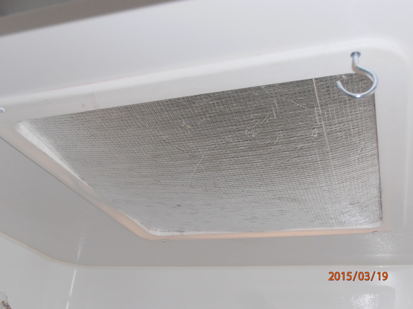

Hi all
We recently went to Sth Aust When we where there the temp got to about 45c and the temp in the caravan with the air con going
was about 30c plus, After some investigation I feel that a lot of the Heat was coming from the shower roof vent and the main
Roof Vent/Hatch so I put some insulation in both vents and I believe it drop the temp about 5c.
Just cut the insulation a little bigger than the vent hole and pushed it in works a treat.
Thought I would share that in case someone having simular problem. ( see attached)
When trying to find "hot spots" in the van one of these infrared thermometers are invaluable - just pull the trigger and point the red spot on the ceiling and then move it around to find areas that are hotter than others. They are getting cheaper with the ones in the link under $9 delivered. I've got one of them and use it for checking bearing temps, tyre temps etc etc.
Good Luck
http://www.ebay.com.au/itm/COOL-Non-Contact-LCD-IR-Laser-Infrared-Digital-Temperature-Thermometer-Gun-/251828615902?pt=LH_DefaultDomain_15&hash=item3aa227bade
