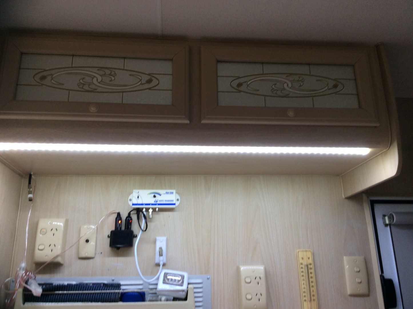

01:08 AM Mar 18, 2015
Have them down the side of my motorhome .. Excellent at night when under we are under awning .. Not too bright but can see where your going ... I used some clear silastic on the end .. Then every 200mm or so.. So it doesn't come off... I'll be fitting some short strips where required .. Fuse / elect board believe it or not has no lights !! Also the fridge temp and 12/240v/ gas control switch is hard to read with my old eyes.. Strips can hardly be seen outside its fitted just above the hinge strip ..

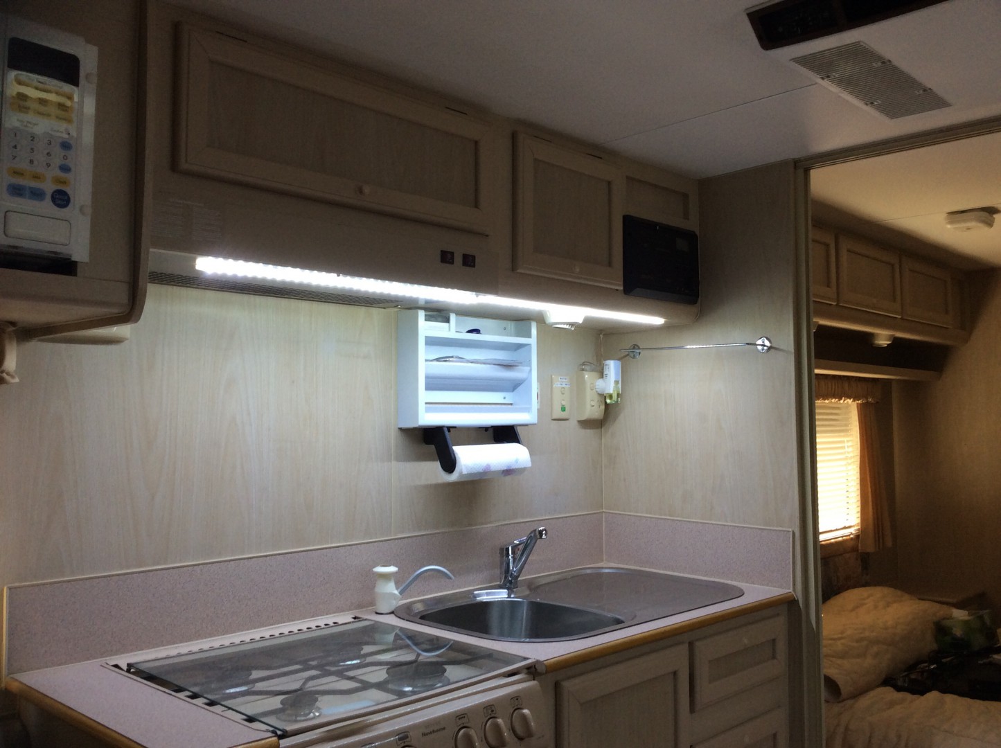

I have just fitted these two up in my van, the wife recons they are great, 1.2 mtrs with lead ,on off switch, and can fit a dimmer if nessasary ,very bright.
