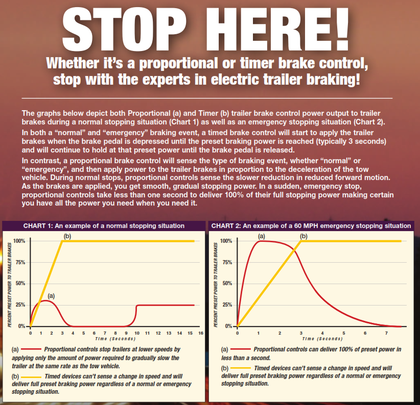

Firstly both the proportional and timer are triggered the same. There is a trigger wire that connects to the brake light circuit. When you touch the brake pedal and apply enough pressure to light the stop lights both types of controller wake up and commence to operate. From there they go in different direction..
1. Timer or synchroniser controllers - When you operate the brakes the controller commences to send power to the brakes. The current commences at a low level and builds up over a period of time until it reaches the maximum set by the variable control on the unit. The current builds up over a period of time that is set by the manufacturer. Whilst you hold the brake pedal down the controller will supply the brakes with a fixed level of power, it does not vary with the pressure on the brake pedal, it only varies with the pre-set control on the controller.
2. Proportional controllers - When you operate the brakes the controller it commences to send a minimum set level of power to the brakes. There is a device in the controllers that detect the amount of deceleration that results from the brake application. The older types had a pendulum that swung forward as the result the vehicle deceleration. This pendulum is connected to a variable control that controls the amount of power that is sent to the vans brakes. Thehe harder you apply the tugs brakes the further forward and thus the higher amount of power is sent to the vans brakes. When you ease the pressure on the brake pedal the pendulum will return to a position closer to its normal and reduce the power to the van. The action of the pendulm will thus control the amount of braking of the van roughly in proportion to the amonnt of braking you apply to the tug. (If you have a malfunction that causes the rig to reduce speed suddenly, perhaps a wheel falling off, the pendulum will swing forward but it will not send power to the brakes. It can only send more power to the brakes if you first plant your plate of meat on the brake pedal.) The modern controllers use electronic devices to detect the deceleration.

Peter, your post of an American advertising campaign material from lots of years ago has no relevance to the remote head Redarc unit. The remote head Redarc unit instantly applies the set proportion of braking effort as soon as the unit is triggered.

PeterD wrote: Peter, your post of an American advertising campaign material from lots of years ago has no relevance to the remote head Redarc unit. The remote head Redarc unit instantly applies the set proportion of braking effort as soon as the unit is triggered.
Iza, do you really know much about brake controllers or are you handing out malicious or uninformed information? The graphic I posted certainly was not part of an advertising campaign. It came from a copy of the Tekonsha catalogue when they were producing both types of controller. It was there to explain the difference between the two types of controller.
Remote head controller? you can not make yourself clear which controller you are talking about. Redarc manufactures two types of remote head This thread is about the new Redarc controller, the Tow-Pro Electric Trailer Brake Controller. It is capable of operating in both modes. Muddy was asking how proportional controllers worked so I answered him.
Quote "instantly applies the set proportion of braking effort as soon as the unit is triggered." Really, so the brakes come on with a bang? That would not be a great way for them to operate. Every time you applied the brakes the trailer would snatch away at the back of the van. You can make proportional controllers apply the braking power instantly like you claim the EBRH controller does (I take it you are referring to it.) You just whip the manual control around to maximum and maximum set power is instantly applied. When that happens you can feel the van snatch the tug with a power that upsets the passengers. You have the same power immediately as you have after the decelarometer has applied maximum set power. I doubt that anyone would produce a controller as savage as that. I suspect that Redarc produce a controller that ramps up its power in a manner to other non proportional controllers.
Your claim "instantly applies the set proportion of braking effort as soon as the unit is triggered" gives me more reason not to fit one of those old technology types. I would not like a trailer snatching away at the back of my van. If they really act as you say but don't come on with a bang then they would not be producing enough braking power for road use.
Not any more, Peter. The thread has changed to a confused discussion about the trigger for brake application and the profile of voltage applied to the brake magnets. Information about a type of Tekonsha brand controller from some time ago is not applicable to the Redarc EBRH controller, so it is a bit silly and misleading to post such information.
It is probably better to discuss different triggering methods as manual and automatic as that is the only real difference between the range of currently offered brake controllers. As you say, the TowPro is capable of operation in both modes. In the older Redarc unit, the proportion of braking effort is set manually, while in the newer TowPro there is a choice between manual or automatic, sensing deceleration rates being the automatic mode in the TowPro. In both modes, braking effort is controlled by the application of voltage to the brake magnets. The level of voltage applied, as a proportion of available maximum voltage, is determined differently. The Sawtooth in the manual mode is operator controlled, in the automatic mode, the Sawtooth is determined by rate of deceleration. The sawtooth starts at zero and ends somewhere about 12 volts, typically, in both modes.
Horses for courses, around town and low speed, or on dirt as recommended by the Towpro instructions, setting a lower proportion of braking effort results in quite a gentle retardation in speed of the combination. No need to have the "feel the van snatch the tug with a power that upsets the passengers" if you are a competent driver. At higher, and highway speeds, setting a higher level or proportion of brake voltage, ensures that the trailer does not end up pushing the towing vehicle into a jackknife. Of course, there is an assumption in that statement that the tyres on the trailer maintain adhesion to the road surface and do not skid. In manual mode setting, a high set proportion will generate a pretty savage braking effort by the trailed vehicle. Not a problem if the proportion control is set at an appropriate level. On the highway, and in anticipation of needing greater braking effort to compensate for higher speeds, setting a higher proportion of braking effort seems pretty sensible. Setting a higher level of braking effort at highway speeds was one recommendation from a Canadian crash analysis following a spate of trailer rollovers in that country.
In the end, manual or automatic is really personal preference. Immediate access to full braking effort from the controller is the function that has most effect on safety on the road.
