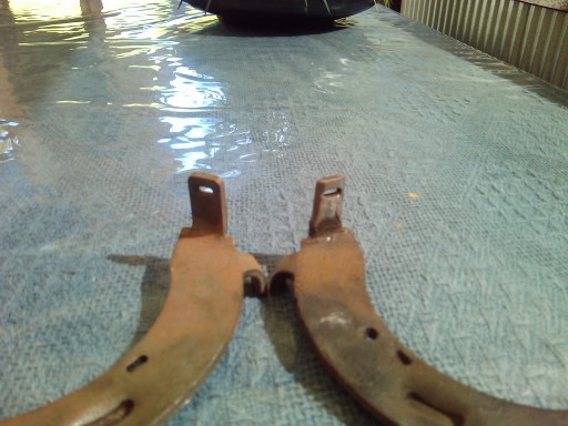

The only time I have had the wheels serviced by someone else I had a brake drum seize on me. Noticed the smell of hot brake lining (I thought it was the Clutch) I was able to do a temporary job on it till I got home the next day.
I could see straight away the problem. They had put new Magnets in, but not the off road ones I had asked for. Whoever had done the Job had put the magnets onto Worn out actuator Levers. one had very quickly chopped out the magnet centre mounting. The magnet was loose and able to jam onto the drum
The arm on the left is a New one (oposite hand). The one on the right should have been removed when servicing the brakes and bearings.
