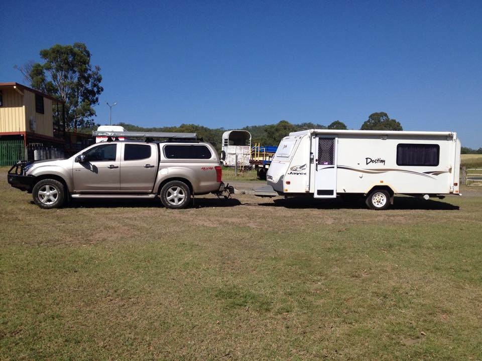

Hi, looking @ a WHD or a Stabilizer for our 2006 Jayco Destiny Poptop. Is it worth having either on a van of our size. It sites pretty level on the Dmax (as per pic) and seems to travel well. Only problem is it seems to wallow on undulating roads. Maybe shocks on the ute might fix this.

Re = the wallow - have you checked your tow ball down weight of the van or is the van packed with too much weight in the rear? These are 2 things I would check. As you say the van looks pretty straight in the pic.

From the picture it looks to me like the bum us down on the ute - maybe 40mm or so which indicates to me that the rear springs are carrying too much weight either via towball down weight or whatever you are carrying in the back of the ute like batteries or a generator. This will cause wallow which is dangerous to say the least. The fix for that is a WDH and/or airbags for the rear which will help balance the unit..
