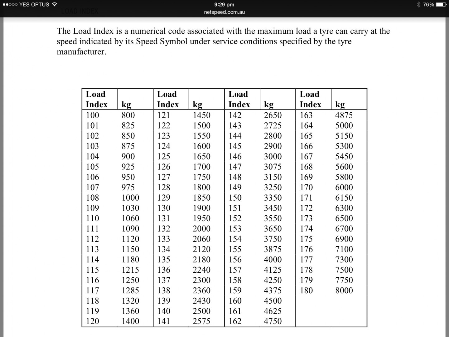

Hi Dougwe remember if you do get an upgrade that your tyres also have to be able to carry the new rated load this chart will help determine if your tyres are up to a new rating
I reckon the Cooper AT 3's 118R will cope nicely Woody n Sue.
