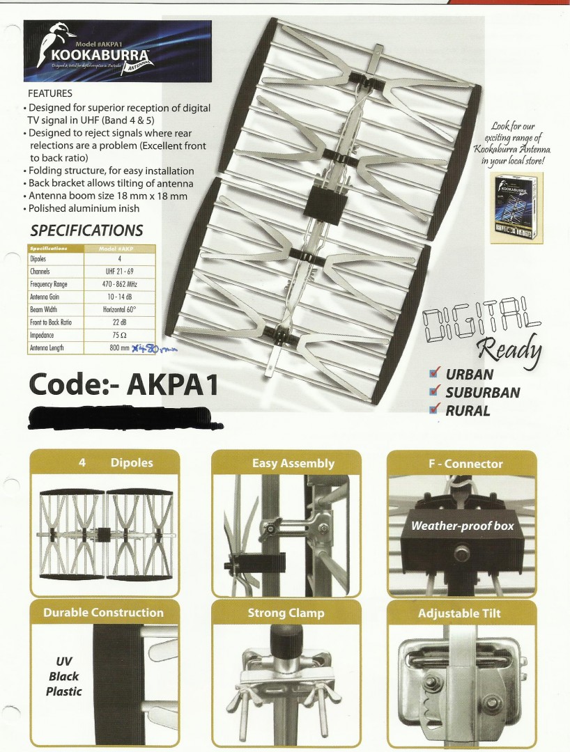

Unless theres a reasonable signal neither of them are going to be any good. The 30db gain is from the amplifier, the Majestic antenna is round & small Omni directional, so there will not be mutch gain or signal from the antenna to amplify un less you are in a strong signal area. The Winegaurd free vision looks slightly better. These RV type antenas are at best a compromise. And the antenna gain is only 1 or 2 db. I use a phased array type antenna that's directional & has a gain of 10-14db without an amplifier, far better antenna & cheeper about $60 then add an Amplifier if you feel you need it. May not look as COOL as an RV type but its a proper antenna.

The antenna that DeBe has pointed out and while a good antenna does not adress the VHF side of things and would preform poorly at these frequencys. A lot of areas still use vhf as well as uhf and now that we have had the restacking of channels happen, every thing has moved around to other channels EG; where i live ( Mildura ) all of the UHF channels moved to the VHF channels last August ( 2014 ).
