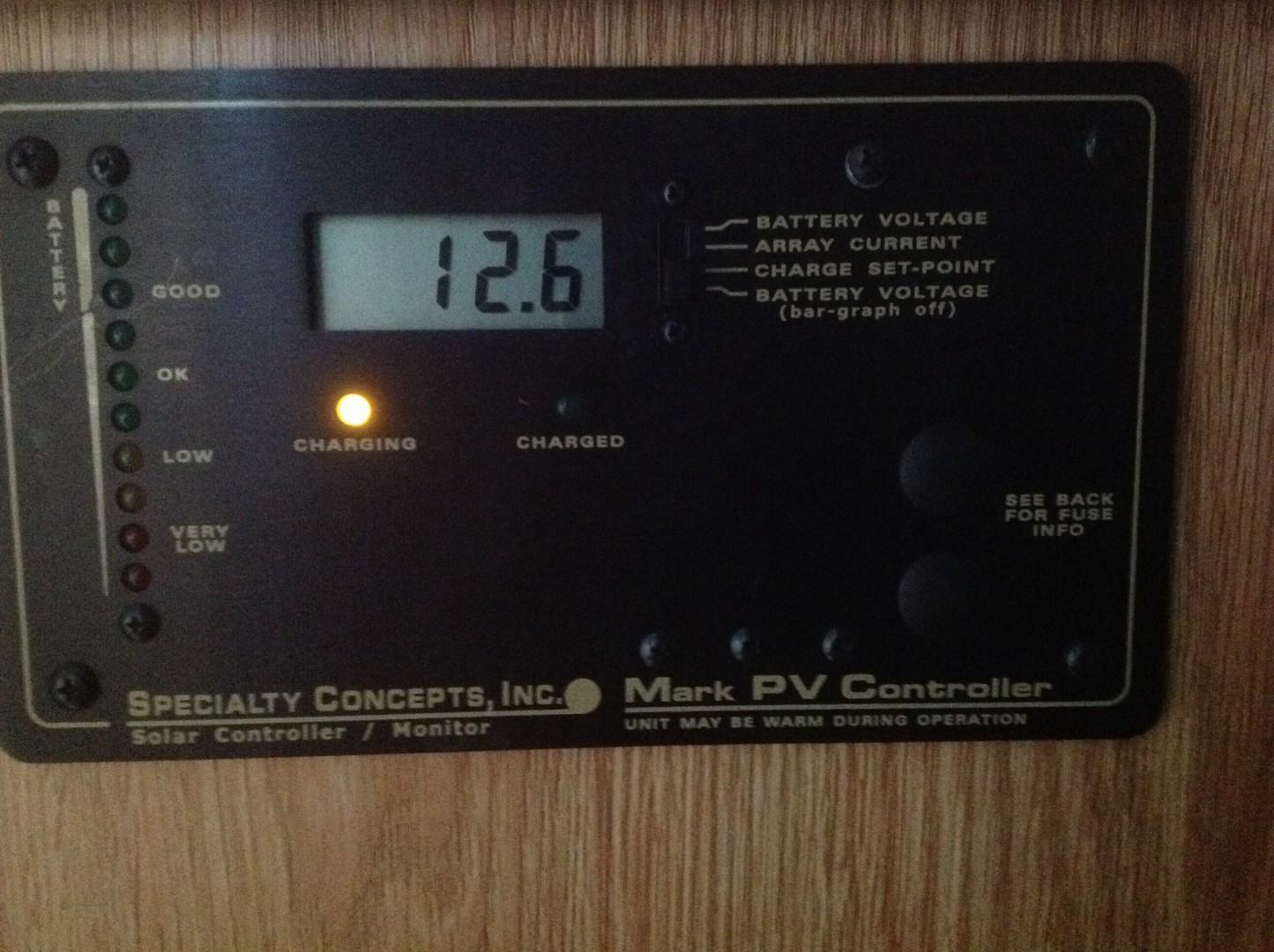

I am fitting new battries to our van and have the old ones removed and all leads that were connected to the batteries are dangling free not touching any other lead including the solar panel
Do you have the 240 volts connected? Maybe the solar panel is still connected via the regulator.

No no 240 power either

The light says Charging so its getting power from somewhere, as Phil says, Maybe the solar panel is still connected. Or is the van still conected to the vehicle's wiring?

Cover the solar panels, You should always disconnect the solar panel wiring prior to removing or replacing the battery/batteries.

I would agree to cover the solar panel or take a look at night. Disconnecting the battery won't disconect the solar regulator. Please don't short the battery leads together during daylight.

When dealing with solar panel regulators the first thing you should do when you are disconnecting things is to disconnect the panels first. When restoring the system the last thing you connect is the panels.
Many of the regulators rely upon the batteries to be connected before connecting other circuits to the regulator. They do not operate properly if you don't.

see I figured that disconnecting all wires from the battery would mean that every thing was disconnected seems I am wrong as i took the advice of Patrolst (Jim) to cover the solar panel and check, well no reading on the meter so it was the panel charging something or at least going through the display thinking that it was charging some thing,
So I have not yet found anywhere obvious to disconnect the panel or where the solar regulator is located for that matter unless it's in a black box on the rear of the panel which is pop riveted to the roof mount inconvenient to say the least .
Stop press just had another look found fuses to pull for the solar panel on the back of the display which is also the regulator by the looks of it
