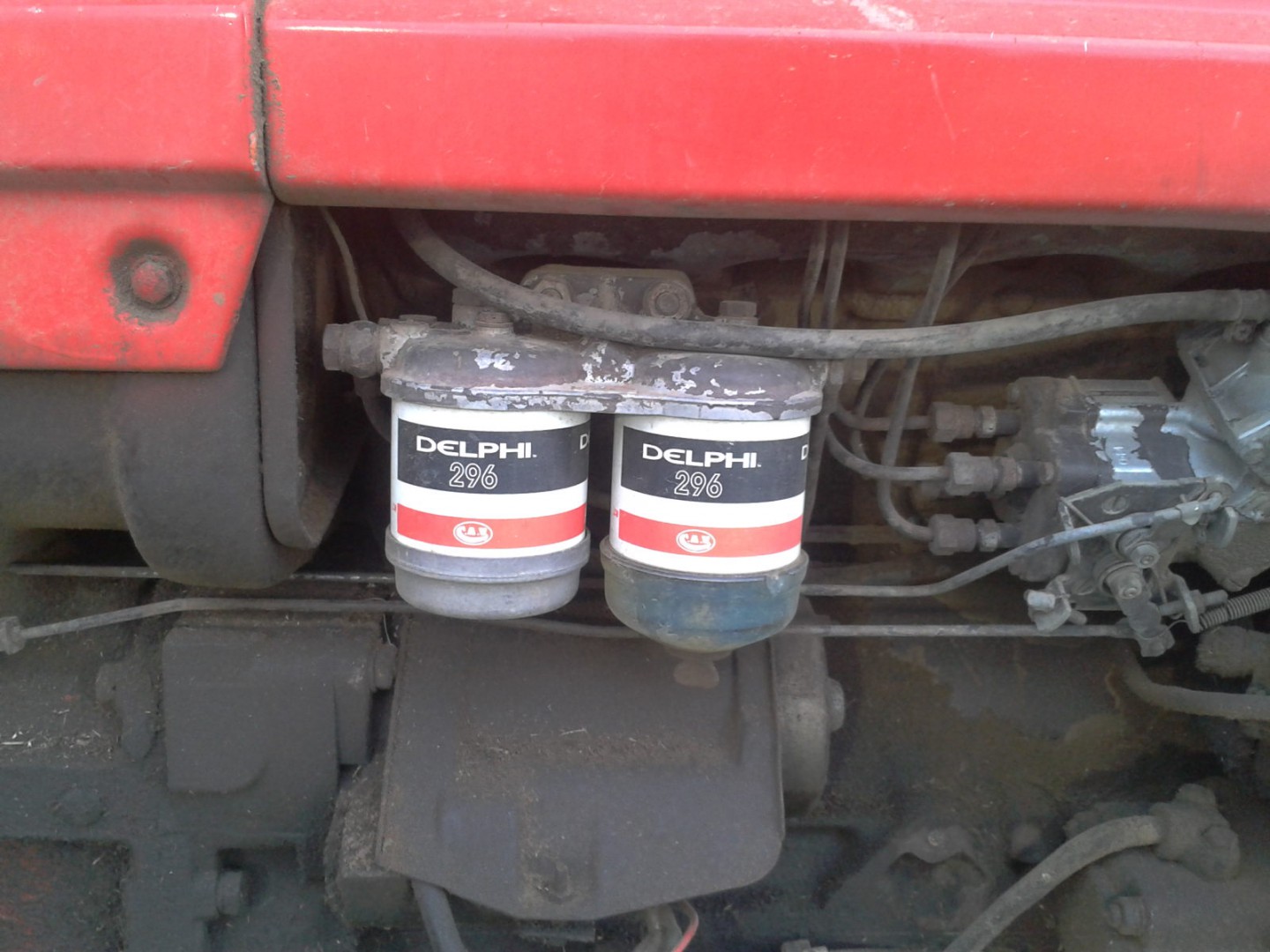

Hi aussie paul, You would put them in series. In the 'good ol' days' all working diesels had two filters in a unit together. The idea was the first one took out most of the crap and also had a glass bottom so you could check for retained water easily and drain it if some was found. This meant the second filter could retain all the remaining dirt and none would get to the motor. So you replaced the first one more often to keep it all working well.
For example below a filter system on an old tractor. A good idea if you want trouble free motoring. Those filter elements were cheap as chips too !!

Fitted the Lucus/Cav type filters with the glass bowl inside the battery door on the Coaster for easy access, its before the factory filter & gives me filtered fuel for the diesel heater as well, amazing how much crud it collects. Also fitted a outboard type primer bulb to make bleeding the filters/fuel system easier.
