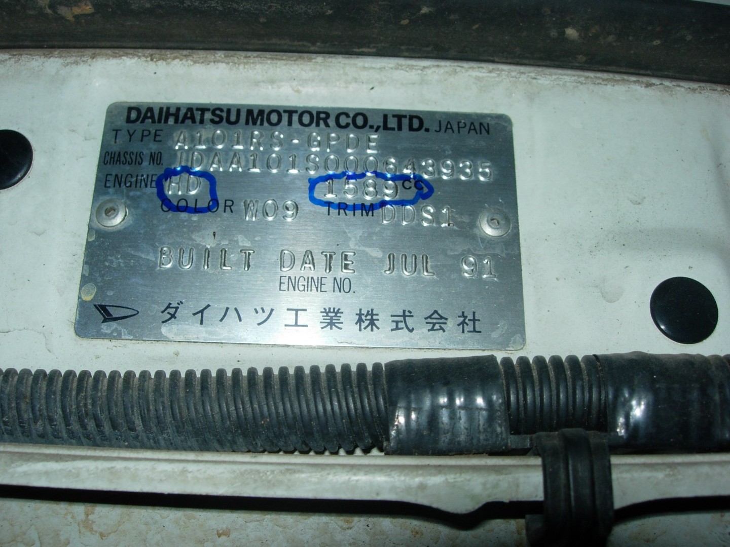

There will be parts available some where. First you need to find the compliance plate, every vehicle will have one. On it will be what Engine family (HD) & its size (1589cc). Heres a picture of a plate on my Daihatsu I have marked the data you need. I don't have trouble getting parts or gaskets for this vehicle, because other Daihatsu use the same Engine family. Toyotas are no diferent & there plate is very similar.
Thanks everyone for your feedback..
I think the plate says 2-CT...

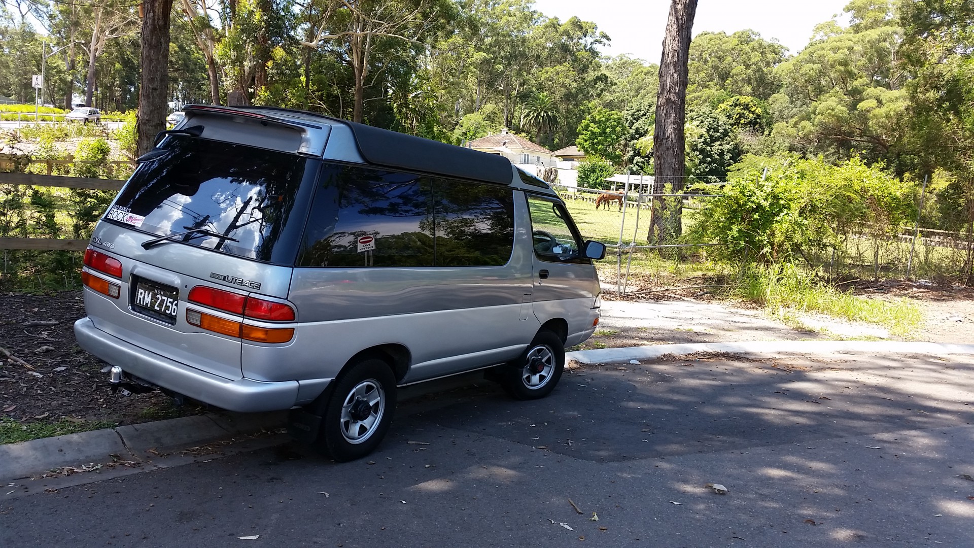

I did not think any Hiaces had a 2 CT diesel motor but they might have. Is it a Hiace or a Lightace or Townace or a Tarago ? You could find out on that site ! Or find the Manufacturers plate as DeBe said. Note it is not a compliance plate actually. There will be two plates, one a compliance plate for rego purposes and the manufacturers plate which identifies the vehicle and the mechanical items fitted to it and some other useful stuff. All Toyota's have one somewhere. It might be below the drivers seat hidden by a flap of upholstery.
I looked at the picture again and see it is a Lite Ace. It will be a 2 CT or 3 CT motor. The plate will be below the drivers seat under the flap. Note all the numbers on it as they are all useful. There are two types of these motors the upright type like yours and a "flat" type fitted to the imported Tarago's which are on their side. Not sure if the manifolds are the same but these engines are not as common or available as some other models. However there are places who will supply parts. Look on that site for a part number.

Hi Greys...
I have been a member of Grey Nomads since the website first started..
I have purchased a Toyota 1992 Hiace 4X4.
Imported as a Campervan.
The van has been so hard to get parts for..
Can anyone help me I live in the Sydney area.
Currently looking for Exhaust Manifold & Gasket..
