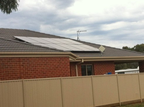

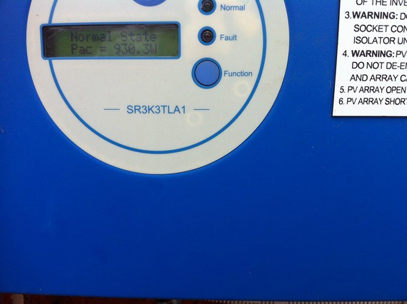

Today I had a look at the digital read out on the wall mounted unit. We have 10 panels and a It tells me it has generated 3825 kw. It has been operational 395 days beginning 22 January 2014.
That is an average of 9.7 kw per day Here in Ballarat Victoria.
I think it all about were you are and how much sun you get . I have 2 lots of relations in North Queensland both with 20 panels 5 KW system, The one in Mareeba on a good day produce 30 kw a day , The one in Townsville produce 27.5 kw a day

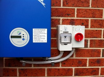

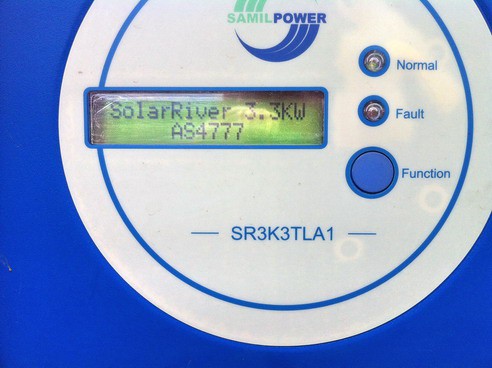

aussie_paul said
03:55 PM Feb 22, 2015
SnowT wrote:
hey Paul.. you need to give us some more figure's..
- size of the system... How many Kw. - size of the inverter..
At a general guess.. you have about 1.6-1.8 kw of solar on your Roof.. and a 1.6kw unit on the wall.. What does your Bill say you have put into the grid..
That is a typical small system... if your a light user you will break even....
From my stand point..
2 systems.. 1.6kw system located on the garage.. 5.4kw system located on the house..
We have a total of 7kwh of system... Take into account that you will Pretty much lose about 2-3% of the panel output after 12month's.. Yes if you did not know the manufacturers have a chart that shows this fact...
A good sunny day for us we are producing over 30kwh of power with Peaks in excess of 5.4kwh into the grid... from about 12-2pm..... Our Last bill was in the credit's, to the extent that the next one will be in the credit as well even if we have ****ty weather, and we are medium down from Heavy users... we are under the local norm for our area..
If you want to know my thoughts on Grid connect system just ask...
Juergen
Hi Juergen, I think our system is a 2.5kw with a 3.3 inverter. Our Smart meter tells me that we have put 16.15 kw into the grid in 11.75 months. We are not what I would call heavy users, only the two of us with monthly weekend visits of daughter.
We have natural gas for hot water and cooktop. Aircon and oven are power.
I have yet to get my head around all the figures as the energy company were very slow in sending accounts, but now that I have accurate measurements from March 1st 2014 to March 1st 2015 I will dig all the accounts out and wade through them.
-- Edited by aussie_paul on Sunday 22nd of February 2015 04:01:37 PM
