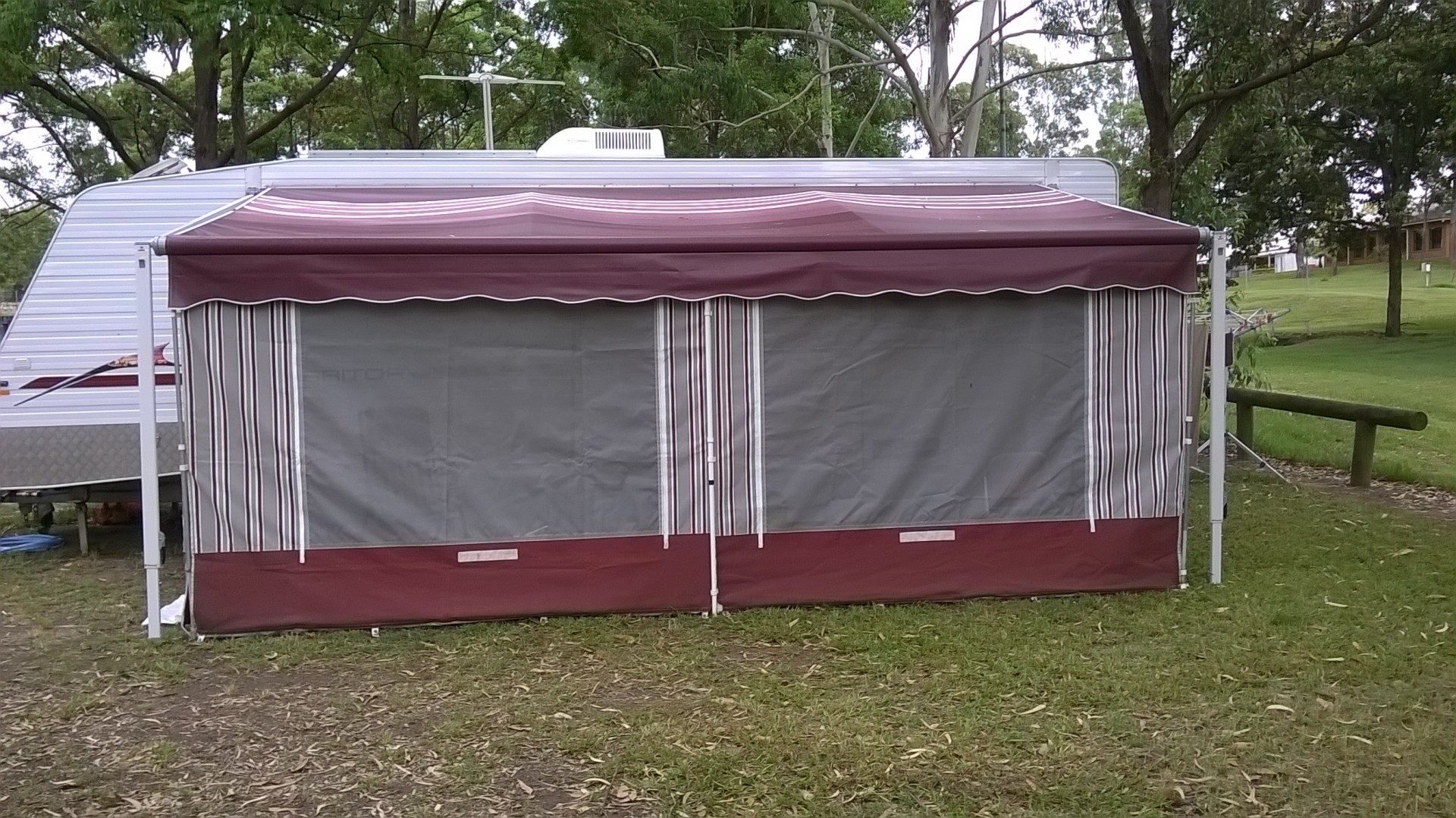

good morning everyone in grey nomad land. I have a question. Strop and I have put up our awning for the first time. It looks great but we are wondering does it still need to be tied down at each corner or is it ok as is? Also, we have a skirt and were wondering how people prevent ants from getting into the van. thanks everyone. rocket n strop

I appears you have the AussieTraveller Anti-Flap Kit bars on each end and a couple of rafters so, these, with the addition of guy ropes on each corner, would make it pretty secure in winds gusting to at least upto 55kph - from my experience.

Wow..
It looks very well tailored to fit. Wish my vinyl one was that good.
I always install guy ropes ... two at each end & double pegged EVERY time I roll out the awning irrespective of whether I fit the annex.
One guy rope is fitted at each end following the line of the rafter & the others at 90 degrees to it. The first peg is angled away from the van and the second again angled but at 90 degrees to the first. Always use strong springs on the guy ropes. One guy rope goes around the rafter & the other is attached to a stainless steel saddle bolted to the awning arm. I also use rubber bands made from inner tubes to peg down the annex walls. Twist them to fit. When ever possible I leave the awning 'legs' attached to the van walls. If not I use large angled pegs to pin them down.
A good habits to get into.
My mate 'The Awning Man' makes a good income from damaged awnings caught by un- expected gusts of wind.
ps... Make sure that you have a generous lowering of one end to facilitate water run off. Once water pools in the awning it will stretch the fabric & give you a problem for ever. A large pool of water can tear the awning too ... again a common occurrence.

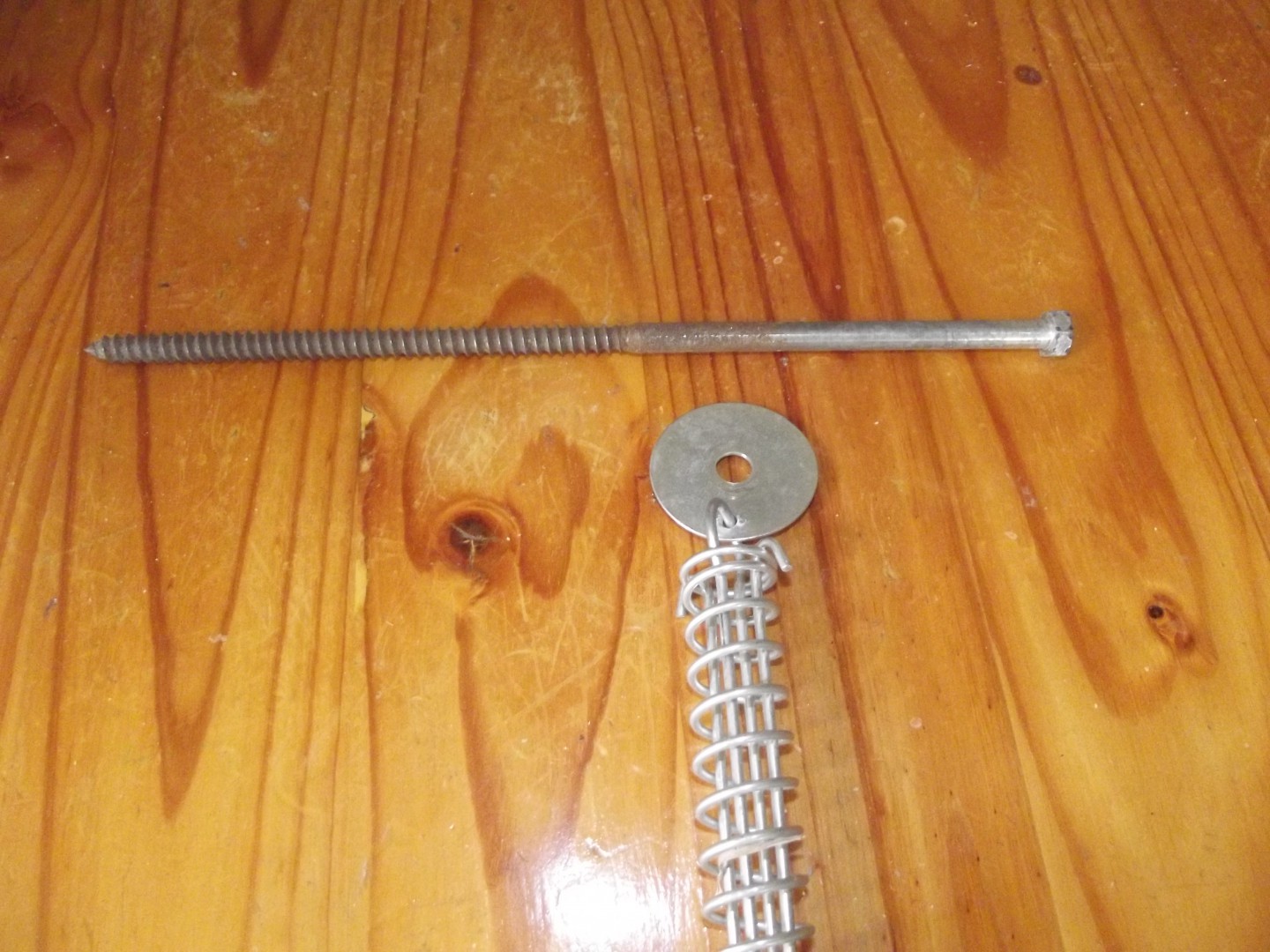

My 30cm (12-inch) screws. The washer is 50mm outside and 10mm inside diameters. Just drill a 4mm hole in the edge, remove a center loop from the spring, thread the washer onto it and slide the loop back through the spring.
Simple to use, just drill the screws through the washer hole.
Note that the commercial screw peg businesses provide plastic clips which I wouldn't like to trust - particularly in Australia's harsh sunlight.

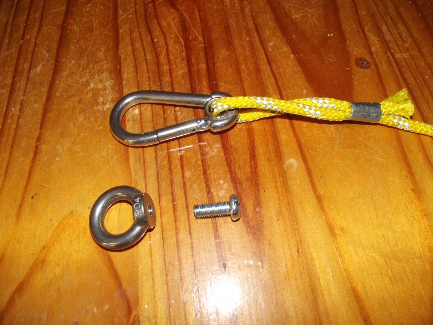

The lifting eye nut fitted to the top of my awning leg.
(Yes, the roller has been removed for repairs.)
Had that blind nut you see at the top been 8mm then I would have used a lifting eye bolt, save drilling a hole.
Hope these photos help to understand what I have posted.

Anyway, this is the 'lifting eye nut' I have fitted to my awning legs.
All three items are 8mm stainless steel. The snap shackle has been strong enough for everything that has hit us to date.

Interesting about the cat collars. Obviously you have tested them for strength - after all, a cat isn't a very large animal. I also tried the 'C' clips sold on eBay that wrap around the roller with a tab keying into the slot but didn't like them as they applied a turning force on the roller when pulled down with guy ropes.
I have four guy ropes with the snap shackles fitted, that allows me to put two ropes on each eye.
By the way, while not evident in the photo the ropes I have been trialling are reflective. These ropes are available from both Bunnings and Masters in various colours - I bought yellow from Masters. So far I haven't had a failure - but I have kept the ordinary ropes on hand just in case.

The collars we got are made out of the same material as the tie down ratchet straps. So far no wear and tear or any effect on the roller. We were in 60 knot winds on and off for 10 days and the awning held strong.
