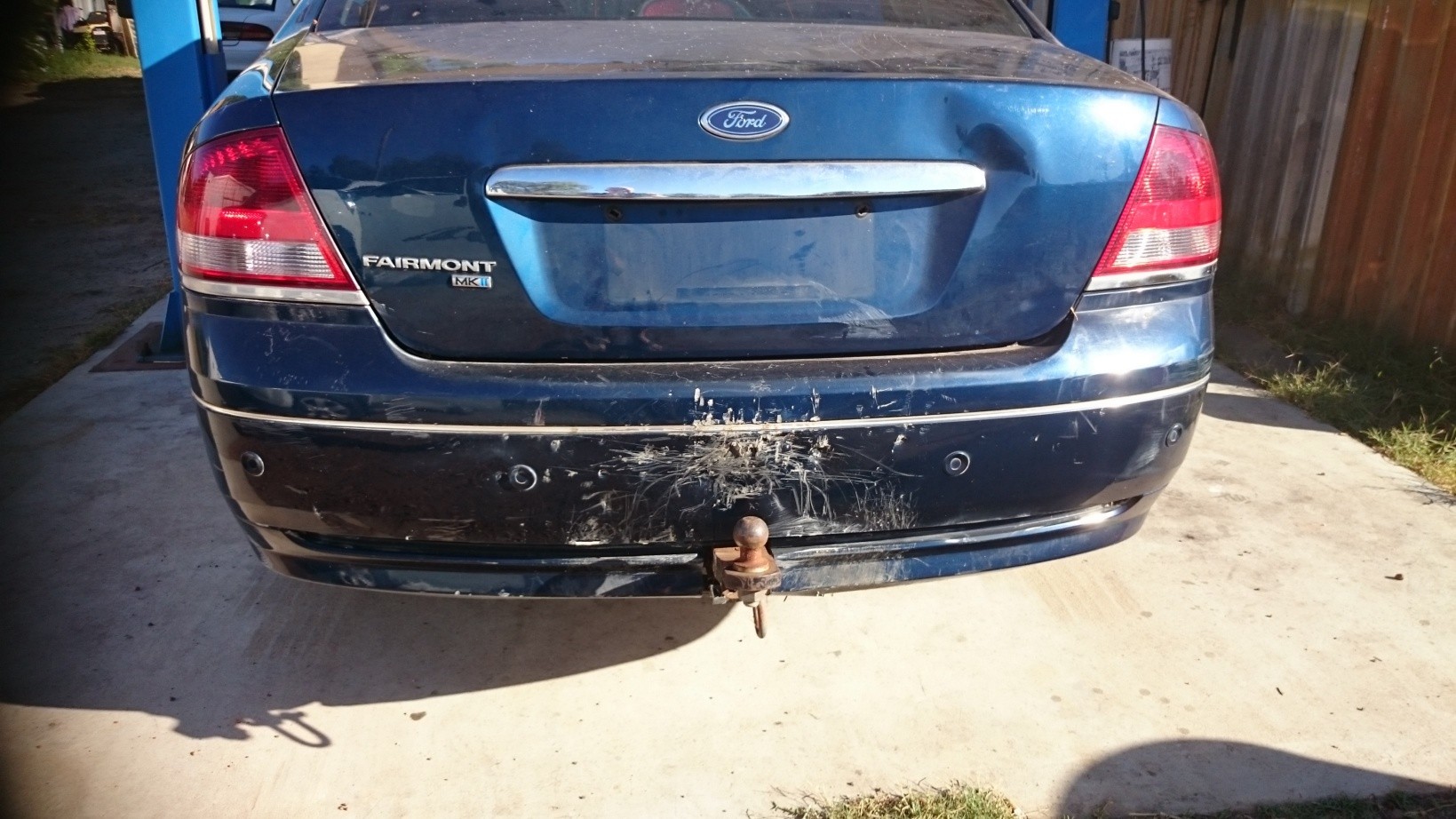

I know somebody who is a bit rough hooking up trailers, I may pass this idea on them them, what ya reckon?
The dent above the Falcon name badge might pop out, but don't know about the other one. The rear of the vehicle is so badly damaged though, I guess the worst you can do is destroy a soccer ball lol
Why are the rego plates off it?? Been removed by the police?
Lance - now you just gotta work out which DMax towing some sort of RV in Australia is my one LOL................

Bruce and Bev wrote:
Jeez..............do they back by braille !!!!!!
Ha ha, it was bought, by an acquaintance, unlicensed for $500 from some 'horsey' people who were pretty rough & careless connecting horse floats. Maybe it was the kid's job.
A new bumper & pop the boot dent it will be like a new one!
