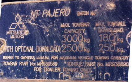

You also need to check the info plate on your towbar..
Glen

Ok Glen, I just assumed (always a mistake) the towbar would be able to carry the vehicle towing capacity. Should there be a plate attached to the towbar somewhere?

In WA they are reqd, so I would think it was the same across Oz.
Cloak said
11:22 AM Feb 14, 2015
You can get the plate re-stamped with higher capacities for a small donation.

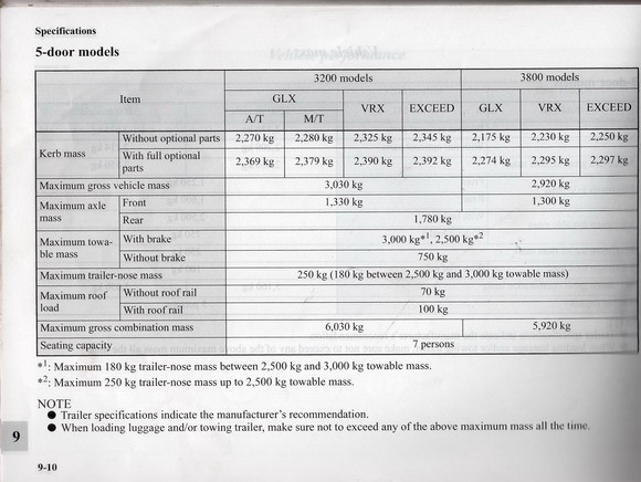

WDH does not alter the ball weight. All it does is to alter how that ball weight is distributed amongst the axles. No matter what you do, if the loaded weight of the van is under 2500 kg the bal weight when not attached to the van must not exceed 250 kg and if the total weight is over 2500 kg then the ball weight must not exceed 180 kg. Mitsubishi do not have a sliding scale for ball weight for vans over 2500 kg so any vans over that weight must have ball weights under 180 kg.
-- Edited by PeterD on Monday 16th of February 2015 12:36:47 AM
That's how I understand it Peter. The WDH bars were laying on the weighbridge bed, so in theory, I could remove the their weight from the measured ball weight. At least I have made an effort to understand our rig. Plain to see who has too much time on their hands!!!

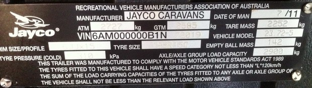

I wish I knew how you keep your van weight down. Again assuming your plated Tare is correct at 2252kg and your weighed mass is 2490kg means you have 238kg you have added.
So, at 2 x bottles of gas @ say 18kg, 2 x 90L water tanks 180kg (water only) , add to this 30kg water in containers, 5kg diesel, 25kg(???) generator adds up to 240kg of additions.
Where are your clothes, food, wine & beer ( ) hoses, mats, annexe etc? All that stuff that accumulates?
Don't take this wrong, I am not 'picking on' your figures just trying to understand them. I am assuming your van is loaded for travel?? If not then your figures look excellent.
In our case our van, 21'6" tares at 2260kg but would be onroad closer to 2900 and the genny rides in the ute tub.

No worries Neil, I asked for comments. The 30 kg of extra water would be replaced with clothes etc. Already have annex, hoses, matts, pantry items on board.
At least I know and am not guessing.
