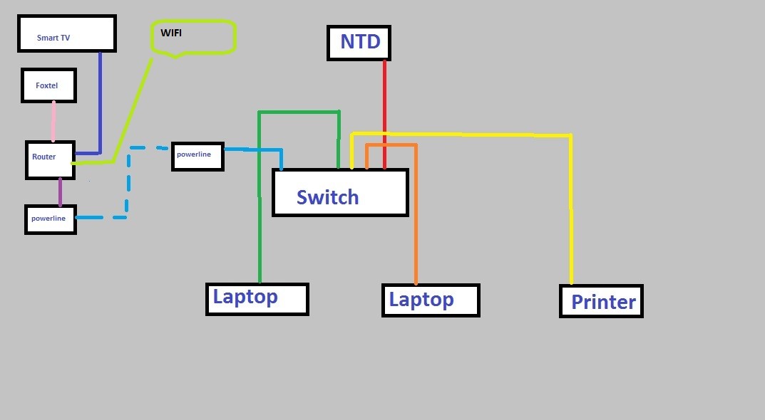

If you are in an area that is about to change over to NBN fibre service, think again about purchasing or the free modem/router or router option.
I have been on the NBN for 2 years, at first I was not impressed because it didn't seem to be much faster than ADSL2, are starting to run various speed tests I found the Modem/Router supplied was not getting the required speed. the ISP (iinet) were fantastic in trying to resolve the speed issue to the point of on 3 occasions sending me new preconfigured Modem/Routers al suffered the same speed issues, and showing me that I could connect directly from the NTD to my Ethernet port ( running the speed test it was at max speed).
This lead me to believe that the issue was with the BoB Lite and BoB2 Modem/Routers which were designed for ADSL2 and then upgraded to be used with NBN Fibre, so to prove my theory I purchased a D-Link DIR-626L Gigabit router, immediately on connecting it delivered almost max speed. To iinets credit they gave me 6 months free access for mu issues.
My D-Link played up the other day so to insulate myself from future problems, I decided to create a whole new network at home all based around an 8 port gigabit switch, as suggested in a previous thread.
This is a pic of my new network which works a treat with no speed loss, with an up side my Smart TV can be connected either 2.4/5 wireless or via Ethernet port which it is now and its faster than wireless
So now the only devices that connect wirelessly are phones and tablet.
