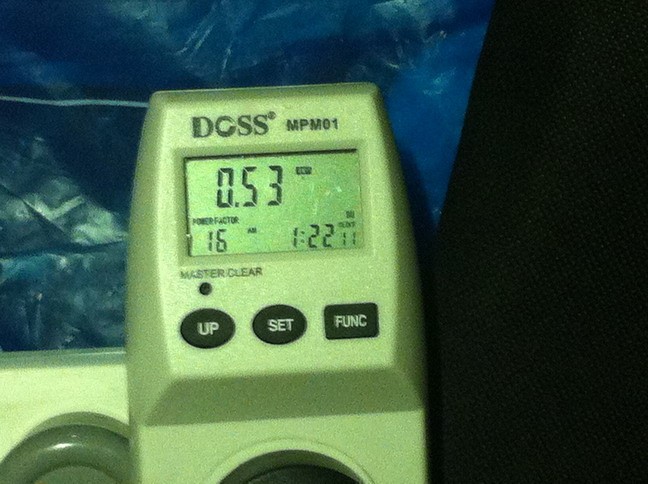

I have a Sphere roughly 20" led tv in the van. I measured the dc current draw today of 9 amps, because I thought that a voltage drop of between .5 and 1 volt was excessive. The AC current draw off the inverter was showing .39 amps. Thoughts??
11:10 PM Feb 2, 2015
Your inverter appears to be supplying approximately 95 W. That's a hell of a lot for a small TV. In this day and age why don't you use a TV designed to run off 12 V. They are mostly more efficient in the first instance and you don't have the power losses in the inverter on top of what the TV draws.
-- Edited by PeterD on Monday 2nd of February 2015 11:15:46 PM
Screen Size: 19.5 inch TFT LCD AV Playback: PAL / SECAM /NTSC Down Firing** Stereo Speakers DVD Player: DVD,VCD,MP3,Audio CD, CD R/W, JPEG,CDDA, WMA,CD-G,DVD-R,DVD-RW,DVD+R,DVD+RW,DVD-5,DVD-9,DVD-10,DVD18, HD-CD Inputs: AV, 3 x HDMI, USB 2.0, Tuner: HD Digital (MPEG4 HD ready) DC 12V Cigarette plug included , AC power adapter 240V included Power Consumption at 12V: 1.8A , 21.6W Dimensions of Screen: 467W x 281H x 49D (mm) Dimensions with stand: 467W x 318H x 176D (mm) Net Weight: 3.3Kg Native Resolution: 1600 x 900 pixels Mounting holes: 75mm x 75mm (VESA Standards)
So yes, it seems to be drawing way to much current.

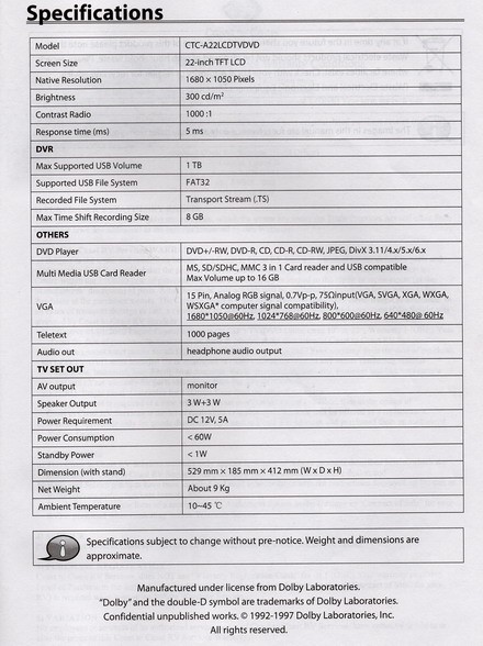

The tv is 22" and requires a 12v 5 amp supply and power consumption under 60w. AND it is a LCD not a LED!!!
It is beginning to look like the DC wiring is too light, thus the voltage drop. Anyone disagree?

Hi Paul
Those AC figures simply mean the TV is drawing 93.6 VA at a PF of 0.xx[ NOT 93.6W]
What was the PF reading??
Certainly , it cannot be,what I see ,16 [on your meter]??or is that 0.16??
The actual Watts for the TV would be more like 40<50W=4A @12V
Also HIGH volume levels encrese the current
Even with inverter losses, 9A @12V current draw ,seems excessive
What are you measuring the DC current with??

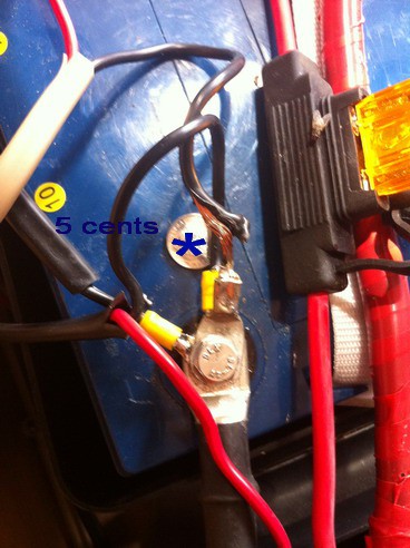

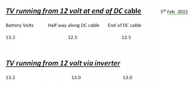

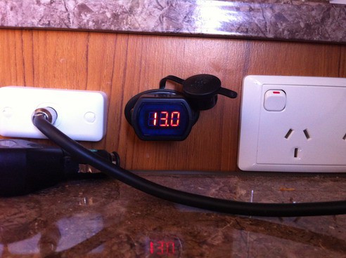

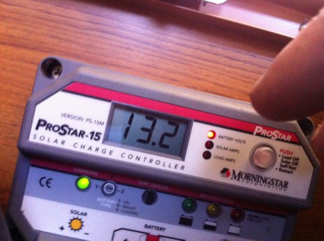

I ran some more tests today, and will try and get to the DC cable to see how thick it is tomorrow. I am beginning to think that this particular TV is drawing excess current for some reason.
Looking at that table I wonder if it's actually the quality of the connection to the battery. Maybe corrosion built up under the terminal? Also how did you measure the votage halfway - insulation piercing probe or is there a join there, if a join did you check both sides of the join.
Just my 2c worth, but for you I'll round it down to free!
aussie_paul said
11:22 PM Feb 5, 2015

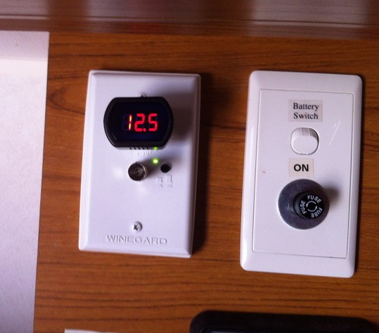

Pete, connections to Battery are ok. Half way along to the TV is the Wineguard antenna booster that also has a cig socket where I plug my volt meter in.
Looking at the photos you have just posted you have 13.2 at the battery, 12.5 at the booster (midway Winegaurd power point) and 13? at the TVsocket - is that the correct understanding? ie lost and then gained, may be different circuits?.

HI Paul
PF is the "powerfactor" which seems to be showing as 16 on your meter which cannot be correct[usually ranges from 1.0 > 0.4]
It only applies when measuring AC loads ,current , volts, Watts OR VoltAmps with a PF number.
Watts & voltAmps are only the same value when the PF is 1.0
In all other case with lower PF> the VAmps will be higher than Watts
THe specs say <60W ;at 12V= 5A plus inverter losses
That would be at max volume & brightness
Your 12V dc draw from the battery to the inverter should not be much more than 6A
BUT if you do not have 12V at the inverter with the TV turned on ,it will draw more current
You need to check the actual voltage at the INVERTER DC input terminals with the TV both running & not running
If there is a significant difference you will need to check back towards the battery with the TV still running until you find a point where the voltage suddenly changes [encreases], the problem will lie between that point & the previous lower voltage point.
ps you should use the same DC voltmeter to do all the dc V measurements
Your are aware that the power meter you used in first pic is AC only?
It will have a significant error on DC

Hi and thanks Ralph, yes I knew that was an inline AC meter. I removed the solar input to the solar regulator to run these tests.
Battery voltage at inverter input 12.79.
Battery voltage at the inverter input with Inverter on and running TV was 12.72 using same meter.
DC amps at inverter input with TV running a little over 5 amps on an analogue gauge I have.
DC Amps running all the van lights was 3.8
DC Amps running TV on the DC system was 4.2
I have found that the inverter can make my cheap multimeter give crazy readings, and affects the tv signal in poor reception areas!!!!

[1]That indicates a well charged ,& if a rested voltage ,a fully charged battery,tick OK
-- Edited by oldtrack123 on Friday 6th of February 2015 12:12:16 AM

[1]Battery voltage at inverter input 12.79.
[2]Battery voltage at the inverter input with Inverter on and running TV was 12.72 using same meter.
[2]Better than expected, tick OK
[3]around 64W input input for The TV which is rated 60W [depending on volume & brightness settings]
Not much wrong wth that, possibly 90% efficient

[6]Obviously not a quality PURE sine wave inverter!
Yes, AC meters can give funny readings on other than pure sine wave
