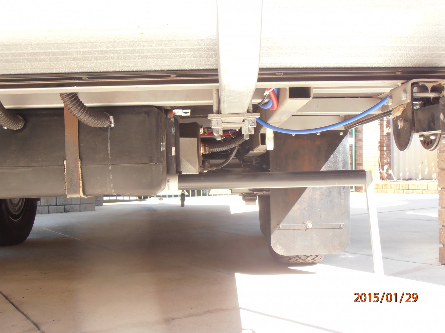

I think if I tell you why I asked the question you may under stand more. Im fitting a grey water tank and because the outlet was originally up on the chassis (SAFE) now it is a lot lower
maybe 180mm and not so (SAFE) I feel it would be safer going out the rear of van maybe.

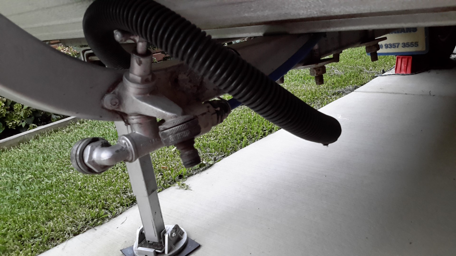

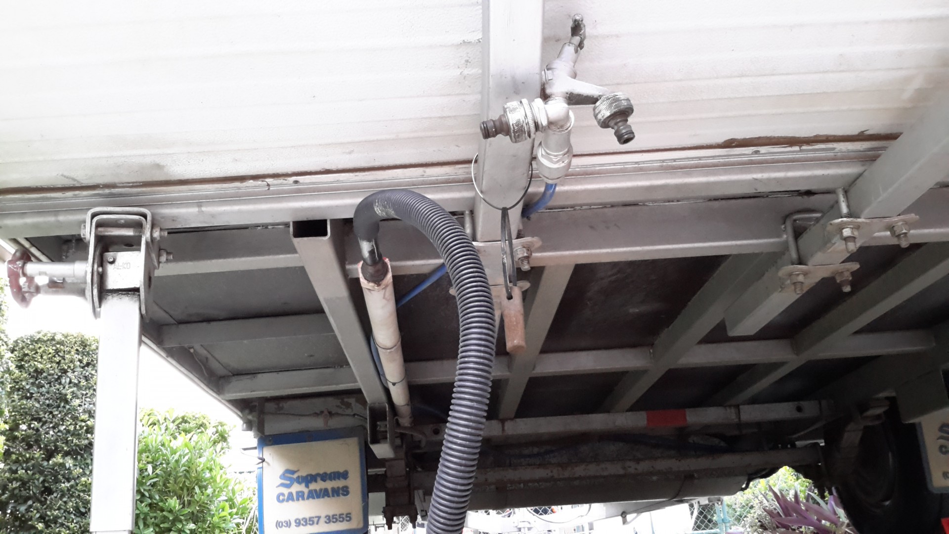

A couple of photos would be good.
Here is my hose outlet and water hose in plus the extra tap for water when outside. The wooden plug is to stop the wasp building a nest.
I normally have a very short hose from one inlet to the out on the water but I was in need of some ends at home.
There's some great comments I don't think my van will bottom out because it an off roader.
More concerned about rock for roads, see attached
the pipe that is there is just for demonstration
Nice work the photo, like my outlet I don't believe rocks will get it. But then it could, like winning the lottery.
