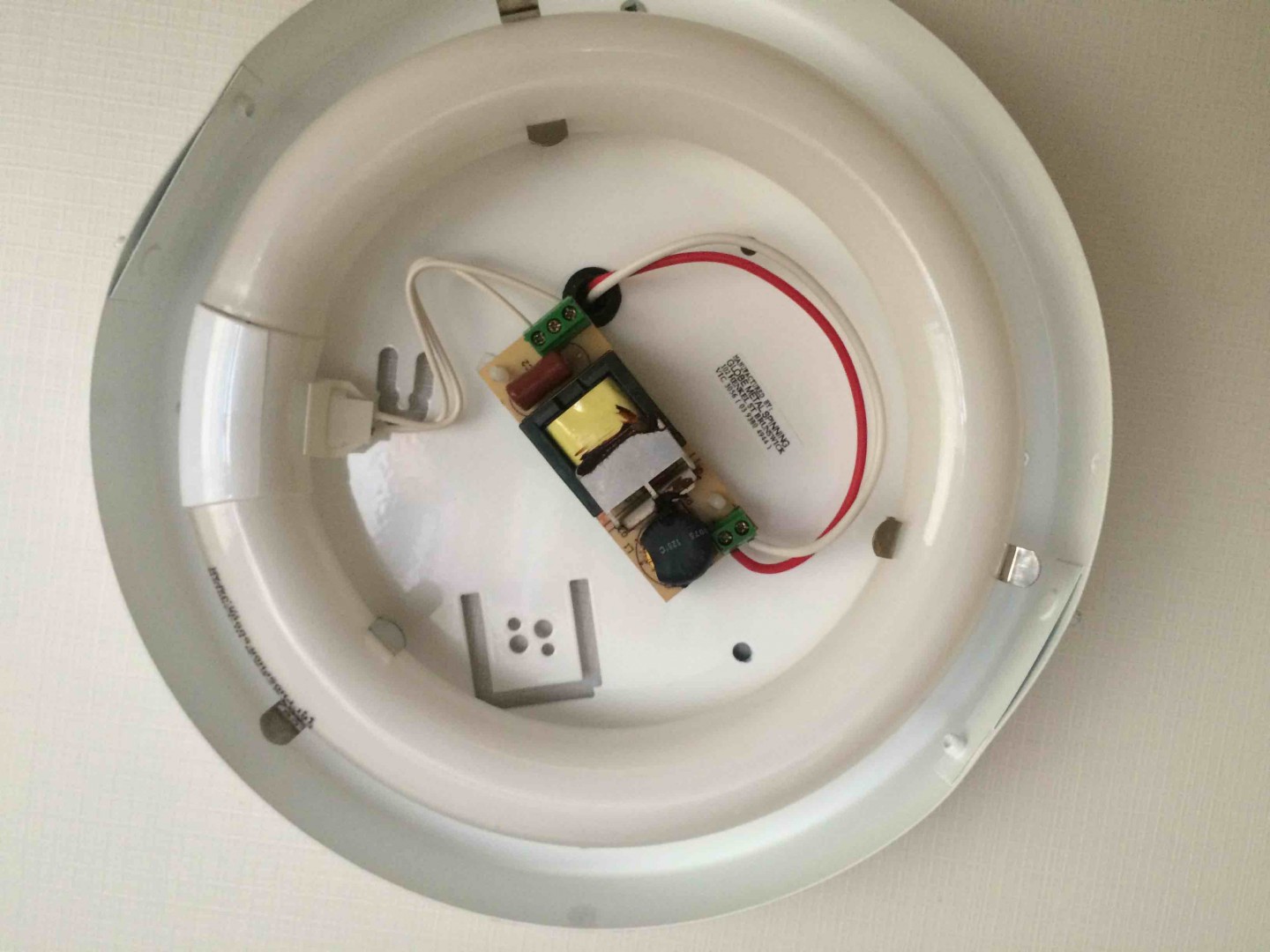

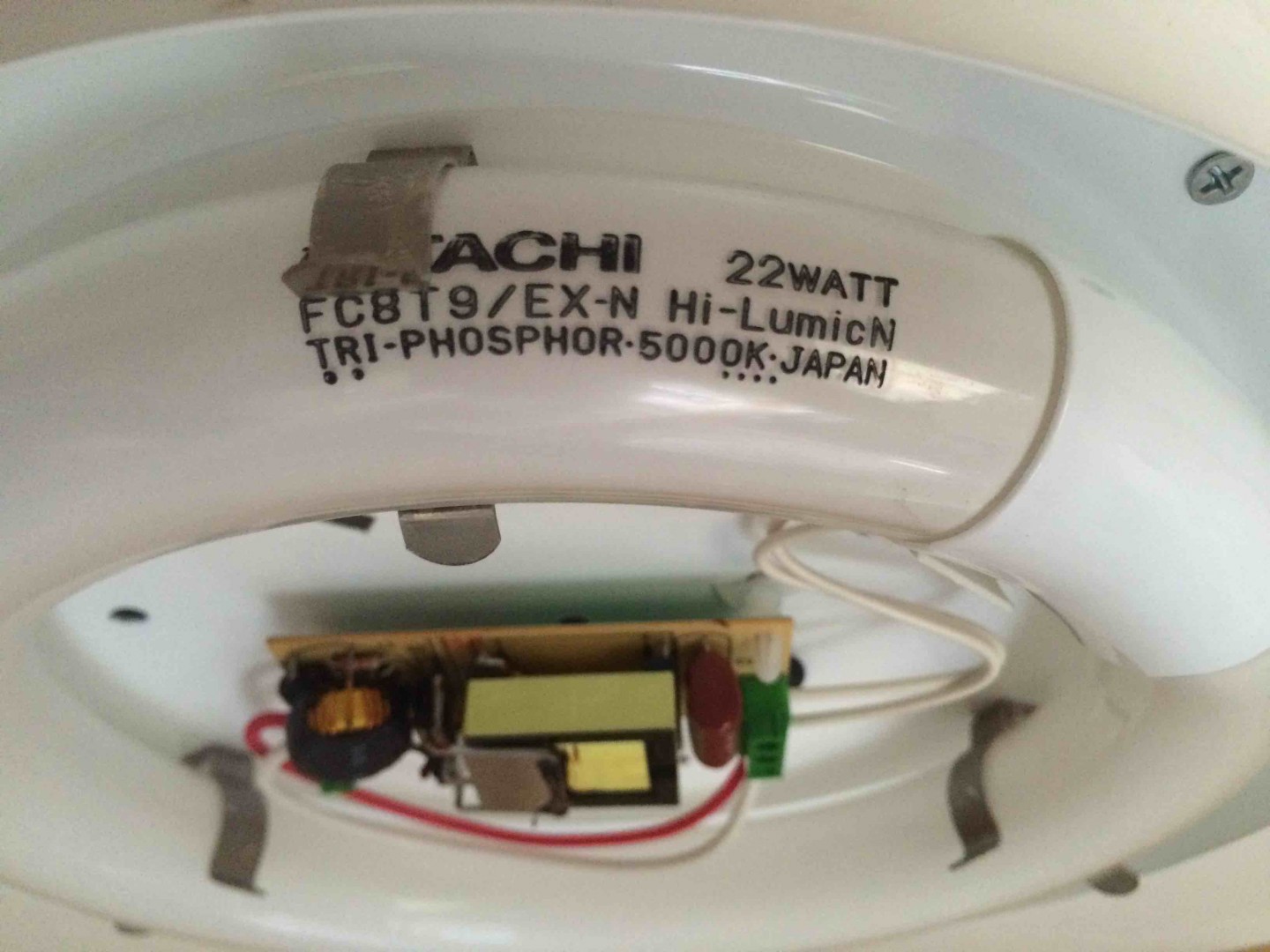

I have a 2005 Millard Horizon van which has fluoro lights fitted (see photos). I want to change these to LEDs but am unsure of a suitable LED light replacement to use. Any forum readers replaced this type of fluoro tube? Any tips appreciated.
Try Googling Replacement LED's for Fluros and there are lots of places to check out. Fleabay has many options based in Oz. I would assume the existing fluro is 12 Volt so any of the ring types would suit perfectly. Depends on the light intensity you need. Most require getting rid of the ballast and connecting the positive and negative directly to the power supply (12 Volt) You keep the same fitting.
Alternatively replace the whole fitting with one of the newer type LED panels Like Narva. A relatively simple swap. I swapped a couple of mine with the Narva Saturn slimline fitting. Good light, not too bright.
madaboutled said
12:46 PM Jan 29, 2015
Curryhouse, you'd certainly want to replace that one, Wow 22 watts.... The good news is that what you have would be an easy conversion not matter what LED you decided to use.
The Red and White wires going in will be the power, one + positive and one - negative most likely the red wire will be the + positive but you'd best confirm that with a multimeter. Thankfully the wires aren't soldered so its just a matter of unscrewing the terminal blocks to remove the wires from the circuit board. If possible I'd isolate the power before playing with it though, you could do that be removing the "lights" fuse or disconecting the 12 battery. Then its just a matter of removing the existing circuit board and the fluro brackets to fit up the new led.
You could use the panel like rocklizard suggested but you'd need to modify it a little to remove the socket and wire it directly and also work out a way to fix it in position. That could be done by drilling a couple of mounting holes into the plate and carfully avoiding the underlying circuits which can easily be seen. You may have to put in some spacers to ensure the circuits behind the panel doesn't touch any metal surface, but any modification may void any warranty. There are some similar panels on the market one is sold by BCF that doesn't have the socket and have mounting holes but in terms of light output you may get less light out of it than what the fluro will produce. Again I say MAY. Another factor to consider with these big panels with lots of LED's on them is if a few of the LED's go out or die you'd eventually have to replace the whole panel. That said LED's these days are very good and that may never happen.
Here a product that you may like to consider http://www.madaboutled.com/led-products/replace-12v-double-d-fluro I don't want to break the rules of this forum and plug my own site so if the link is removed just PM me and I'd be happy to provide it to you.

Hi,
Your fluoros look very similar to mine, if so, I replaced them with these LEDs.
[edit: just noticed your fluoros do not have the same mounting as mine had - the LEDs in the link probably won't suit
http://caravansplus.com.au/catalog/product_info.php?products_id=12686
-- Edited by rockylizard on Thursday 29th of January 2015 11:08:01 AM
Found this one - but it appears a Yankee site - http://store.marinebeam.com/led-replacement-for-12v-circline-fc8t9-8-fluorescent-tube/
