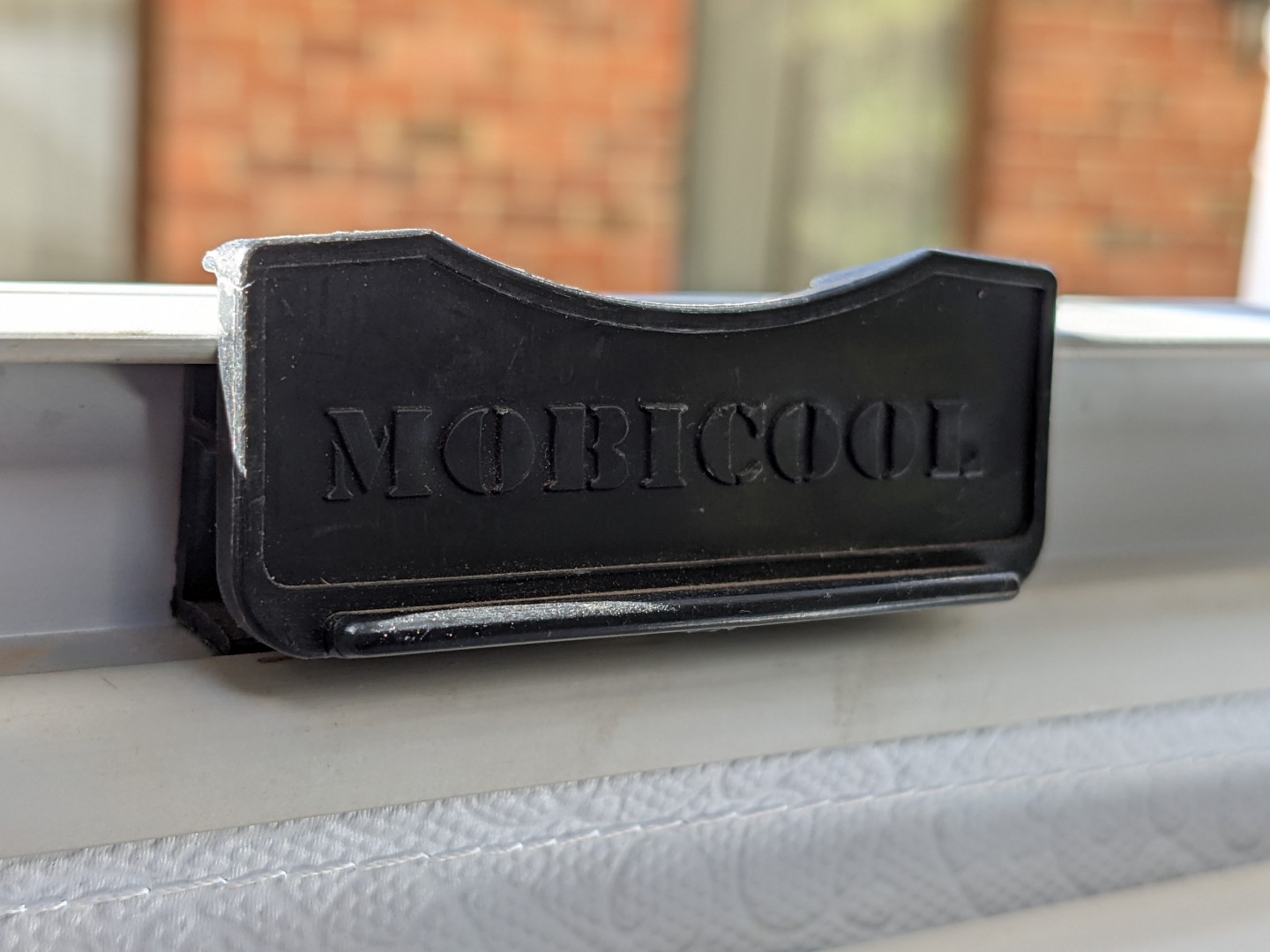

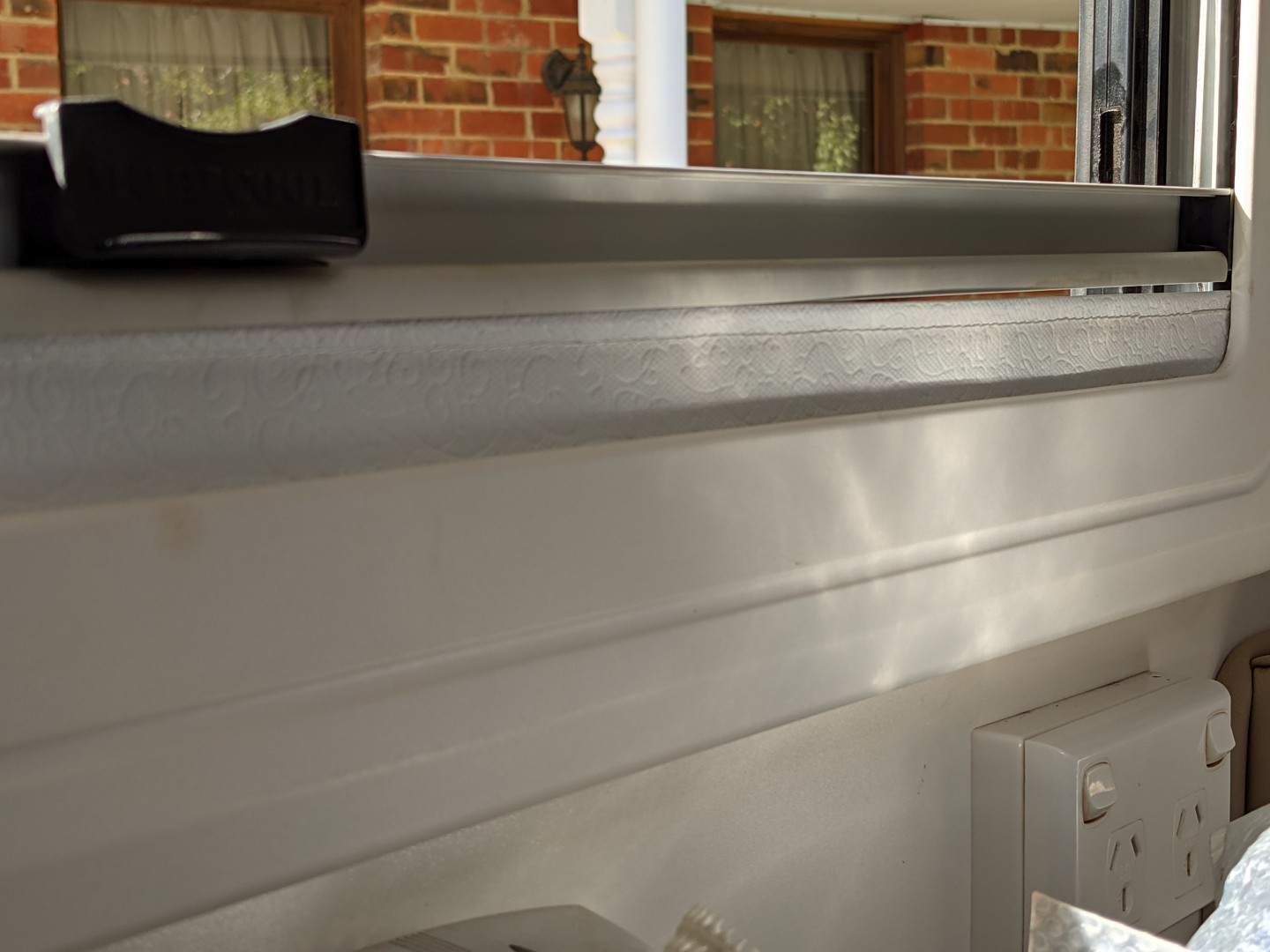

I have Mobicool window blinds/flyscreens that slide vertically. The problem I have is not the tension, but the blind fabric is escaping from the horizontal support. I imagine that the bound edge of the fabric can be glued back in the slot (with some difficulty), but is there an easy way to do this? There is no obvious way to remove the inner frame, it sits flush on the wall and there are no visible screws. I don't want to damage the caravan wall or the inner window frame by trying to remove it without knowing how it is attached. The caravan is a year out of warranty (thank you Covid lockdown). Any experience or practical suggestions?

Well 18 months later and one caravan trip. The blind failed again after just pushing the fabric back into the horizontal support; the rail that you raise or lower in the frame. This time I took the tension out of the roller and pushed the fabric back into the rail and ran a bead of glue along the fabric and rail slot on both sides of the fabric. This, I hope, should be a permanent fix. I don't know what the glue is, but my wife uses it in her craft work and the nozzle is the size of a hypodermic syringe making it easy to get inside the slot where the fabric is supposed to stay.
Edit: I almost forgot. An internet search revealed that the inner frame is clipped on to studs used to fix the outer frame in the opening. There are 14 clips on my smallish window and a paint scraper (thin, wide metal) slid under the inner frame against the wall makes it an easy job to pop the inner frame off.

I had a bit of guitar string that I glued into the horizontal gap to hold the mesh in place when mine came adrift. has worked a treat
