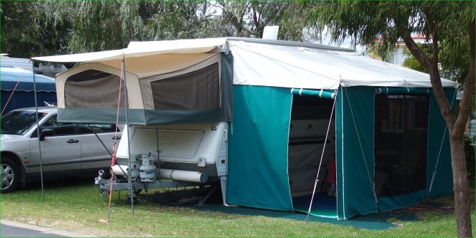

I must have a different screen, however I checked out the "Aussie Traveller Coolibah" web site. That camper trailer would have been very similar, and I rechon he took longer to put it up than the time I took to put up mine. However it has occurred to me that I have asked an unfair question. In as much that 90% or more of you would have purchased the van and guess what the awning comes as standard inclusion. This means that what ever you do, adding an annex is a modification of the existing awing. Where as, I am talking about a full purpose built annex as opposed to an awning modified to except walls. Therefore the majority of you will have no experience in comparing the two. I have to apologize, I am sorry that I dare to question everything the salesman throws at me, I've done it on solar panels, Digital TV, and will continue to question until I am satisfied. So I'm sorry that I am being different. PS I used to work out the back of a shop, and used to get a kick out of asking the sales guys "How do you tell if a salesman is lying -- answer his lips are moving"
deverall11 I agree with what you saying. An awning is no different to a sail.
As you can see, my extra room was very similar to the video clip. But it was purpose built.KFT you are telling me "pooling" can occur, and what steps you have taken to reduce the risk.
-- Edited by iana on Saturday 24th of January 2015 04:09:32 PM

Iana,
pooling can happen with any of them if not set up to allow water to run straight off. Either by additional support as in the curved rafters or setting it up with a slope to one end (in the case of an awning)
If your setup will be like the picture you posted I don't think you will have an issue looking at the fall on the roof of that annexe.

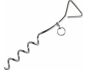

When pegging your awning down - the longer you can go into the ground the better - we are camped near a lake and there is wind nearly every day, not too bad, but enough. Our awning does not move, we have a double rope and a single rope on each end and the ropes are attached to some long bolts, with washers on the ends to prevent them slipping through. These bolts are drilled it with a drill, and taken out the same way. We have been in some pretty high winds, and the awning does not move at all, we use anti flappers as well. Anywhere you have to peg something down, these bolts are the way to go - will put a picture of the bolts - they are 250mm long.
-- Edited by jules47 on Monday 26th of January 2015 11:21:12 AM
From my experience, and we lived in that camper-trailer for 18 months, around Perth and up the coast, you need a variety of pegs and fastenings as the ground can change so much between camp sites, and you are really up sh---t creek if you happen to have a concrete plinth where your pins should go.
I carried the normal pins which I used two per guy rope and they were crossed over each other. I had much longer and heavier pins as well. Plastic triangular pins and also the screw in types that one would use for tethering a horse or dog, or tying up a boat to the beach. If you are in pure sand they are the way to go.
I carried a drill and masonry bits to get through the hard surfaces.

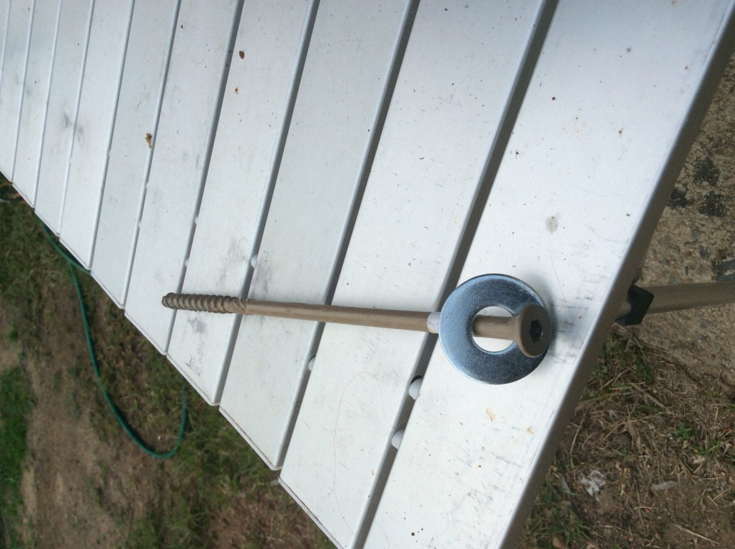

jules47 those screws would also be the bees knees for holding down the foot plates on the "Roll out" awning posts.
05:37 PM Jan 26, 2015
Ian - the screws would work well on the foot plates, but as we don't have an annex as such, we leave them attached to the motorhome, the triangle is actually stronger than the straight legs - so I have been told by "experts".
Camper trailer we used to have was bad for pooling water, till we got some pole to put in the middle of the roof - nothing worse than lying in bed, looking at the water pooled above your head, and afraid to sit up in case you touched it, and the roof started leaking. Never happened, but made sure of it with the poles across the roof. Our was a soft floor type.
aussie_paul said
06:52 PM Jan 26, 2015
I have not been able to find these length screws Jules47!!
08:18 PM Jan 26, 2015
Look for a place Coventry Fasteners, they may be able to help, though Yeoeleven got some 200mm ones, and they seem to be ok. He got his at the Big B. Ours came from a small hardware shop.
They are good in most types of ground we have found, including softish sandy ground.
iana said
08:58 PM Jan 26, 2015
Coventry fasteners is now called Konnect Fasteners. In sandy or loose soil I used these.

Still I never got any input from anyone with a purpose built annex. But by going back to looking at the bigger van, then an awning is pretty much all I'll need.
The camper trailer has been sold months ago, but the annex was a handy extra room while we had it.
We had wind at Corrimal last week. I thought I was going to lose my awning but managed to get it in without damage. I have guy ropes on the ends but the movement was scary. The bloke two sites down had a similar awning with an annexe and while the walls billowed in and out as the wind swirled, there was no problem. The wind couldn't get under the roof.
The roll out awning is good to build an annexe under, but make sure it's sealed and you use guy ropes and long pegs.
PS We used to carry an annexe for use on long stays, then we got a bigger van and don't need one.
-- Edited by KevinC on Monday 26th of January 2015 11:02:33 AM
I also had a system where if the annex was to be erected over a concrete plinth, I would stretch steel cable (very light) across, and passed through the rings on the bottom of the annex, pegged under the sides of the concrete, then tensioned by turn barrels, this worked quite well in those circumstances and in high winds.
The worst time I experienced with the weather, with permission from the park manager, I dyna-bolted angle brackets to the plinth, and then used two hose clamps per post to secure it down. While three houses lost their roofs, we survived.
Camper trailers like the Jayco Swan do not like the wind, and the annex actually strengthened and made the roof of the trailer more secure.
Twice I had the annex smashed in, probably because of water pooling and the wind. Once a post etc. goes the integral strength of the unit is lost.
