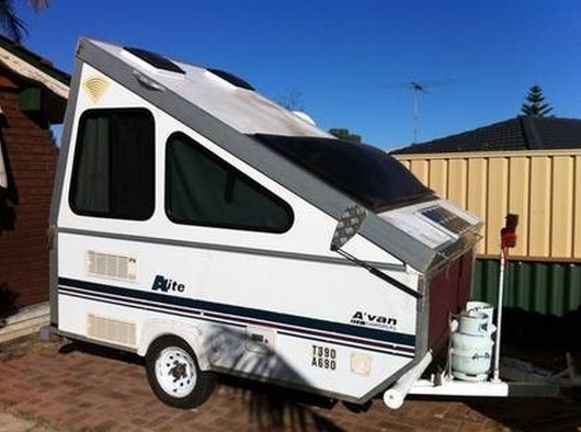

Weevil said
12:20 AM Jan 15, 2015
Hi Happy Traveller,
If you look at this A'Lite A'van, you will see where it has had gas struts fitted to help raise the roof.
Although smaller than bigger A'van models I can't see why it would not work with them.
Perhaps take your van to a strut fitter and see what they recommend.
