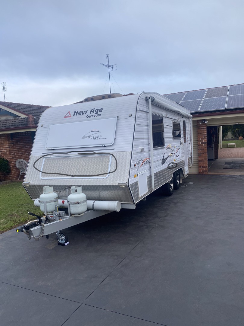

I understand that this is an old post, but hopefully someone will look at it and help me.
I have a 2011 New Age Big Red 19. There are two panels on the roof (unsure of size) running through a Plasmatronics PL20 solar controller (yes ancient but still doing its job until I one day upgrade to lithium.
I want to buy a portable solar panel to bolster my solar input when off-grid. I have a grey Anderson plug on the side of the van, no blue plug from what I can see.
1. What are good brand portable panels
2. What size should I get
3. Can I plug direct into grey Anderson plug
4. Will I need a panel with a mppt controller attached
5. If I wanted to move the panel following the sun some distance from my van what cable should I attach to panel/controller
Im very new to this, so I hope I have explained my situation correctly and asked the right questions.
Any help will be appreciated

I think you are approaching this from the wrong way.
What are your loads. How many AH do you have. What is the solar input, at least measure the surface area without falling off a ladder, to get some idea.
On our last 3 month trip we didn't use the solar panels once. The DC-DC charger was ideal as we only stayed put for a maximum of 4 days.
The length of cable is determined by the cross sectional area & the total distance of both + & - so if you want to reach the sun at 12 metres, it is 24 metres. Not to forget the wiring in the van. You can always use your jumper leads for extra reach.
There is nothing wrong with lead acid batteries unless you have payload issues, but quite frankly throw some rubbish out first.

Hi Shakey, to answer your questions:
Have a look at the Ridge Ryder Solar Panels at supercheap, they will do the job. You'll have to decide if you want a rigid or flexible panel, around 150--160watt will do. They also have made up extension leads, 6mmsquared is ample for a 5metre lead.
The grey Anderson plug may be a 12volt supply or it may be an input to your solar regulator. Get it checked out. You need it to be an Input to the Pl20. I installed an Anderson on the drawbar (using 16mm squared cable), found it was ideal, just move the panel around following the sun.
I would upgrade the PL20 to an MPPT, ensuring you locate it adjacent the battery/s. Some of their (Supercheap) panels come with an included MPPT regulator.
Note: it is worthwhile joining the Supercheap club (if your not a member) save heaps.

Hi Shakey,
Firstly, if you follow the grey Anderson plug back to the van you will find that it should lead directly back to the battery. Any portable panel will require a solar controller to be attached, preferably close to this point. What I have done is just put a short cable with Anderson plugs on the battery and solar terminals for easy connection.
You say you want to just add a bit more solar so I'm guessing that your batteries are big enough for you but you just want to top up with a bit more power quicker. So now to your questions.
1. This is a buyers minefield as what is good for some is not considered good enough for others. Plenty of users find that the cheaper brands provide what they want so it comes down to personal choice. Suitcase style panels may be too bulky and heavy for you, I do not know, so if they are then you could consider solar blankets but they have their limitations also. Some people will buy two of these as they know the output isn't great but they are lighter. It all comes down to personal choice so tell us your preference and we will see if we can help. If you go into places like BCF, SuperCheap and Anaconda go pick up a box with a panel in and it will give you an idea of weight you will be carrying in and out of you vehicle.
2. Size, again that depends on how much extra power you want, the weight and choice of panels.
3. No, as I stated above you will need a solar controller. Most that come with portable solar panels are PWM controllers or just cheap, not so good, MPPT controllers. For value for money buy a Renogy or EPever 20A solar controller or if you want to pay out extra then buy a Victron. I have an EPever and a Victron plus numerous other cheaper controllers. All will do LiFePo4 when you change over.
4. See above.
5. Buy 10m of this cable from Jaycar https://www.jaycar.com.au/25a-2-core-tinned-dc-power-cable-sold-per-metre/p/WH3087 or https://www.supercheapauto.com.au/p/narva-narva-automotive-cable-twin-sheath-10-metres-50-amp/532513.html#q=Narva%2B%2Bcable&lang=en_AU&start=4and make 1 x 5m lead, 1 x 4m lead and the pigtails for the solar controller. Anderson plugs can be bought at Jaycar or Supercheap or Bunnings.
Any question come back and ask.

shakey55 said
05:56 PM Sep 26, 2022
The solar panels, batteries and compressor fridge were attached to van when I purchased it.
So, if I have this right, the brains trust are telling me that the solar panel can be plugged into grey Anderson plug, but the solar regulator (preferably a MPPT) needs to be close to the battery. You will see from the attached picture that the batteries (3 x 120 amp agm) are in the front boot area and the grey Anderson plug (as marked) is on the near side of the van.
There are two solar panels on the roof (I think only 100 watt).
I have a 165 litre Mishto compressor fridge; Specifications Type 165L Fridge Freezer Compressor ALPICOOL Refrigerant R134a 45g Rated Power 75W 240V consumption 0.17kWh/24hrs 12V consumption 80A/24H approx Max. ambient temp 38C Foam vesicant C5H10/C-pentane Temperature drop 30 degrees Power Input 12/24/240V
So is it going to easier to connect portable solar panel with good quality MPPT regulator direct to the battery bank.
I can't see where anyone has said that Shakey, and we have given you recommendations.
You shouldn't connect a solar panel directly to a battery. You need to chase where the Anderson is now connected, to the batteries or to the PL20. It may be the case that the previous owner has used a portable panel.
Replace the PL20 with a quality MPPT.

Hi Shakey,
Well you have a few alternatives but the common thing is that you will need to install your solar controller in the boot along side your battery.
You could just have a pigtail connection on your solar controller and run your cable to a portable panel leaving the boot open. Alternatively run a cable through the bottom of the boot to an Anderson fixed on the drawbar. There may even be a drainage hole for you to run the cable through.
I take it that your grey Anderson plug that connects to your tow vehicle is running through another system. Do you have a DC/Dc charger installed?
If the Anderson plug at the rear is connected directly to the batteries you can disconnect it there and put your solar controller in between. The issue is that you have a few meters of cable run that add to voltage loss and you are not actually getting any distance away from the van.
Beware of the portable solar panels on EBay. XTM from BCF are a reasonable quality and I did test one of their solar blankets that gave good output. The larger panels are quite heavy so you will have to consider the weight.
It has a PWM solar controller and you will have to consider whether that is suitable for you. An MPPT controller will get you slightly more power but at considerably more cost. No Idea what the XTM ones are like from BCF but as I previously said I have an EPever and a Victron.

Ok if you have limited funds look at the panel from BCF and use the PWN controller that comes with it. It also comes with a 5 metre cable. That will work for you and then in the future you can consider whether to upgrade the solar controller.
Simply plug it into the grey Anderson plug at the rear.
You can then look at other options in the future.
Or yes make up an Anderson plug and connect directly to the battery. Then connect the solar controller and run a cable from there to your solar panels.
Tim
