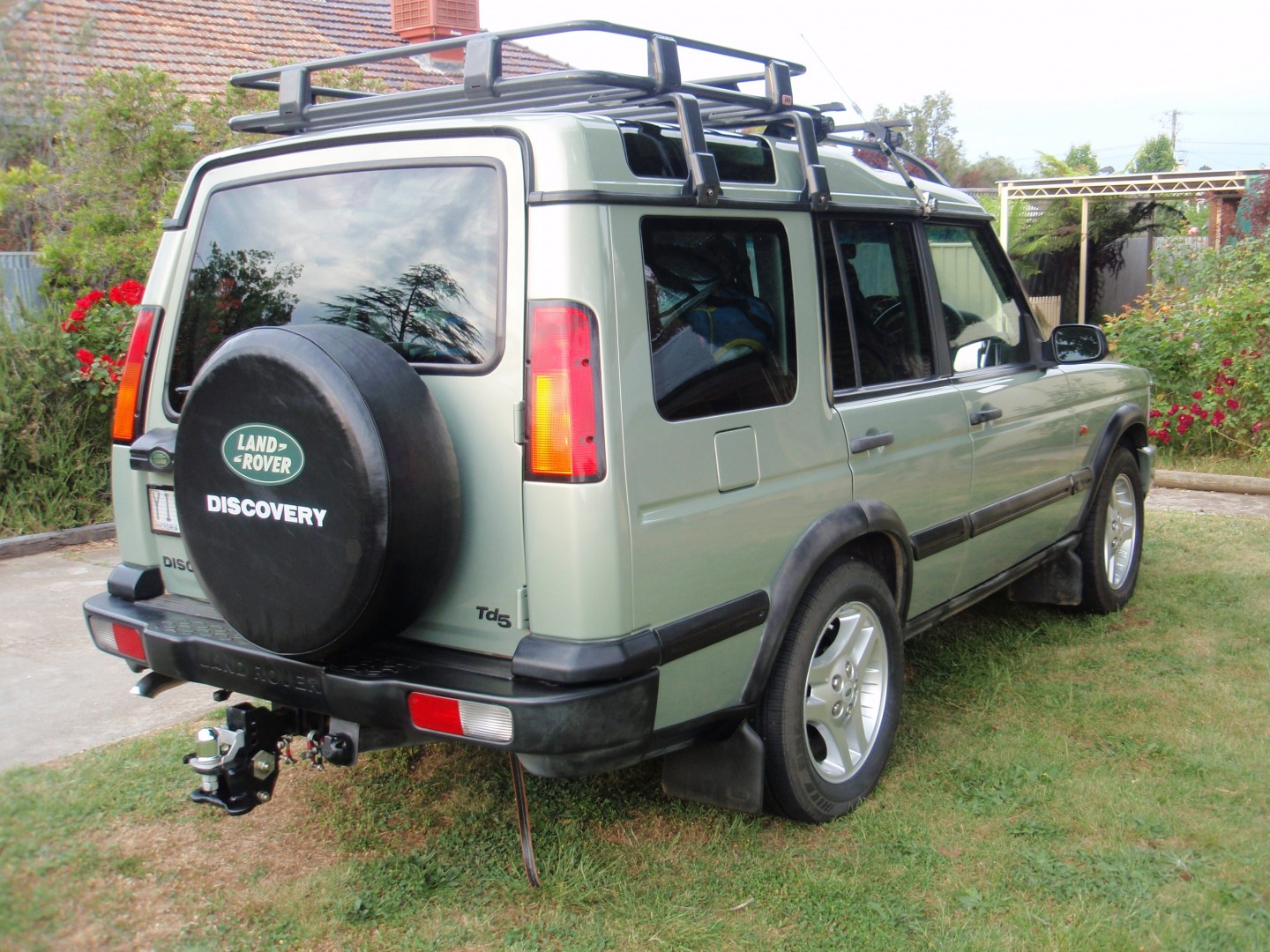

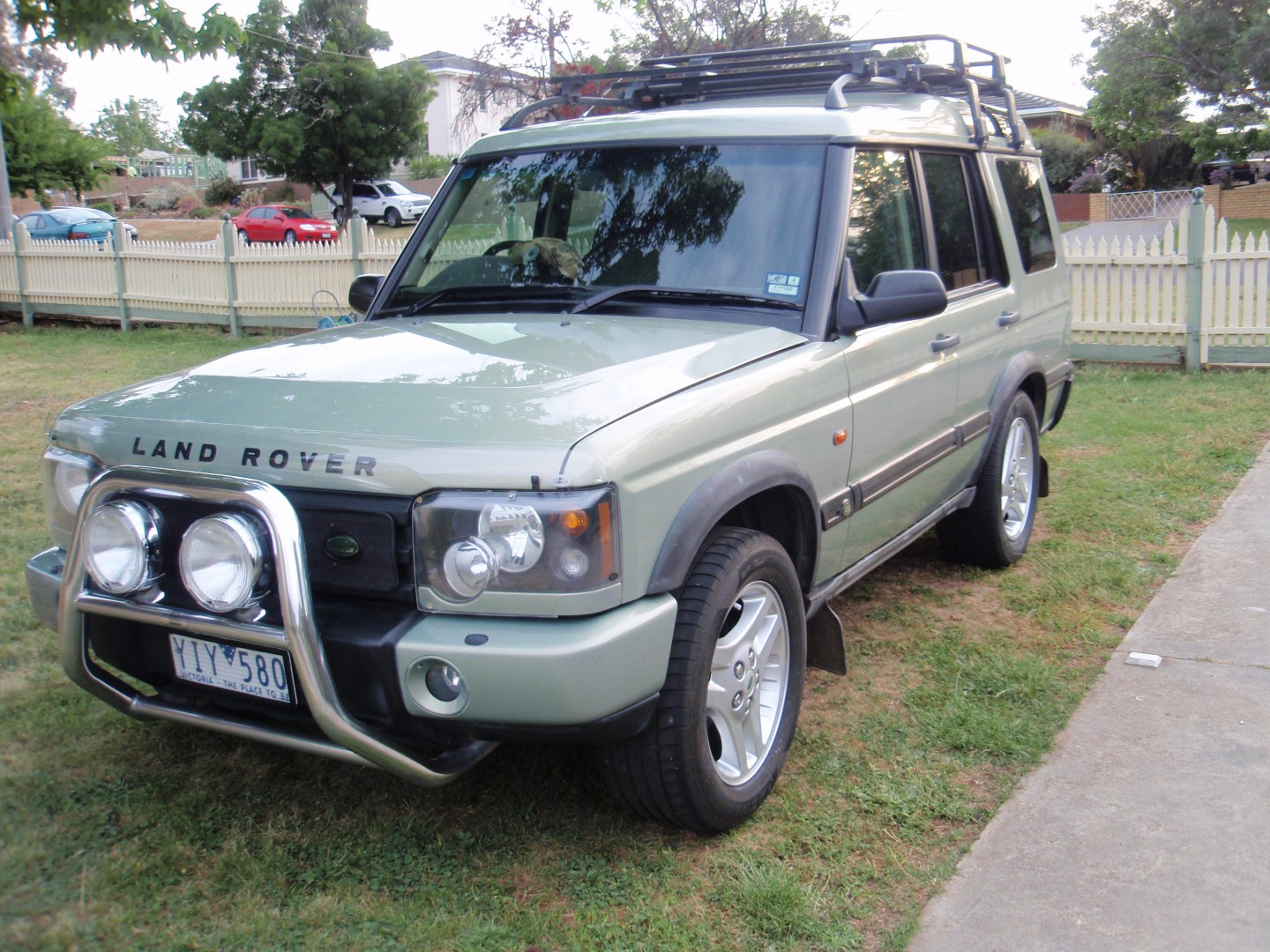

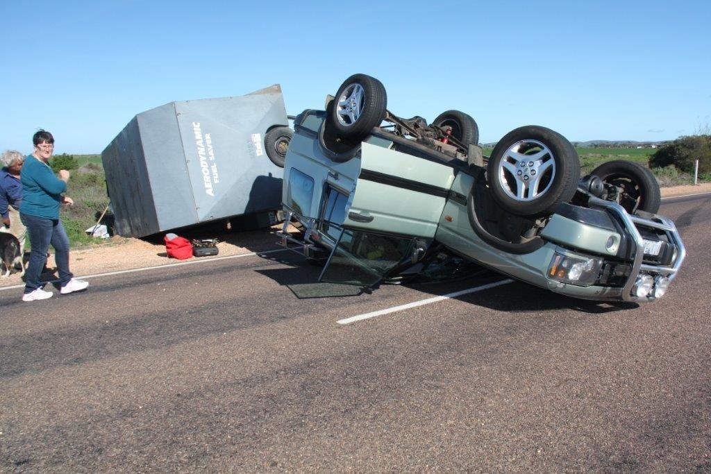

My beloved Disco 2 TD5 >5 pot> Automatic had the power to pull my 19' Heritage, and sundry Horse Floats/Trailers faultlessly.......while it remained upright......I had also fitted heavy duty springs and upgraded shockers front and rear so there was no rear sag..plus 18" wheels......high cross winds and a tandem trailer blowing a tyre brought me undone....they are an excellent vehicle and I miss mine....especially the armchair spacious view of the road....it is inherently a safe vehicle amply demonstrated by apart from the glass splinters I was totally protected in that roll over, hanging upside down in my seat belt for some 20 minutes, whilst I was extricated...the cabin strength did not allow the roof to crush my head..there's plenty of cars on the road I would not like to take my chances in, in similar circumstances...<I was still in the vehicle in that second photo, and the motor was still running as I could not reach my keys to turn it off initially>..
Only problems inherent in the Disco2's is most suffer from oil leaks to motor or transmission or both...it is a rare Disco indeed that is clean of oil underneath in both areas....and the 'three amigos'..three warning lights with your ACE coming on intermittently will drive you crazy..google 'Discovery 3 amigos' and you will know what to expect.....you have to be committed somewhat to drive a Disco2.....Hoo Roo
