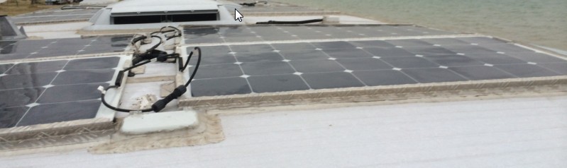

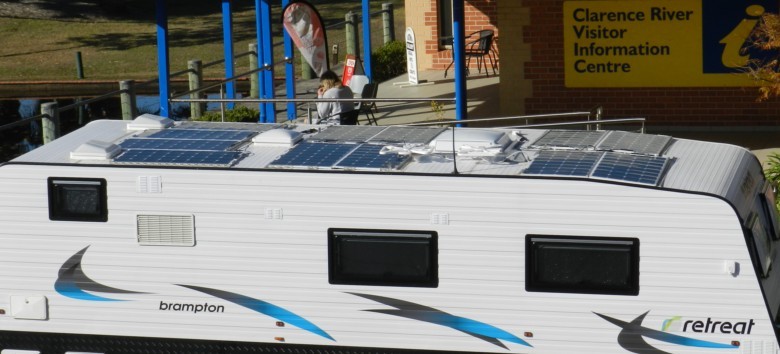

Hi Ian, I doubt if you will ever achieve a drag free roof, but using light weight panels mounted down close to the roof may help.
The two images below show the roof of our van, the solar is mounted down close to the roof, and the air con is gone, replaced by a split system mounted on the back bar. BTW, it is cheaper to go for a split system than a roof mount, they are much cheaper to buy, and easier to fit.
I do realise that mounting the panels on top of 10mm of insulation as we have done traps the heat in the panel, and reduces the efficiency of the panel. Our panels get to about 75 degrees, and by then they are only about 80% efficient, add this to the fact they are sitting flat, and efficiency probably drops to about 40% across the day. We overcame this by having more panels. There are twelve 100W panels on the roof, and we are typically back to 100% charged mid afternoon. If we have used the air through the day, it may be later.

iana said
05:30 PM Jan 3, 2015
The amount of drag produced by the back of the van being "sawn off" would be massive, and yes to produce a drag free roof, would be asking a lot. You would agree that the air con is quite a drag producer, and I agree you have gone along way to reducing the effects of drag over the roof.
It would be interesting to find out how many travellers have converted to domestic air con's and what if any problems they have had. I may have to start a separate tread on that.

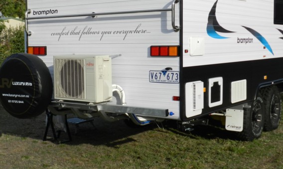

Plendo
Thanks for photograph of what I think is the split level exchanger on the roof. If we removed the high a/c on our 34' (10 m) fifth wheel, we could install two more x 235 W panels.

Plendo said
10:37 PM Jan 4, 2015
Reed wrote:
Plendo
Thanks for photograph of what I think is the split level exchanger on the roof. If we removed the high a/c on our 34' (10 m) fifth wheel, we could install two more x 235 W panels. Reed and Elaine
Hi Reed,
it is a long time since I have seen you on the forum, sorry but there was no AC on the roof at all, just solar panels (12), vents (4), and a TV antenna. The compressor part of our split system is on the back bumper, see below:
Thanks for posting the photo. We have plenty of room on back and front of our 10 m 5th wheel to mount such (one for bedroom and/or livingroom. This would free up the roof for 3 more 235 W panels (son buys them by the multi-pallet load and cost him about $.50 US or less a watt. The Dometic A/C is an energy hog at 1750 W.
Next question: How much energy in watts does a split level require.
Reed and Elaine

Hi Reed,
Next questions:
What does the heat exchanger look like on the inside
Currently, we are not moving much. Still have problems resolving issues with Mexican customs from wreck of 21 months ago so we are not going to Mexico, Belize and Guatemala again till next year. Will just fly to Ecuador and Peru since Machu Picchu and Galapagos are the top two on Elaine's bucket list (and we are 74). Have a friend from Army Ranger days who lives in Paraguay and might visit there as well. Two of our best friends shipped their pickup camper to Columbia and got totally lost in the mountains at 12,000' in cow pastures - have shipped pickup camper back to Galveston, TX and will be headed down into Mexico. Did 8000 miles in the US Northwest (Olympic and Glacier National Parks, Blackfoot Reservation, family and friend, and then spent the rest of the year with both sons and daughter. Such days do not come back.
