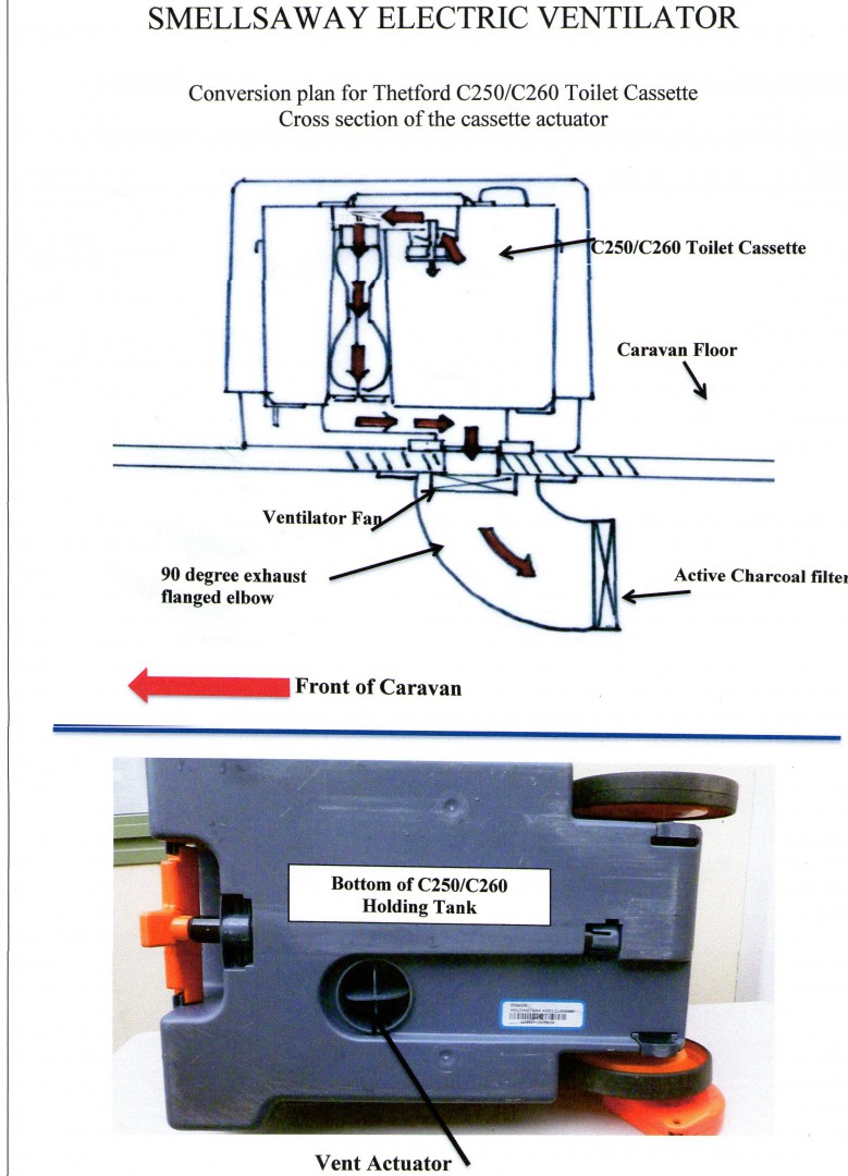

Hi just reading your post on toilet ventilator for C250/260 cassette I put one in my van ages ago designed it my self so now I sell them to the caravan owners Ill put up a pic

This guys has made his own and it's worth having a look at his version of the Fridge Fan.
http://www.dreampod.net/boroma/toilet_vent.html
The problem with that system is that the smell stays in the cassette compartment until the fan is activated as the lid is always open
