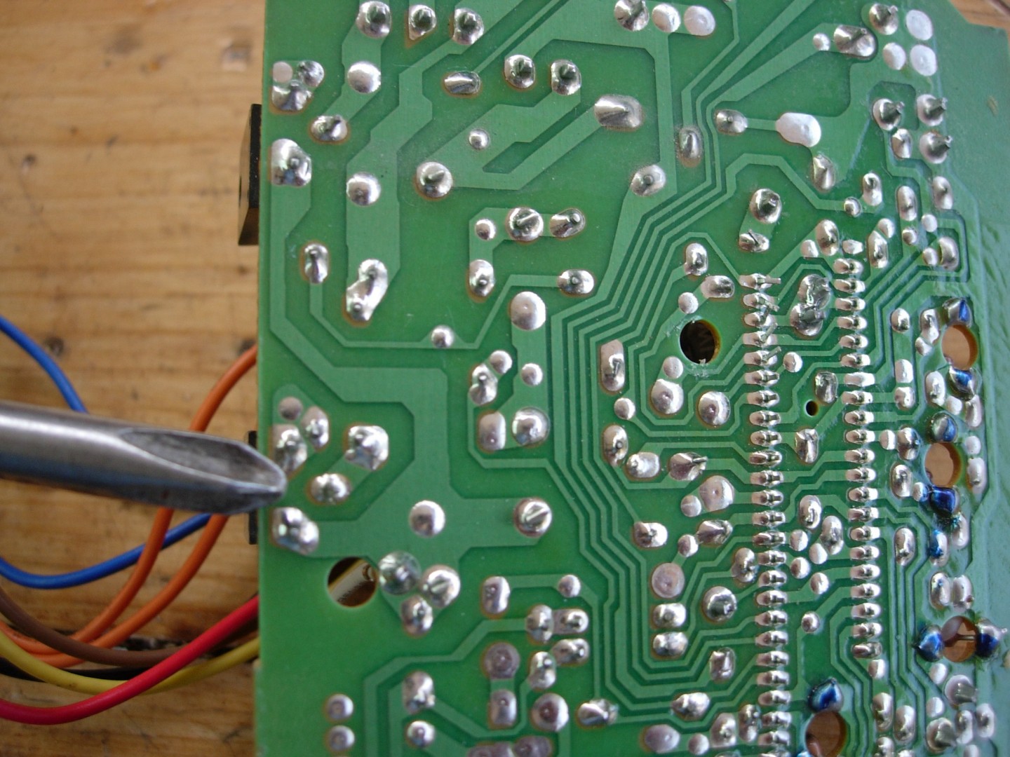

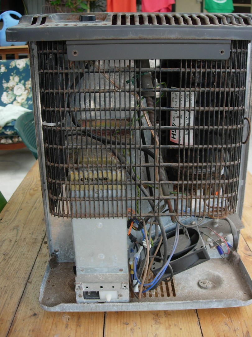

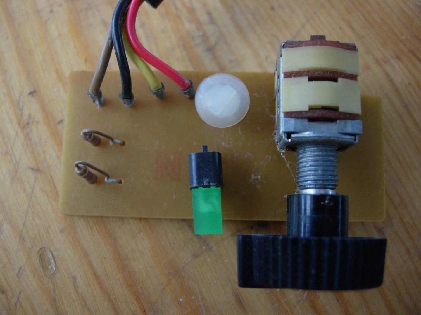

A friend was given 2 Engel fridges. One was a worker & it didn't have the 12V DC lead & he wasn't prepared to pay $50 for a lead. He was going to permanently wire a 12V lead to the Fridge. I decided to investigate Why Engel had a slide to cover the 240V AC socket. Well when run on 12V dc theres mains voltage on the socket as its using a common transformer for the 240V, & as a 12V inverter to power the compressor.

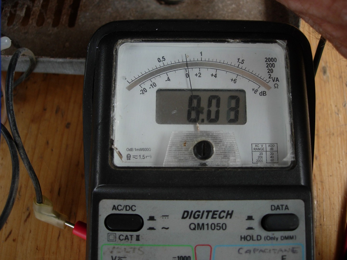

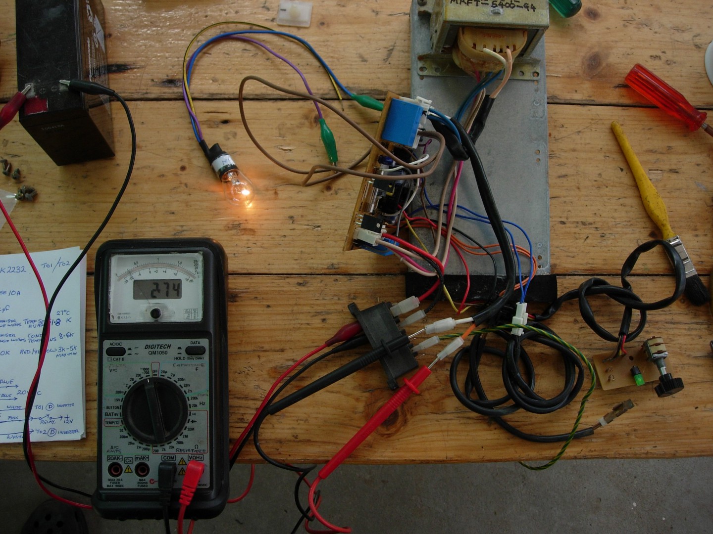

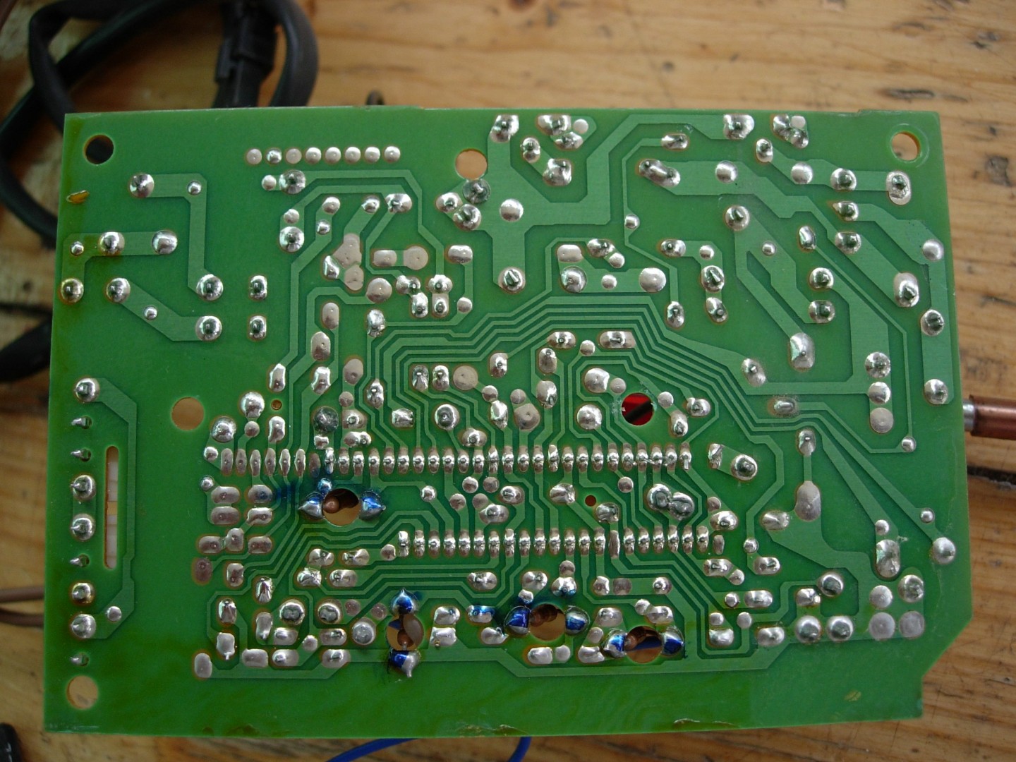

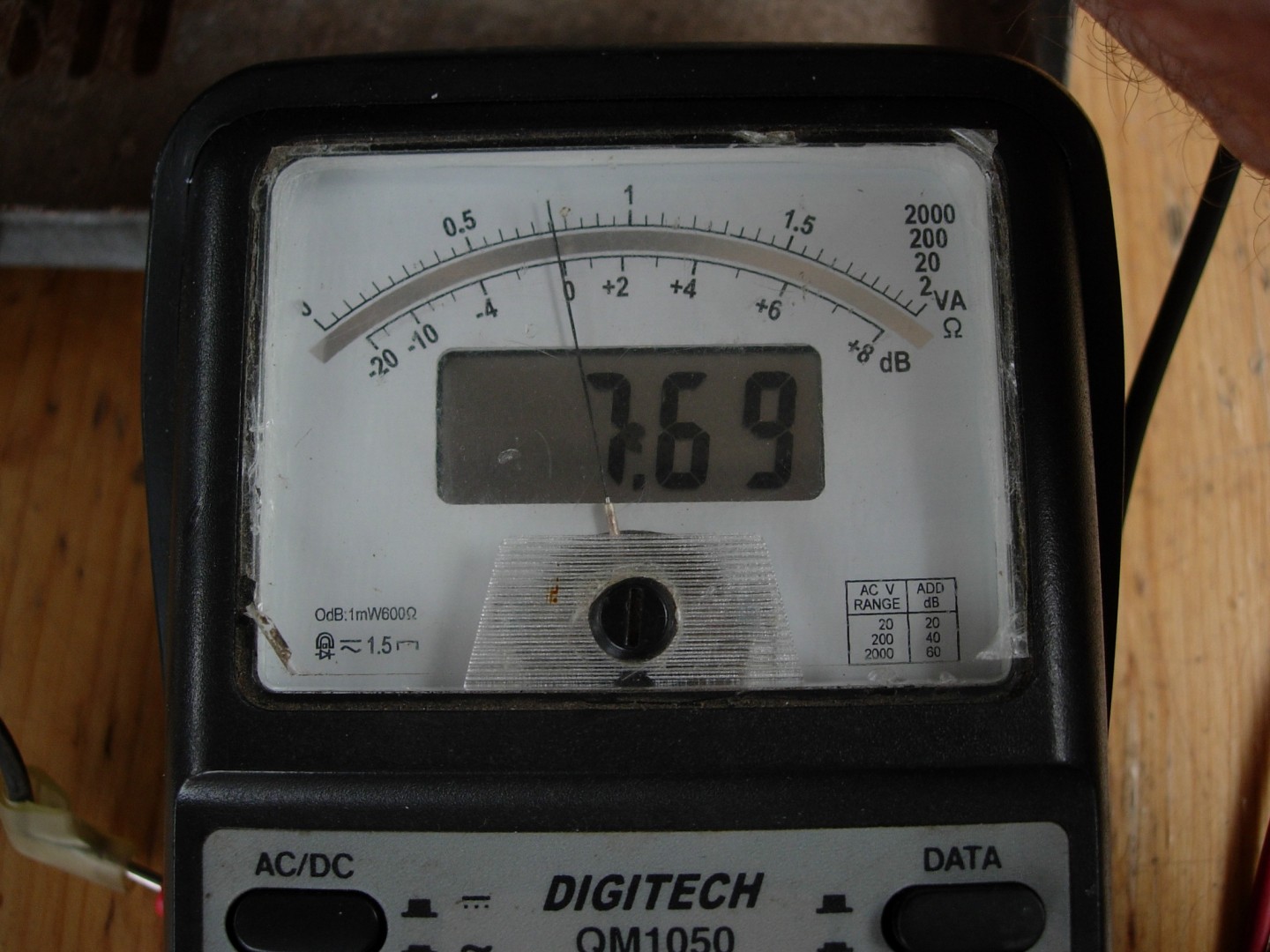

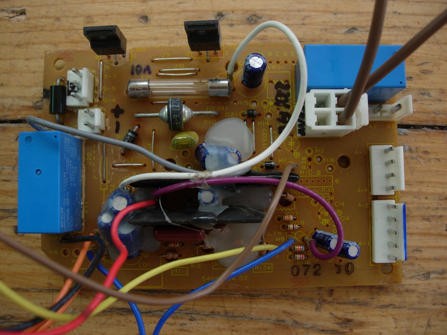

Now the reason for dismantling the fridge. The compressor is faulty & was drawing 7.69A & pulling the 22V rail down to 8V. So not worth repairing, but thaught was worth investigatin an Engel fridge.
Great pictures DeBe.....being non qualified in electrics and refrigeration I'll stick my neck out and ask how will you combat the corrosion on the condenser tubes before they rust through?
DeBe said
05:41 PM Dec 28, 2014

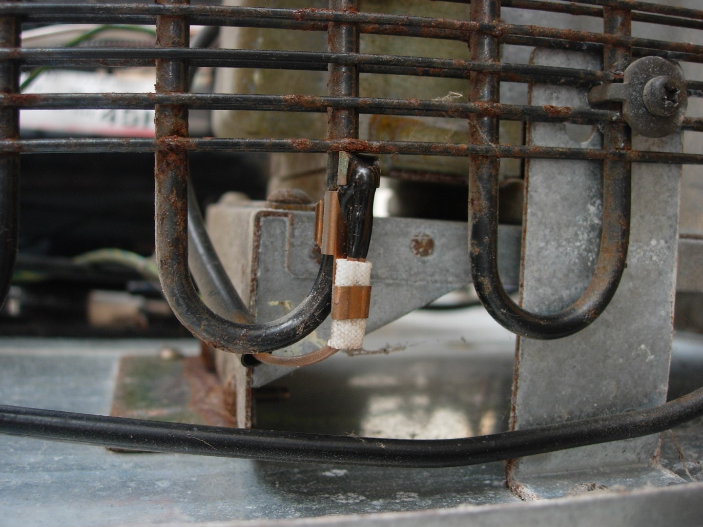

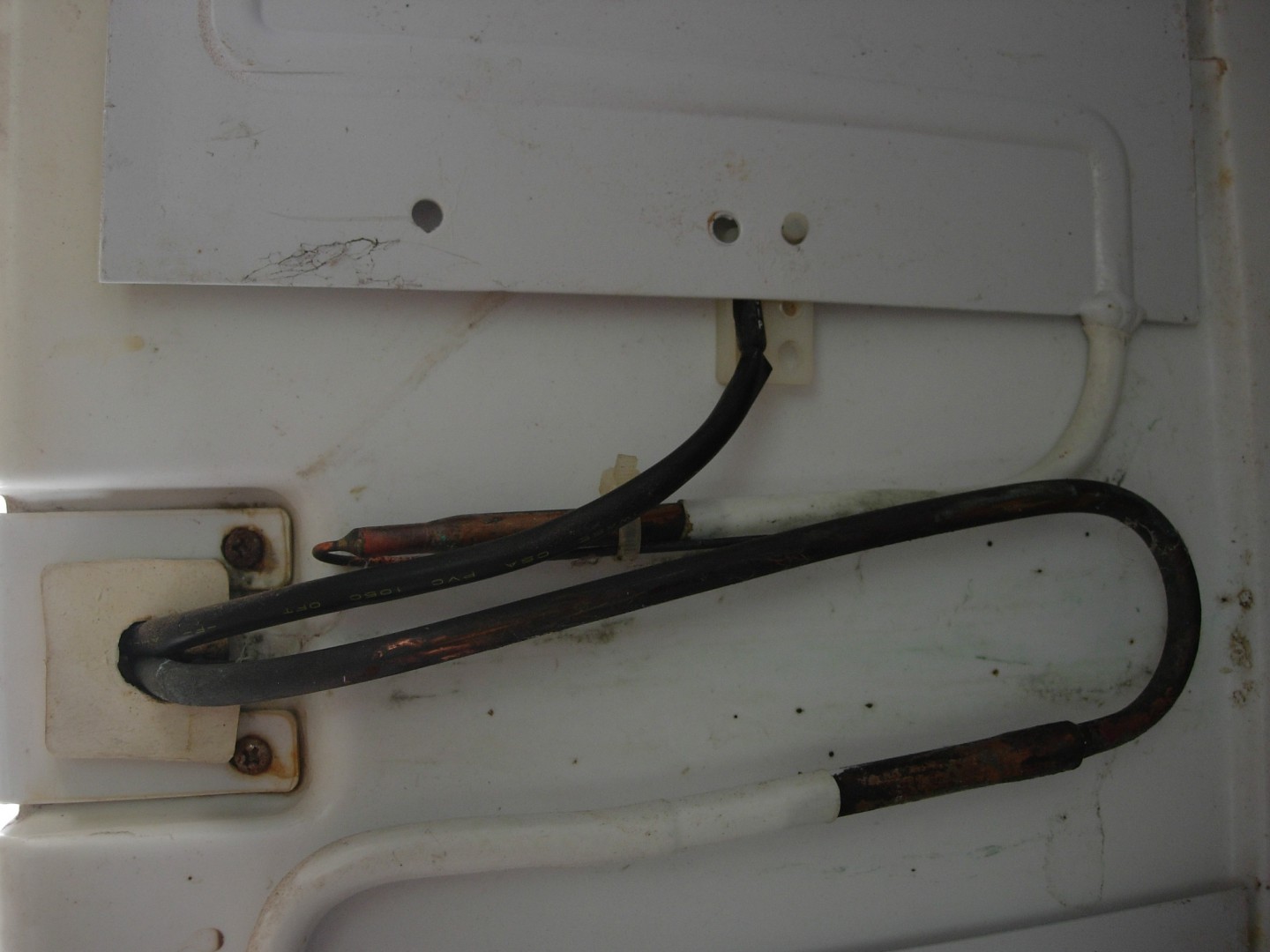

Wire brush them & spray paint them before they get to the state of the ones in the picture.
DeBe said
05:45 PM Dec 28, 2014

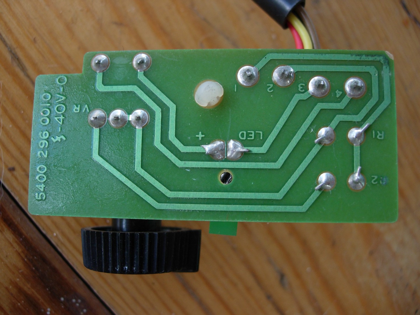

If there is going to be electronic problems, they are most likely to be where the switching FETs are soldered to the circuit board. Or the relays & power lead sockets on the circuit board.

DeBe said
09:09 PM Dec 28, 2014
Not quite ive onlyever had one that was charged, but still always check. Those are from powersupply capacitors that had 375V dc on them.

09:11 PM Dec 28, 2014
....and if it were the rusted tubes in the picture what would be the course of action?

DeBe said
09:45 PM Dec 28, 2014
Probably wire brush & use Kill rust paint & hope for the best. The pipe work is only Bundy tubing cheep & nasty, used on Engel Waeco & most domestic fridges & freezers. Evakool use copper tubing on there condencers.
Thanks DeBe, as always your replies are straight to the point.

Taking pics of circuit boards for clarity was done in natural shaded light. The camera was a Nikon Coolpix 4200 (only 4Megapixels) using Macro feature. Very cheep camera $5 at a garage sale. If you look closely there is quite a few degraded solder joints on the PCB that were about to give problems. When asking for help on a forum good clear pictures are generaly more helpful than a description.

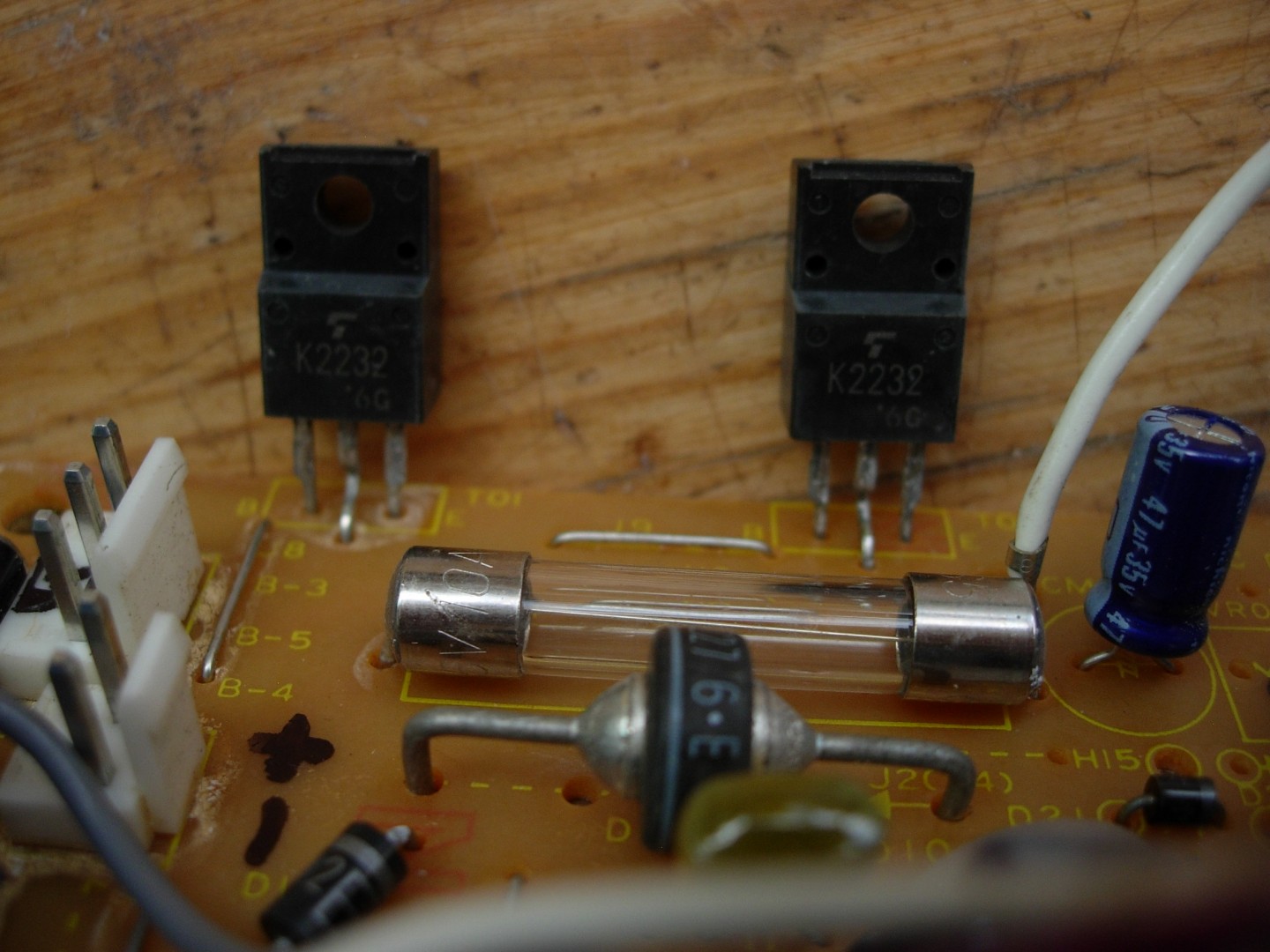

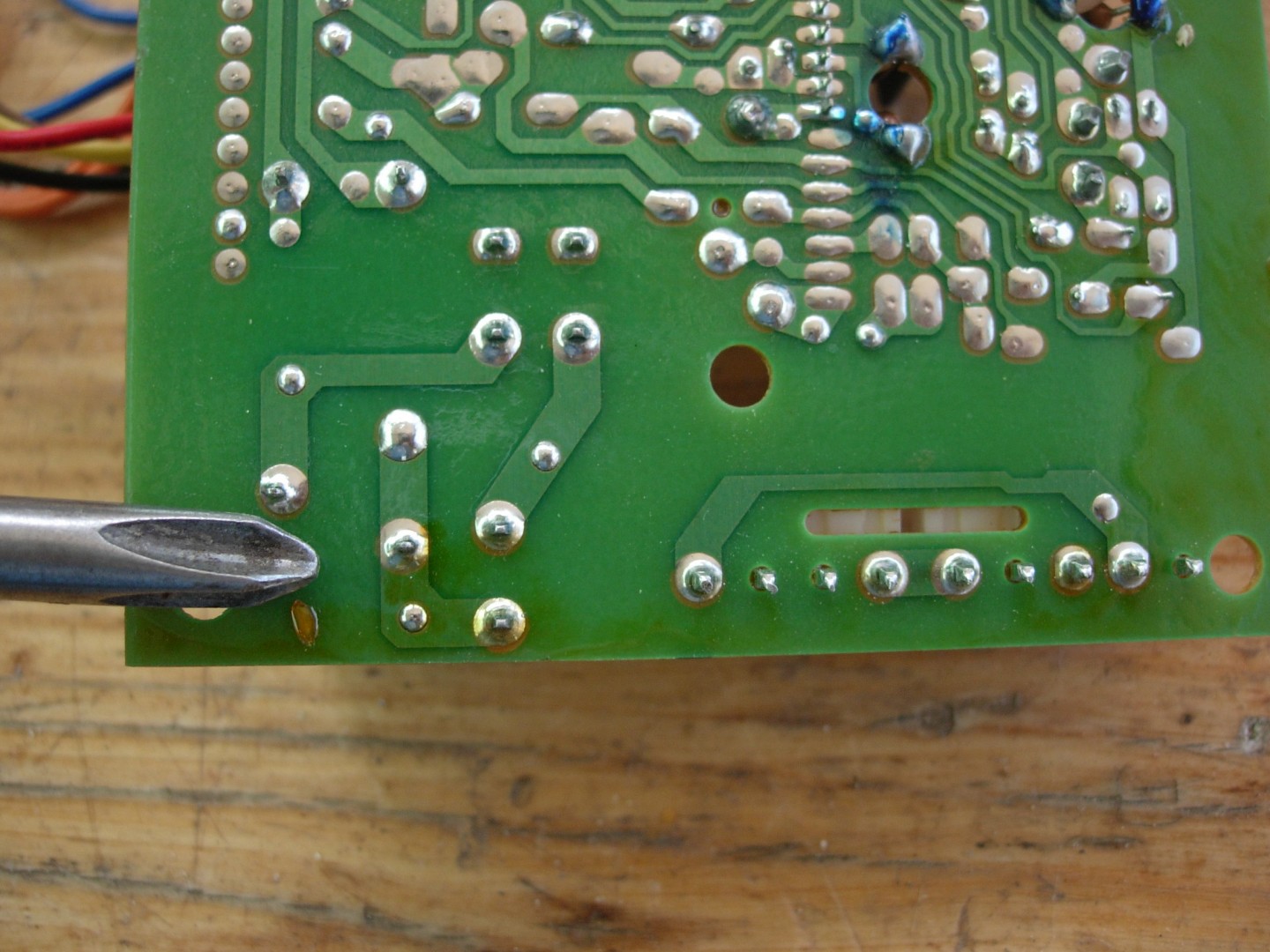

With those particular boards about the only check is dry (cracked) solder joins, mainly on the 2 switching transistors. The other main parts are Engel only specific parts not avalable any more. If you are realy keen on still using it, then buy a small 12dc/240v ac inverter & run of that.

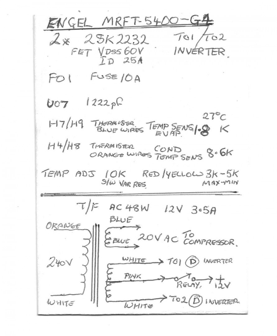

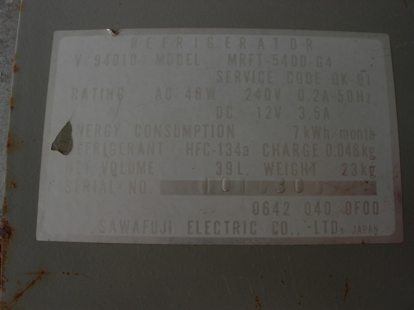

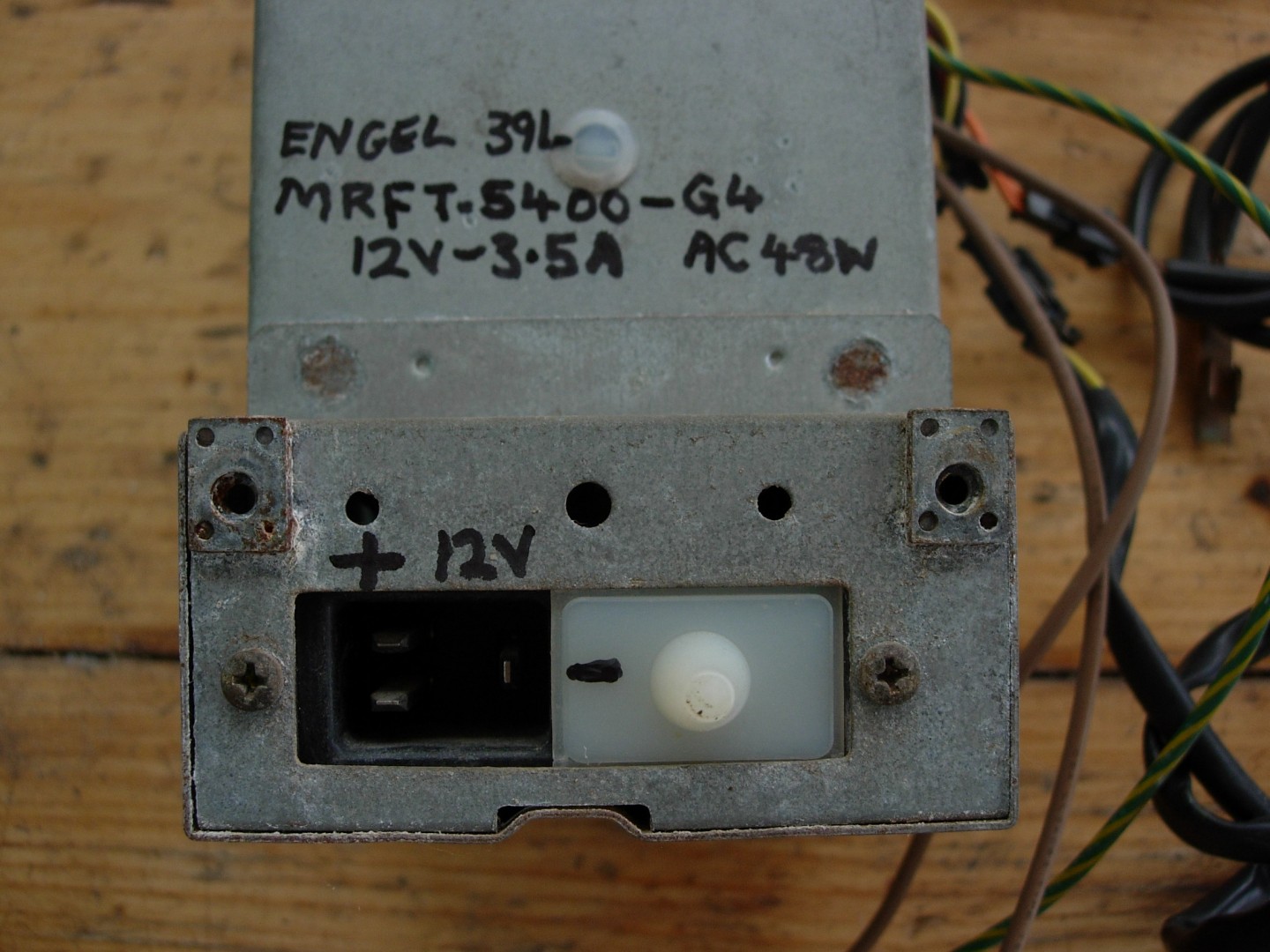

The following is just general info & pics of whats in a Engel MRFT-5400-G4.

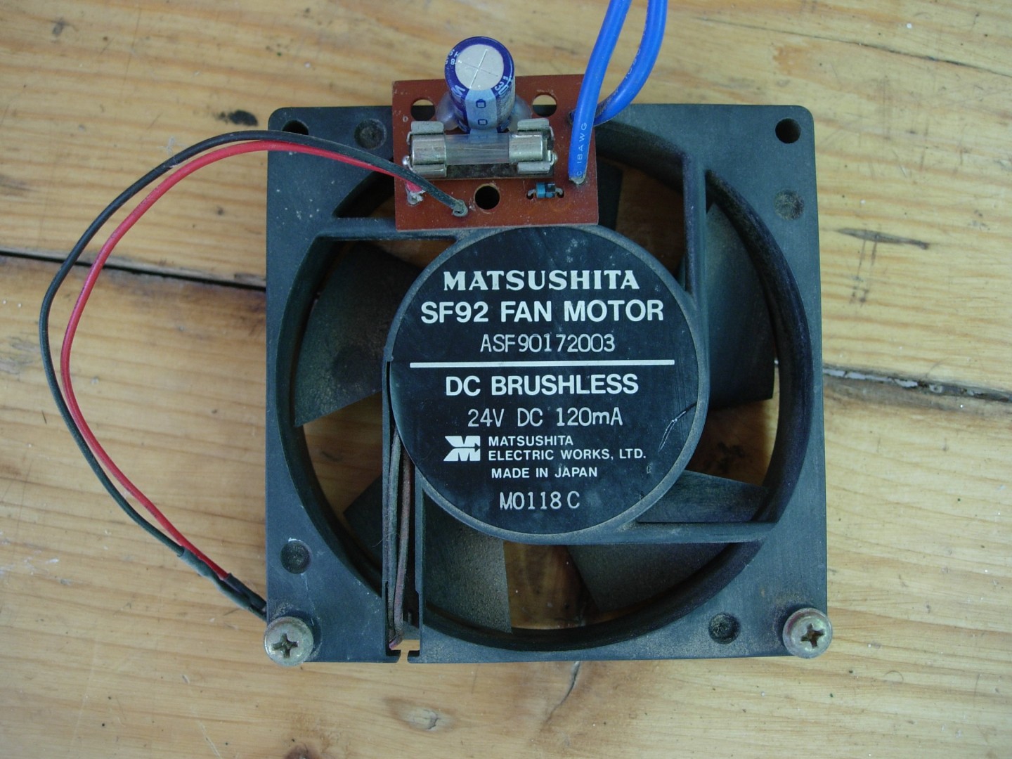

This is Condensor & Evaporator thermistors & Fan. Also some info on the fridge.

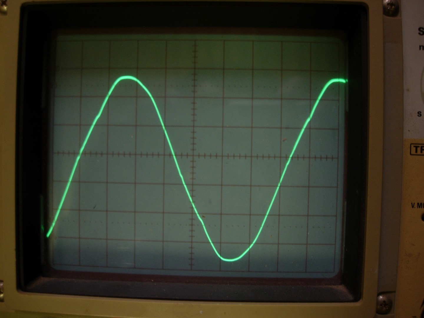

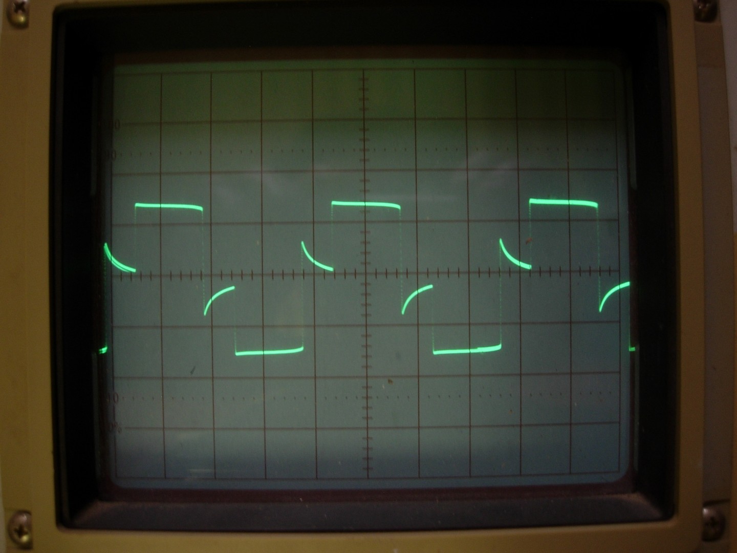

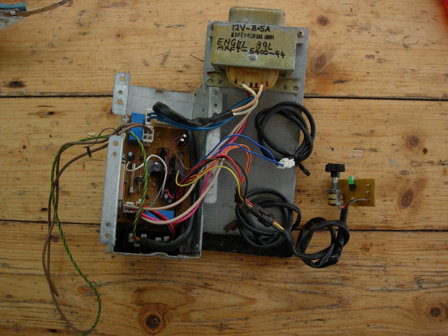

Wave forms on the Compressor the sine wave is 22Vac when run on 240Vac. The modified square wave is 22V peak when run on 12Vdc.
