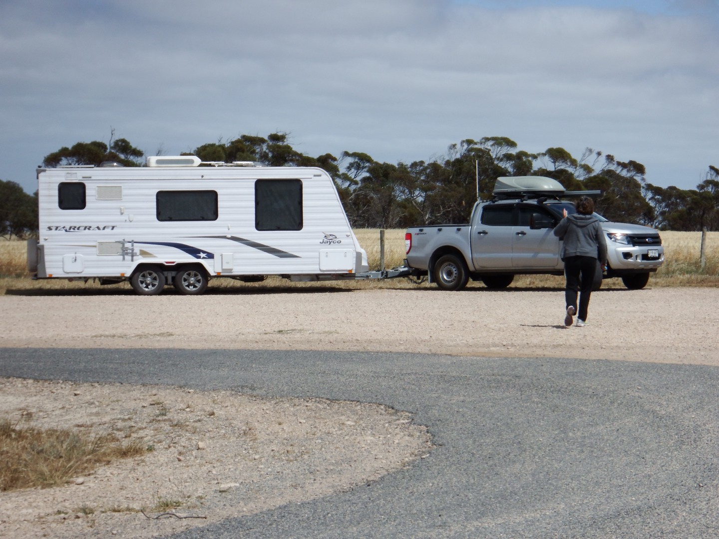

Does this look pretty level to the group? Kindly ignore the bride's back... Thanks
I measured my caravan chassis at the front and the back to get it level and then adjusted the hitch height so it was just below that.
When I hook the van on it sits with the front 20mm low and the ute is very close to level. Tows like a dream that way even going downhill which seems to be where a lot of rigs show some instability.

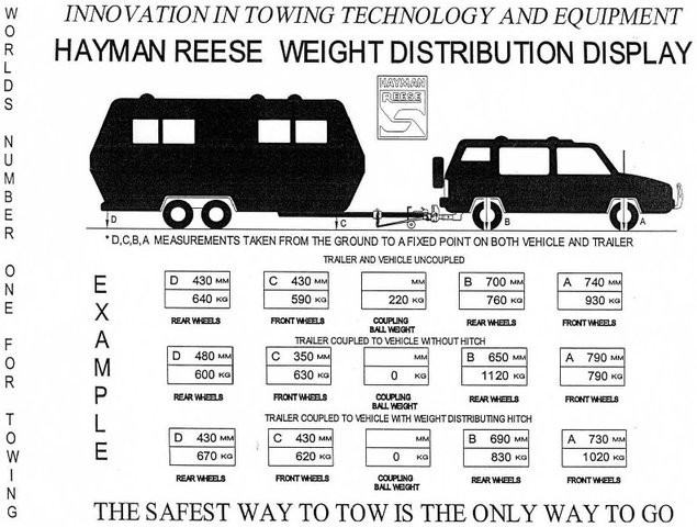

In addition I always suspect that people who call WDH do not have a full appreciation of what WDH is. I have again posted the results of a HR demonstration of how the bars distribute weight across both axles of a van. If you do a little maths on the results you will see how there is much more weight on the rear axle when you don't use WDH.
looks to be very well set up to me.
