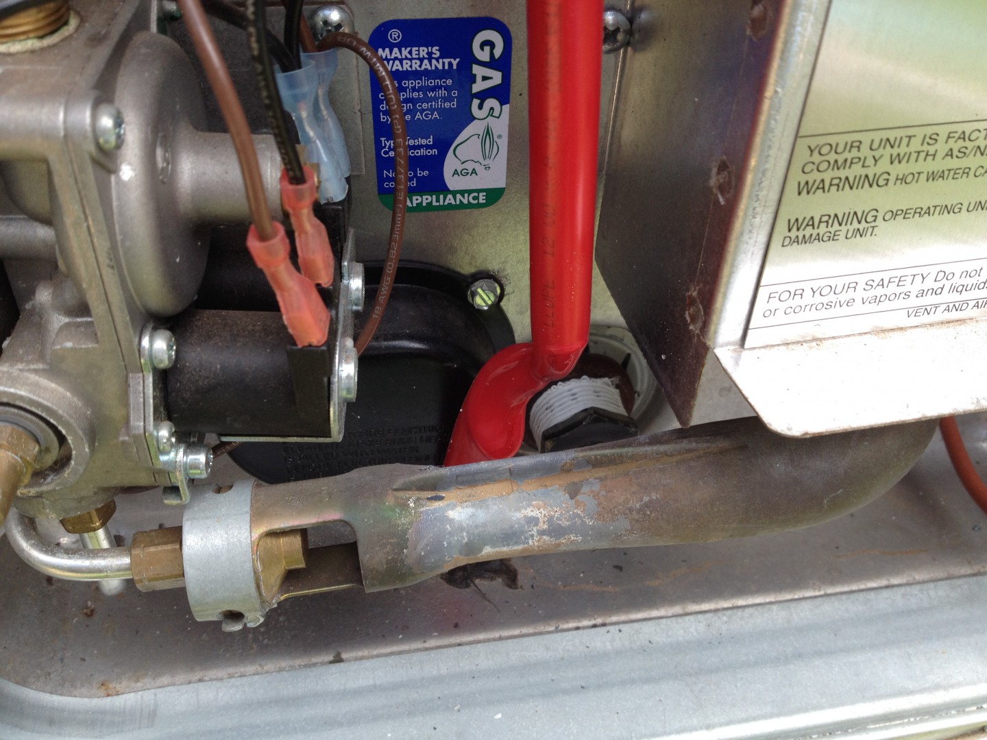

Hi all,
anyone had an issue with back burn in their water heater.
I have just discovered my red plastic overflow pipe has been melted near the gas flow manifold.
Just interested to here from any one that has had the same problem and can perhaps give me a few tips
Regards - Len

I have had a gander at my Suburban HWS and it looks like this -
Notice it is a brass pipe whereas your unit seems to have the red plastic pipe ... and obviously with the heat of the gas would definitely be in jeopardy.
I have also Googled for images of Suburban HWS's and they all seem to either have no pipe showing or a brass pipe.
Not sure how any of that helps you, other than to replace the plastic one with brass.
very helpful!
I notice your gas air pipe is not as burnt or heat affected as mine also.
I could still have a Back Burn issue.
Time to have a look inside for a blockage maybe.
Definitely going to change to copper.
Merry Xmas - Len

Also replaced plastic red pipe with Copper .
All fixed.
