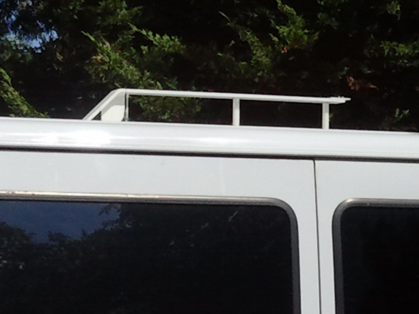

Hi Guys. I dont know if you can see it in this photo but I have some sort of attachment on top of my Sprinter (leftover from ambulance days). Thing is it will probably cost a lot to have it removed (bolted on, sealed where bolted and maybe fixed to a plate under roof too) It is only slim but takes up about 10cm of roofspace. Now as I have decided to have as much solar on my roof, as many advised, without this thing I could probably get two 150w panels, keeping it on I could have 1x 150w and 1 x 120w. Solar King website did one for 130w which would have fitted but cant get any response from them.
I think I am looking at 150w and 120w for the cheapest option. will this make much difference?
Cheers Di

Back to the original post. The object is a low profile radio antenna similar to this one, often referred to as a locomotive antenna. It looks to me like a VHF high band model to me.The frequency range is for thecommercial two way radio service so you may not be able to sell it on if you do remove it.
As you will be covering it you could simply take a hack-saw to it and reduce its height, you probably would not notice the small stubs sticking up too much with the panels on top. That could be less expensive. If you do end up with any small potential leaks simply caulk them up. That would allow you to mount the panels over it without having them excessively high above the roof.

Never would have guessed it being a radio antenna Peter! Is it any use for CB radios?
05:57 PM Dec 17, 2014
Wrong band Di. However they do make them to include the CB band, not that I am suggesting you get one. They are rather expensive and your solar panels would play hell with its performance.

Hi Did I , how high is the arial , why I ask is that if you mount the panel on 40 x 40 square tube plus the 40mm recess in the panel it might just fit without obstruction and no need to remove the arial , the panel should be mounted off the roof for ventilation anyway.
exa41 said
07:55 PM Dec 17, 2014
didi said
08:10 PM Dec 17, 2014
Hi Exa. Really too high to mount a panel on top. But can put a slim 120w panel down that side, and a 150w on the other. At least I will get 270w solar. I just wondered if it would make much difference or not as opposed to 150w solar? Cheers

Be aware that if you leave it there and it casts the slightest shadow over a panel, it will wreck the power output of that panel.

Just my 2 cents worth......That antenna that is mounted on your roof looks very much like a J pole antenna due to it's shape ( and a very heavy duty one at that ). Even the frequency of 166 Mhz is just out side of the 2 Mt amateur radio band.
On a nother note.....A lot of ambo's and fire service radio came on to the market a few years ago. All of these that landed in amateur radio operators and were re- programed ( soft-ware ) for the 146 Mhz amateur radio band.
Jaahn said

No it's not a J pole antenna. I would describe it as a quarter wave skeleton slot antenna. If it was a J pole the radiation would be horizontally polarised. Commercial 2 way radio requires vertical. Those loco antennas are cut for the top end of the VHF high band where the trunking services are located.
