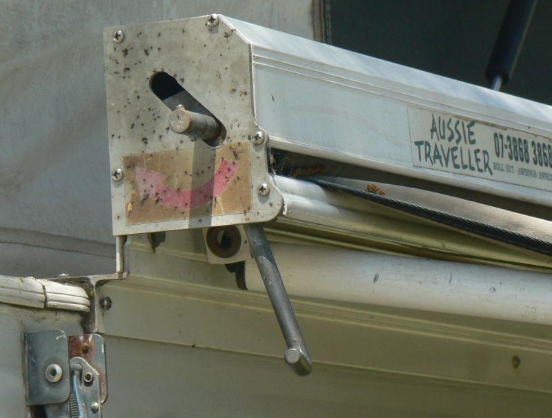

If you wish to mount the awning on the van body then consider the Aussie Traveller Coolibah. This is the one on my van plus the detail of how it fits to the top of the body.

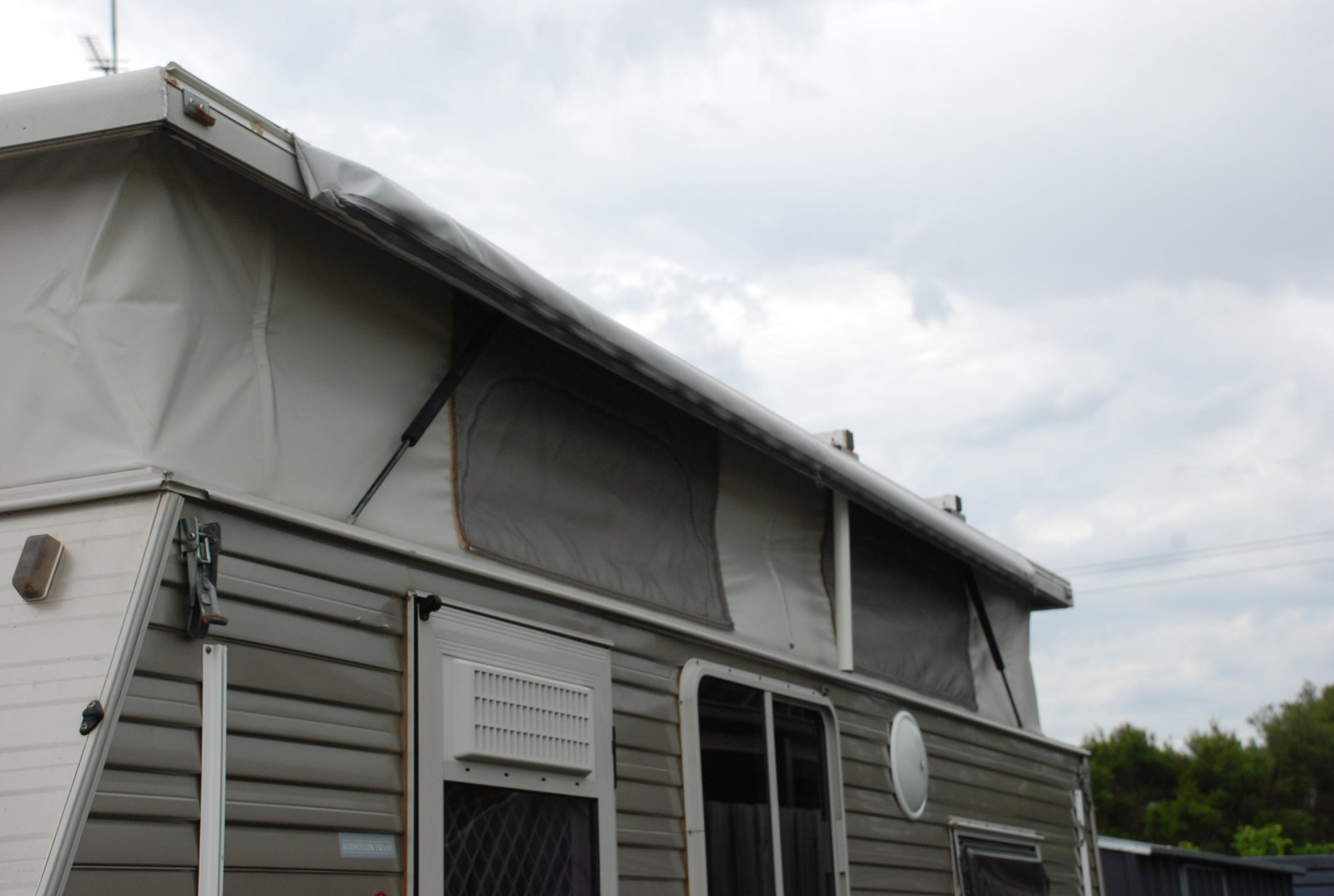

Our Coramal Pioneer Seka 505 XC had a Fiamma awning fitted to it when we bought it. It is fitted to the roof and works well. Only problem is that it is a manual set up that we have to roll out and in ourselves. No big deal. The extra weight of a hefty solar panel on the roof and the awning only means that we use a prop on each side to take the load off the gas struts. The awning is perfect for what we need, and, gives the added benefit of being able to leave the zipped air vents on that side open in the rain. I will add a photo later. Cheers, Brownie

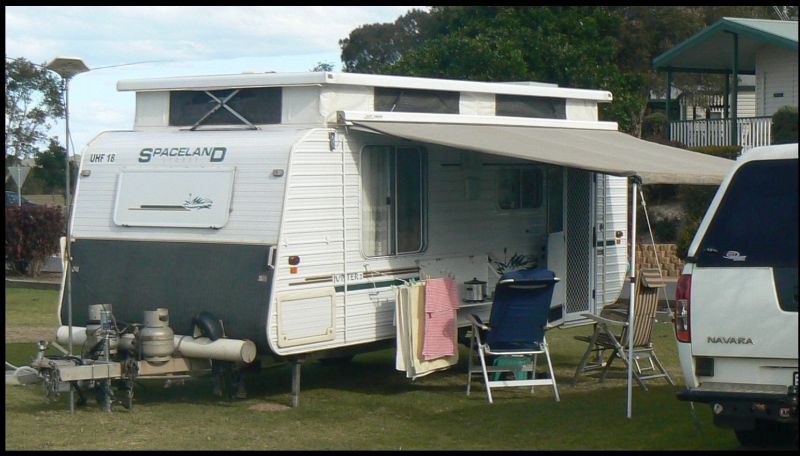

I have had two Carefree roll out awnings on my pop tops, both had a rail attached to the top of the pop up and the roll came away from the van so no probs, I do put the telescopic posts under the pop top to take the added strain off the roof when tensioning up the awning.
