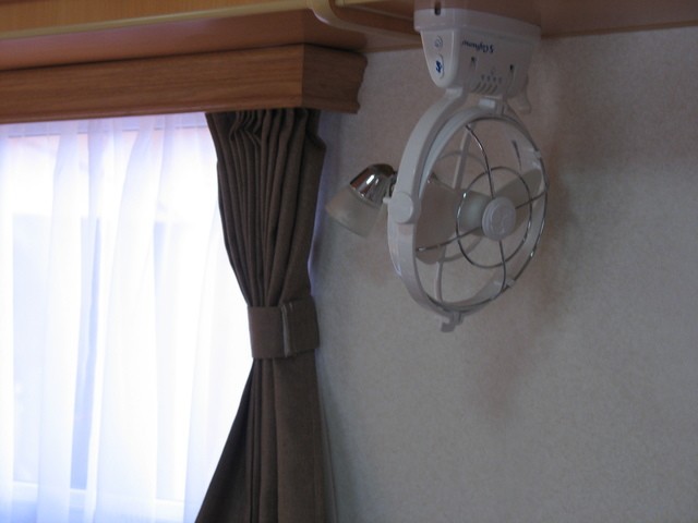

I have a "Caframo" 12v fan, has 3 speed settings and 4 different timer settings that are very handy indeedy. The fan uses very little power as it is actually made for boats but a lot of caravaners are using them now. You can fit a cig plug or hot wire into the van. I got mine on-line from "Whitworth Marine" in Elizabeth street, Melbourne. Around $139 at the mo on special, according to the dogalog. Took about a week to get to me. Easy peasy and a great fan.

We have a Sirroco Caframo 12v fan, purchased from a marine shop - it has a cigarette plug on it, which we plug into a 4 hole (plus usb port) unit, that has been wired directly to our house batteries, it is on the wall near where the batteries are. As it isn't being pulled in and out all the time, we have no problem with the plug. Uses minimal power as well.

I too have a Sirroco Caframo 12v fan in use ..

.. and here's also a fan site ..
https://www.whitworths.com.au/main_itemdetail.asp?cat=123&item=35794
