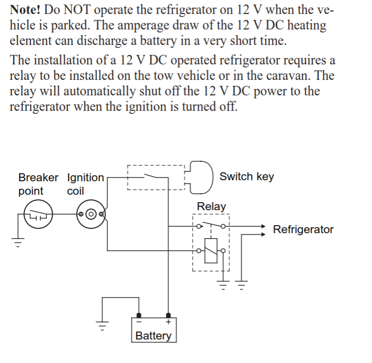

Ideally an absorption fridge should have its power supplied from the alternator and not storage batteries. The use of ignition switched relays and fridge switches is to get close to achieving that goal. The picture below is taken from the handbook of my fridge. The circuit diagram is diagrammatic but people smart enough to be competent enough to wire their own vehicle will be able to nut out their own way of doing things. On a previous thread one character of limited thinking ability argued against this idea, he thought he knew more than Dometic.
Whilst I advocate connecting your fridge hot wire to the starting battery so its connection is as close to the alternator I think it amount to very little gain for you to shift the connection now. You seem to know to use heavy cables and not the usual chain-store auto cable.
The modern absorption fridges have 12 V elements around the same size as their 240 V elements. With the time taken to initiate the correct temperatures in absorption fridges it is pointless attempting to do it on 12 V, you would have to run your tugs motor too long for its own health. However the size of the 12 V element ensures that the fridge temperature will be maintained whilst travelling - provided your wiring is sufficient size.
