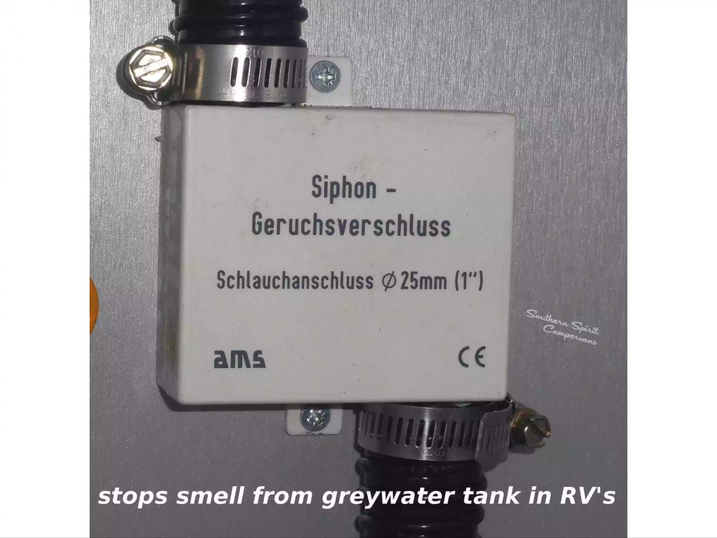

I had a "Grey Water" tank fitted to my new "Chief" and noticed after a few days there was a smell inside the van, no not me.
After a while I realised It was coming up through the sink holes so decided to add some Nappy San to the tank via the sink hole and put the plugs in the sink etc. Problem solved. I will just add more Nappy San as I go.
Not sure if all that is what should be done but seems to be working.
D and D said
02:25 PM Dec 5, 2014
Doug, we have stop valves fitted to all the points draining into the tank, they stop water back flows and the smells (still allow the foam from the washing machine through though )

I have one of these fitted to my motorhome which works great.. $30 of eBay..
Like Doug, if we are containing our grey water, as sometimes we must, the nappy soaker we use for our toilet, neutralises the smells from the grey water tank. I have also purchased some drain cleaner from one of the "cheapie" shops, which works a dream in the bathroom sink, that gets clogged with shaving cream and toothpaste.
