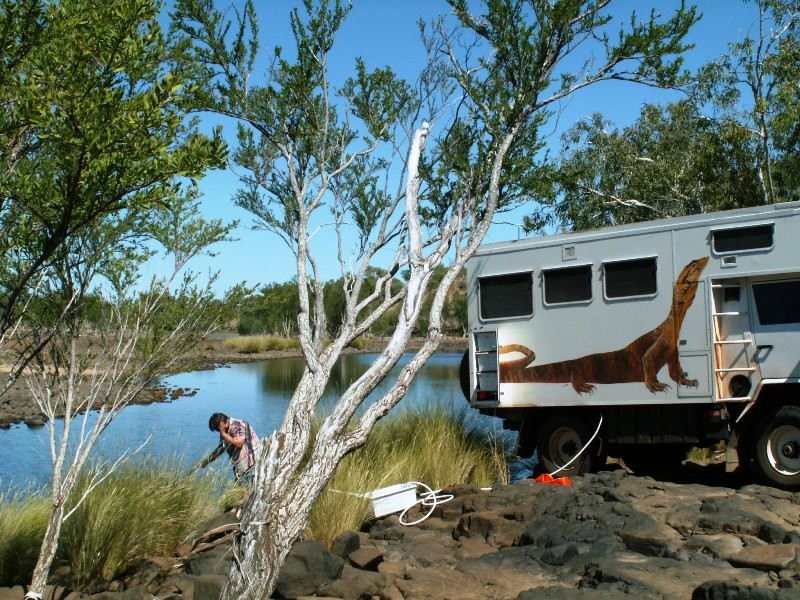

This is my first post and I would like to pick a few brains out there.
We are set up for independent camping (solar, batteries etc) and find that our only real limiting factor is water. I suspect that this would be the case for most others.
When you are not able to access water by conventional means, how do you lift water from creeks, rivers etc. I would like to hear ideas about methods used and how successful they are.
Our onboard tanks hold about 180 litres and we find with shower, washing up etc we can get a comfortable four days out of our onboard supply. We would like to be able to fill up from clean creeks, rivers etc. but physical limitations prevent too much lifting.
We carry separate drinking water in the tug so potable water is not the issue.
Would love to hear ideas from others.
Tones
robo24 said
05:50 PM Dec 2, 2014
A submersible pump together with a filter and obviously a generator.We carry 80lt clean water in 2 jerrycans.If needed we use a jiggler to empty into onboard tanks.A 150mm pvc pipe capped and tapped holds addition clean water.Many ways of carrying,roof rack,rear or front bar or under van .
copper1 said
06:12 PM Dec 2, 2014
Hi Tones, we brought a 150ltr bladder off evil bay and fill that if needed and transfer it via a hose from the back of the landcruiser if needed.

chris & terry said
06:22 PM Dec 2, 2014
Like you say water is your only real limiting factor. Thus I can't fathom how you can use-up 180 lts in 4 days. We average 15-20 ltrs a day (two of us) & if remote will stretch it out further. You may have a larger family than us which could explain it.
Ask about filling up with water before filling up with fuel. I have found, no water-no fuel. With fuel bills when traveling it's a large bargaining tool. Problems have only arisen in drought affected areas. Understandably.
We have never used creek or river water. Never needed to & not sure I would be inclined to.

Ozzie_Traveller said
08:03 PM Dec 2, 2014
G'day mate
we're a bit like Terry ... We have never used creek or river water. Never needed to & not sure I would be inclined to

Cloak said
08:13 PM Dec 2, 2014
We'll be carrying around 1000l of water in 4 tanks. One for drinking filled from a town source and the rest pulled from rivers / creeks for washing etc.
I've got a bunch of pumps, petrol and 12VDC.
Previously we found 200l far too small for extended stays after all princess Judie must shower every day and do a load of washing.... Or else we're not going.. If you follow.
The above little things are awesome they use little power and seem to perform better than specs.
Peter_n_Margaret said
08:19 PM Dec 2, 2014
We have separate tanks for washing and drinking water and we treat both with chlorine everytime we fill the tanks. Then we put our drinking water through a o.5uM active carbon filter just before the kitchen tap. We normally use about 30L per day (including a shower each) if we have plenty. Less if needed.
Each of the 2 separate water systems (washing and drinking) have separate pumps too. We carry a spare pump that is used to fill the tanks from rivers, or where ever. Caravan style electric pumps will self prime and deliver water quite some distance and head.

KFT said
10:05 PM Dec 2, 2014
Hi Tones
an age old question you ask.
We have a 100l bladder we got from flexitanks in victoria in addition to our 2 95 l tanks.
The bladder sits on the floor between the front and back seats in our Navara. We use it first and then fill it whenever we get to a source of water. Always filtered and if needing to be pumped from a creek or dam we use a 12v submersible bilge pump we got from BCF.
with some conservation we can both shower in 15 l of water.
We find the bladder very useful as it can be filled when we go to town for supplies and does not add to the weight of the van.

Cowboy7307 said
05:07 AM Dec 3, 2014
When we were on the farm we used to top up tanks from farm dam and it was not that clean ,we filtered it through about 3 house hold filters for your needs over kill, if taking from a river,
But the final filter was a .5micron absolute filter,have used a 1micron absolute filter, thy were more expensive,and not all retail out fits sell them or even want to get them for you , but thy do work and do fit into a standard 9"filter housing

Bruce and Bev said
05:14 PM Dec 4, 2014
lots of great ideas here.
You can buy inexpensive submersible pumps from camping shops, but I had one give up the ghost when I needed it the most, so it went into a roadside bin (with lots of downwards force and choice words).
I then bought a quality pump from an auto sparkie shop (comes with a 2 year warranty) and will pump about 2000lt per hour (never tried to pump that much, but it is almost lazy town supply pressure). Had it for a year now - no probs. Have an inline 5mc filter which is reversible (get your marker pen out and put and arrow on it. when flow slows down, reverse the filter the other way. And no, you don't flush out all the baddies by reversing the flow). Just make sure if you put an in-line filter in, you don't restrict the flow too much that you burn the pump out.
