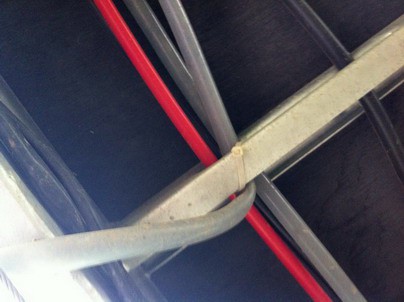

aussie_paul said
10:19 PM Dec 3, 2014
One tank seemed more difficult to fill so I emptied them both last night and while I was under the van noticed this!!!!!!!! A kinked breather hose.
Both our tanks are filled separately using one of the two outlets.Both tanks are joined by 12mm hose from 2nd outlet/inlet. Both tanks have separate inline taps.Both tanks are vented by 12mm hose.The new tank i am about to fit,i have fitted a 20mm ventas suggested previously.You tell me?

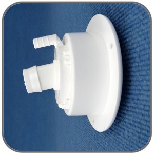

Spaceland use a filler like this one. You will note the spigot for the breather at the top. If you don't remove the filler cap then the breather is bocked, sealed or what ever other term you like.
Did you remove the cap before filling? If not then that explains the explosion.
