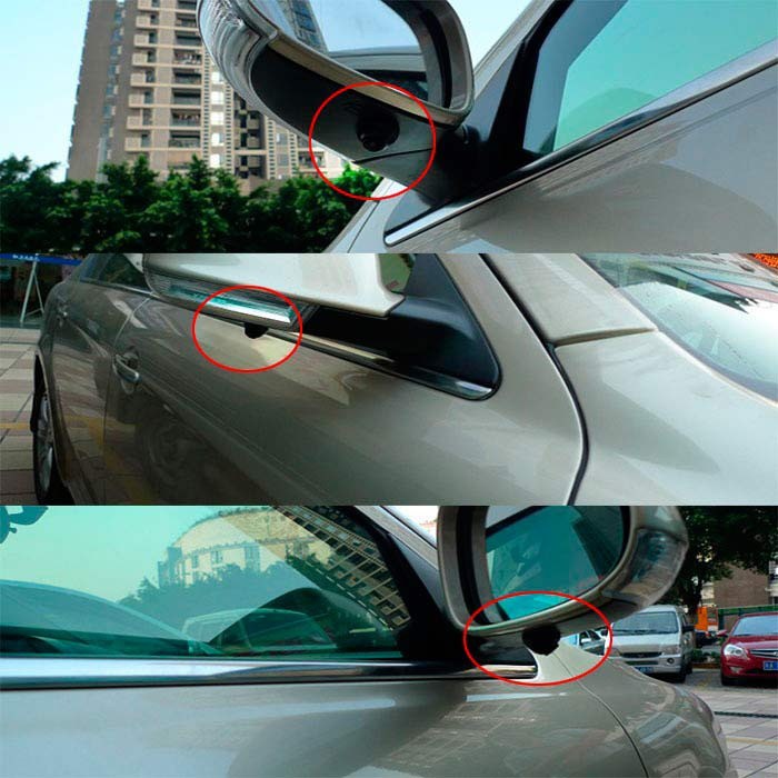

It funny how a stupid idea pops into your head and then you wonder, would it work? then how could I do it.
So the guts of my stupid idea is my Ranger has large mirrors enclosures, would there be enough room to fit a reversing camera or pinhole camera in there and drill a hole in the mirror for the camera to look through, as they are powered mirrors there would be access to run the cables from the mirror to power and connect up to a display in a suitable location.
The easy part is drilling the mirror the rest become complicated, an 170 degree camera would have too wide a view, perhaps a 60 degree with an offset mounting.
Hmmmm this has me thinking perhaps a trail with a camera mounted on the top or the side of the mirror with double sided tape to gauge the effectiveness.
Ok you tech savvy people could it work?

I remember a debate on this forum some months ago about rear view cameras, and I am sure someone mentioned on there that the use of cameras did not remove the requirement for a mirror that could see down the side of the towed trailer.
The camera in the mirror that you found is basically a parking assist camera, it works with a number of other cameras around the vehicle to give a composite view of the surrounds of the vehicle, they are often also used as part of a lane tracking tool, to enable an alarm if you wander out of the lane without indicating.

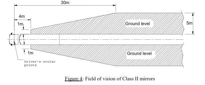

Yes. Mirrors are the only 'legal' compliant rear view medium. However, cameras may be used, and are probably recommended, to supplement the towing mirror.
This diagram gives an idea of the range of vision required - and it can only be provided by towing mirrors extended beyond the limit of fixed wing mirrors on the vehicle.
[edit: it may not be long before the fitting of two or more cameras to the rear of the caravan to give a view to the left, right and directly behind the van will be 'appended' to towing mirror rules.]

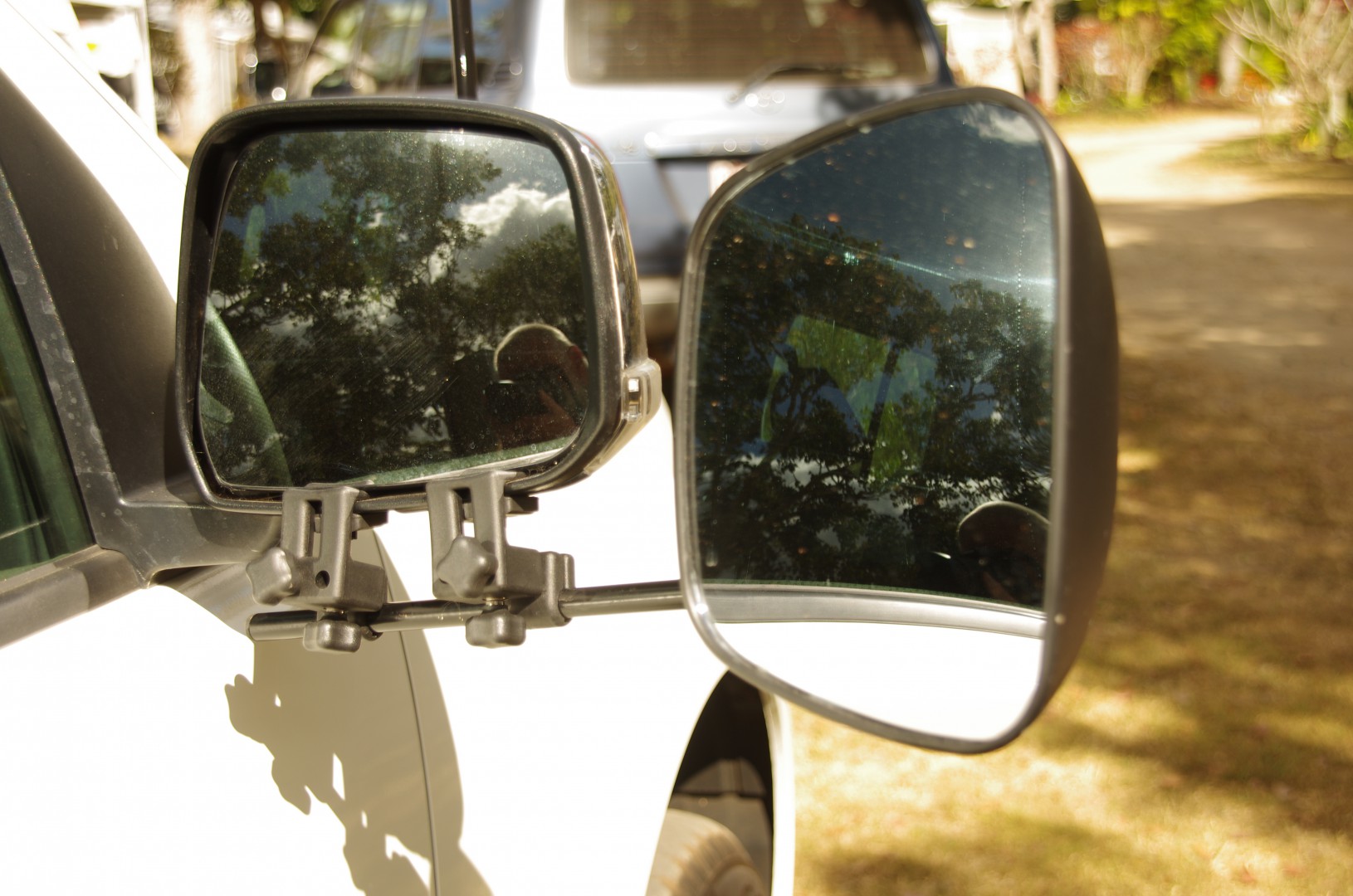

I use these Milenco Grand Aero mirrors and find them excellent.
I use these ORA Big Red - They are a very good mirror I have used for the past four years.

The pictures in the last couple of posts confirm my case a. they are butt ugly. b. you need to turn your head to see what occurring in the extended mirror, therefore your attention is diminished and c. there is an obstruction to the right forward quarter.
I rest my case your honour.

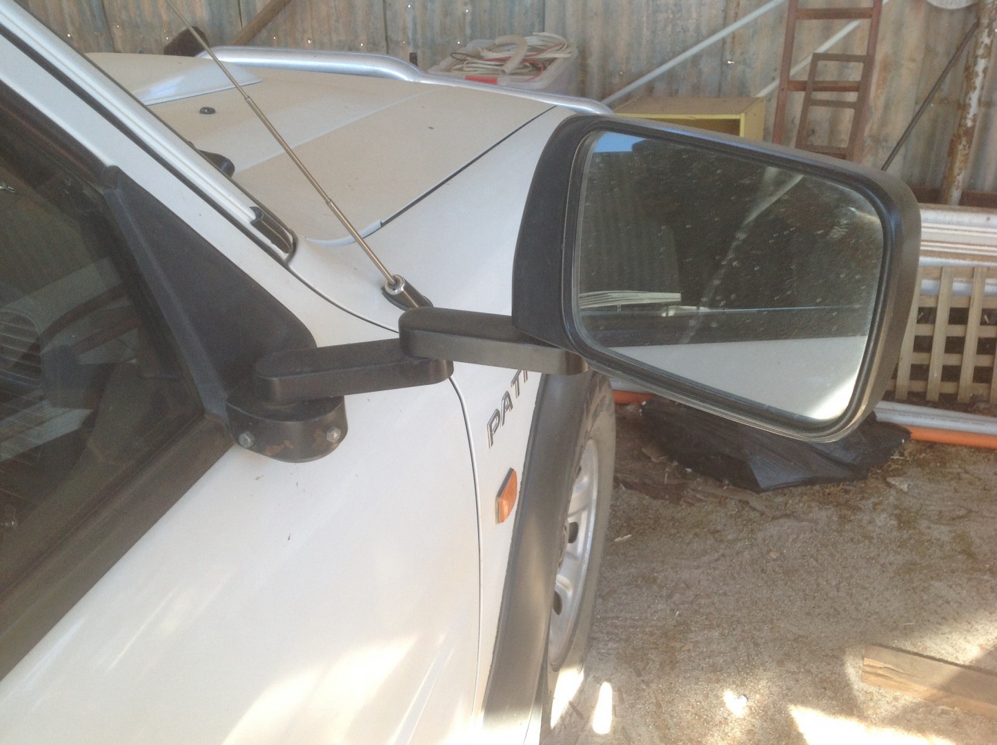

I think I found a good fit for my patrol I simply bought another pair of the original mirror mounts and bolted them on I did have to turn up on the lathe a half ball for the join thought, looks neat I can see down the side of the 5th wheeler they don't vibrate and I leave them on all the time I can push them in if I want and simply pull them out again when I hock up the van, doubt that anyone would give them a second glance, and only cost me $34.
Now That is a very neat and tidy solution.
well done

I doff my hat to you to you sir, a very well thought solution to an original problem.

rockylizard wrote:Yes. Mirrors are the only 'legal' compliant rear view medium. However, cameras may be used, and are probably recommended, to supplement the towing mirror.
ADR-14 allows the use of cameras providing they cover the same field of vision as required from mirrors.The diagram below for the required coverage is from that ADR.
ADR-14 incorporates the European standard for mirrors, that's the reason for a LHD vehicle being shown.
