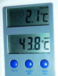

you've got the T version what means it is good to 47 Celcius
we going on the end of the month if everything go's right to Greens lake and it is always bloody hot there
and mine is only a N type, lucky we have a 70 ltr Evakool fridge/freezer

Ive got to say I never knew about this N ST and T stuff till I read a burst on this forum. Got me wondering and took a peek.. lucky we have the T model.
For the life of me I cant understand why dometic do these different temps models knowing they will be sold and used in Australia, traditionaly hot in summer (except Melbourne where it rains cats and dogs.) sorry victorians, had to slip in a Melbourne dig...

Good question... This is the specs of ours.
-- Edited by aussie_paul on Thursday 13th of November 2014 12:42:07 PM
I have a friend who works at Jayco and he tells me all their new vans will have the T version of the fridge, may be worth specifying this when ordering a new van... just a thought.
Safe travels
