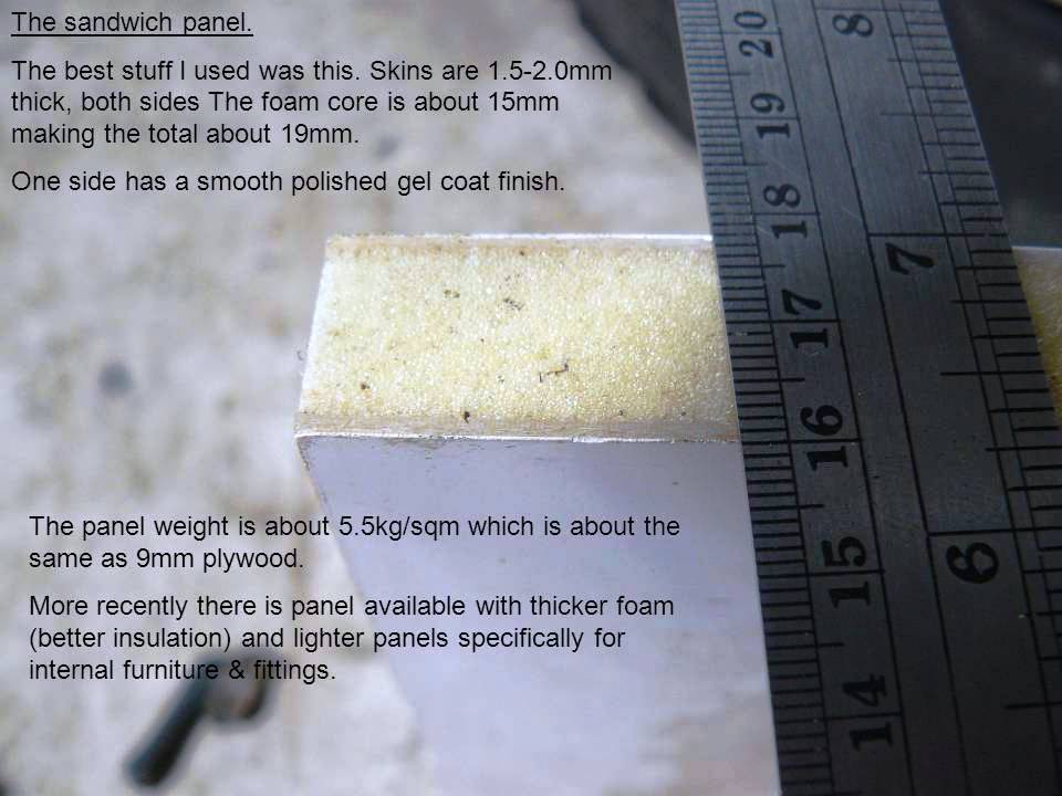

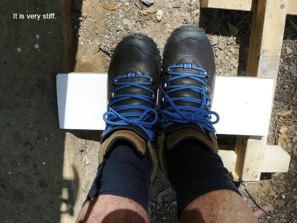

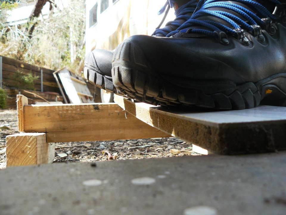

There are several Australian manufacturers of motorhomes and caravans who use fibre glass sandwich panel on closed cell rigid polyurethane foam. I built our OKA using this material 10 years ago. There are NO leaks.
This company makes sandwich panel for this purpose and supplies it to van an MH makers. http://vanglass.homestead.com/
There are NO leaks.
