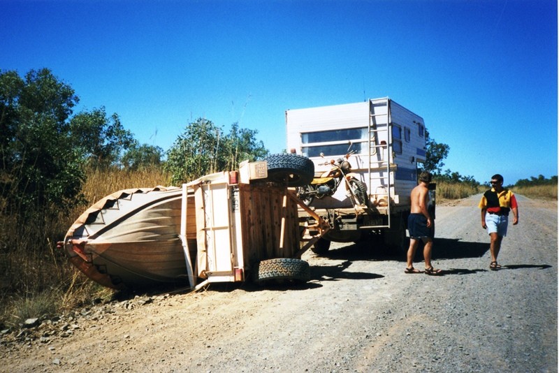

I rolled a trailer in the Kimberley in 1999.
The trailer wheel (with boat aboard) hit a 300mm diameter rock at 100kph and the trailer flipped in mid air and landed up side down on the road.
I did not loose control and the motorhome stayed upright.
The MH weighed about 3 times the weight of the trailer.
I suggest that in most caravan rollovers, the caravan is "in charge" when things go pear shaped. The driver has no control.
I have pics if you need proof.......

Crikey, 100 kph in a motor home towing a trailer on a dirt road!
Yep, pretty stupid and I paid the price.
But the point of the post was that the trailer did not overwhelm the tug and no one was hurt as a result.
If it had been a 3 ton caravan, things might have turned out very differently, even at much lower speed.
I wouldn't say stupid Peter, an error of judgment, we all do it from time to time.
All round bad luck mate.
Unfortunately very few of us are perfect and we sometimes make bad choices, hindsight is easy after the event. Thank for the pic. Adds some reality to the episode..
Good on you for posting and admitting you made a fopar..

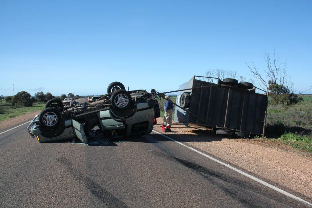

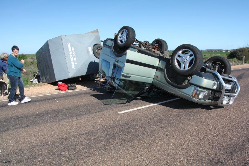

The trailer flipped my car in this instance and nothing I could do about it...flat trailer tyre, strong winds, travelling at 80kmh.. the marks on the road show how hard I tried to keep a straight line..accelerated gently..no violent braking....we toppled over as if in slow motion...I'm still hanging upside in it when the photo was taken......first accident towing in 49 years driving,.I now tow with the greatest respect for the trailer or caravan being towed.....imagine if I had not been in a later model Disco2....Hoo Roo
Gee, one blown tyre out of four, a bit unlucky.
No matter what technology is used if the trailer want to go it will go...
Have a Watch of 2 and 3....
Juergen...
Psst also remember the 1, 2, 3 rule.. Left right Over.... or right left over it does not matter..
I beg to differ you DID LOOSE CONTROL of the trailer,,,, that's the OP subject van rollovers was it not, but appreciate your honesty Peter and the photo.
