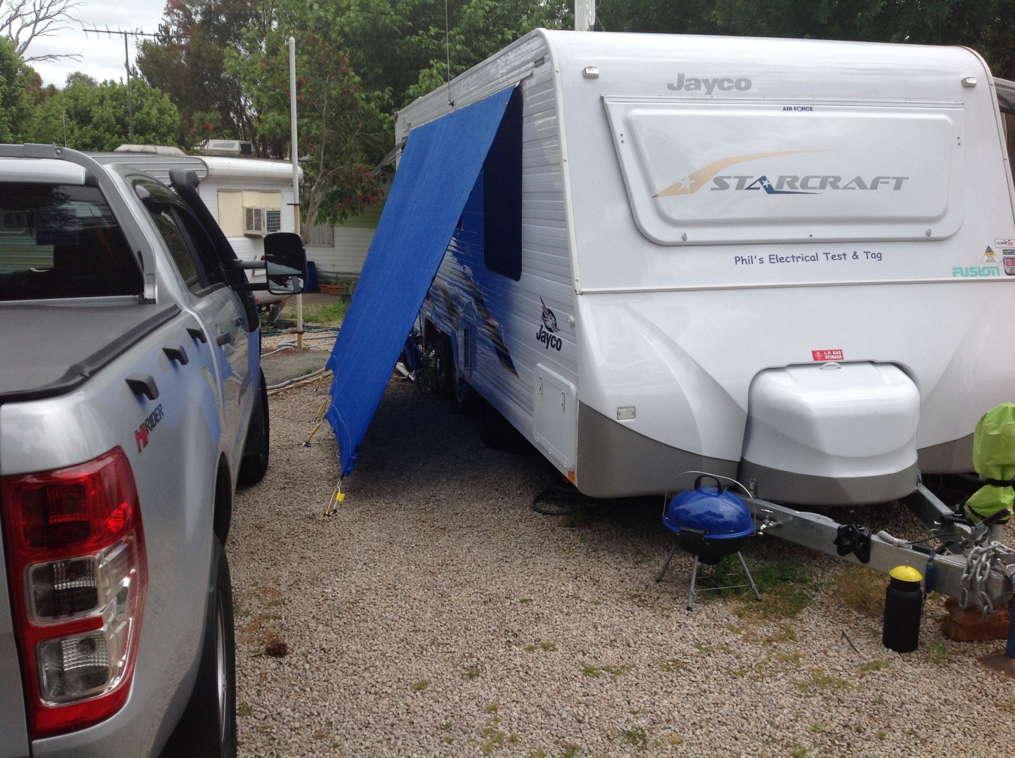

Phil C said
08:50 AM Nov 6, 2014
Hi Simpsons
We did this... but im told I have a "T" for tropical fridge if yours is a "ST" then you may have issues, good luck.
Its 90% (I think) shade cloth on a sail track. Keeps everything cool and creates a privacy screen.
-- Edited by Phil C on Thursday 6th of November 2014 08:56:18 AM

We have also set up a shade cloth almost identical to the one Phil has . It does help.

Phil C said
09:41 PM Nov 6, 2014
gitsho wrote:
Hi, just wondering what sort of side screen and where you purchased it, thanks, Gitsho
-- Edited by gitsho on Thursday 6th of November 2014 03:39:41 PM
I actually got the shade cloth and 2 x 2 meter sail track and tape from ebay, some mob in Victoria.
From memory it cost about $200 all up, got a friend to sew it all together and bingo, sweet as.
