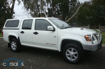

Mike196 said
11:07 PM Nov 7, 2014
G'day Russ,
The RC Colorado is a pretty honest vehicle and for the power it has it tows 2.4Tonne quite well. Mine is identical to your pic apart from colour. I was getting around the 15-151/2L/100 std. A 3" exhaust and free wheel hubs got me into the 14L/100 territory, and with gas over diesel it's now down in the mid 12's with 2.5L/100 of gas, with more pulling power. The Izusu engine is rated at a 9/10 which means under 10% of the engines will experience a major problem in the first 100,000 Km. These engines are expected to do in the region of 800,000Km before a rebuild is required.
