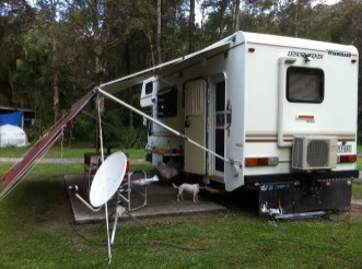

This was our split system , mounted up off tow bar , had a cover to go over it when not in use , head unit inside cupboards at back. Wasn't reverse cycle only cold. Worked well when we used it. We didn't fit it but I believe it was done by an electrician.Fujitsu 1.5
I'm fitting a small Fujitsu at present onto my camper. The main thing is to ensure the internal piping doesn't crack from vibrations so you have to have a brace made up to stop the compressor from moving about too much. That means using the right kind of heat resistant material - like modern automotive hosing material. I've seen some mention of placing the main unit on springs - I'm probably only going with some rubber to cushion it though. If anyone has any info about suppliers/installers in Cairns it would be great to know btw.

Ho Hoboe, if it is any help, ours is mounted on a plate welded to the back bumper, it has rubber washers under its feet, but they are heavily compressed and they would not offer much vibration insulation.
The pluming is fitted with a good large radius curve, and both pipes are tied together.
There are stabiliser ties fitted between the top of the unit and the van body on both sides.
When you are in the van with the unit running, you can not hear it, but if you concentrate you can sort of feel it.
