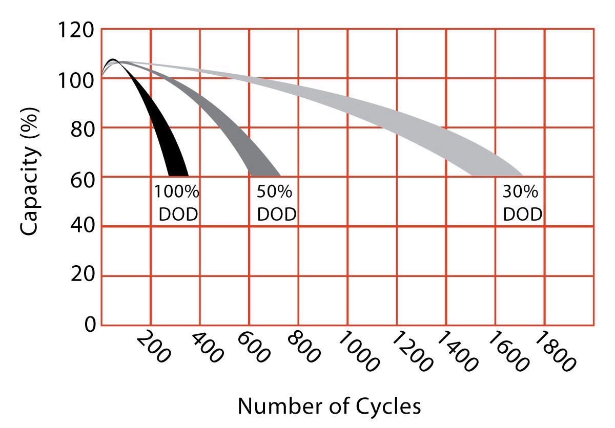

Phil C said
05:16 PM Oct 30, 2014
This graph should put some REAL perspective on this. Not just fluff from the top of our heads.
-- Edited by Phil C on Thursday 30th of October 2014 05:17:29 PM

Plendo said
08:22 PM Oct 30, 2014
Phil, what type of battery is your Cycle life V DOD graph for?
